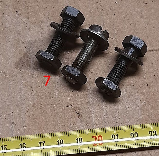

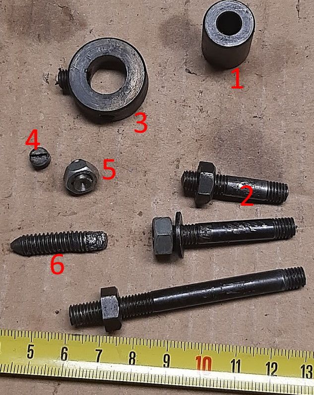

                          It is definitely a ML7, from 1950. And I identified almost all loose parts in the loose bags.
                          Ignoreing some generic bolds, nuts, washers, these are specific parts I have left (see photos)
                          Maybe someone recognizes them? On the next posts some more detail on the specific items in these photo's

                            I cannot find collar 1 on any exploded view
                            I mean, it could be A51 in the geartrain, but that is not disassembled and appears complete.
                            So where other then in the geartrain would a part like this be?
                            It is 1/4 inch inner diameter, 1/2 outer, and 7/8 high
                            The 3 studs number 2 are 1/4 diam and 1+1/4; 1+5/8; 2+7/8 long
                            On one of them someone jammed an incorrect M6 nut
                            I don't know where they are supposed to go.
                            #572955
                            Maurits van Dueren
                              @mauritsvandueren59568
                              The trust-collar 3 has not one, but two places for a set-screw, at a 90 degree angle
                              I think it may be F34 in the motor assembly, but I am not quite sure how it goes together with F36 and F18
                              Is F18 the short stubby 1/4×1/4 flat point set screw labeled 4 in the picture?
                              And even this collar is F34, what is its function? In that position, it is not a trust collar.
                              I do not know where 5 goes
                              Special about it is it looks like a set screw, but is cupped instead of pointy
                              6 is is a shewed up, coarse thread pointy stud (or broken bold) bold.
                              I was thinking it could be for the main motor pulley, but that is a 3/8 screw
                              It could also be for the triple pulley on the same axel. But being shewed up, I do not want to force it in there.
                              7 are 3 generic screws, 3/8 x 1+3/4. One seems non-original.
                              But I was hoping the half-height nuts would trigger someones memory.

                                Collar 1 looks like F35 Tie Bar Spacer
                                The longest stud looks like F37 – don't know about the other two, will become clear during assembly, I guess..
                                F34 fits on the Eccentric Shaft F47, where it is secured with the screw – the other hole accepts a threaded pin F36 which acts as a positive stop for the Swing Head Assembly.
                                5 looks like a threaded oil nipple, I don't know where it goes, sorry.

                                Are two of the screws F39?

                                    1 F35 Tie bar spacer is correct (actually, I had found that I needed it there yesterday) The tie bar itself is non-original but it fits.
                                    2 F37 also seems correct on the exploded view. But in reality I do not know where it goes. There is no place. No threaded hole. What is it supposed to do? It's just a set of parts floating in the middle of the exploded view.
                                    I am vaguely thinking it is needed to hold up the shroud, and thus probably also the other 2. But I am not looking too closely at the shrouds at this moment.
                                    7 Both F39 are already in there.
                                    5 is definitely not an oil nipple. Not hollow. Just a 3/8 long set screw with a weird concave point.
                                    3 You are probably right about F34/F36 (I did find part F36 also) but it is still not quite clear to me what it does. The whole belt tensioner works quite well already. Maybe it will become clearer when I do final assembly. I think I am about ready for that anyway
                                    Or at least, that part of the lathe. Still missing both top and cross lead screws/nuts/dials/handles. That is a bit of a bummer, because not cheap, and rather essential.
                                    I guess I will just start to actually assembly anyway. I think I know enough now to not completely mess it up. At least get the chuck spinning and the saddle moving.
