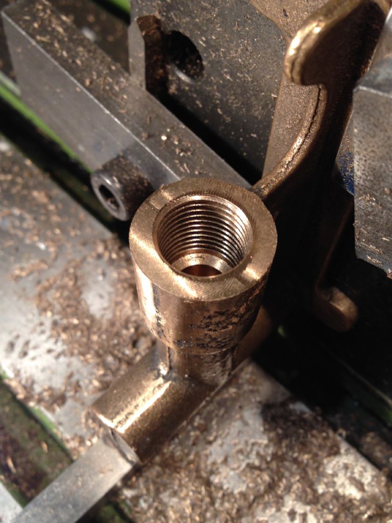

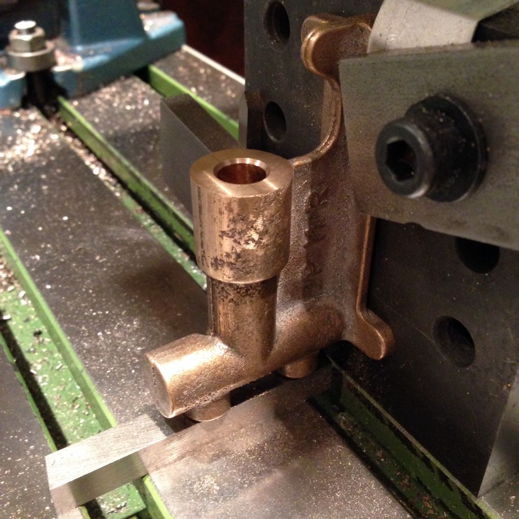

      Hello all,
      In the process of making a water pump ( side tracked from building the minnie ) need to drill a 33/64 hole into the existing one shown in the picture below but really worried about the drill snatching, can anyone offer any advice to reduce the risk.
      Thanks.

              Brian – Have you ground flats on the cutting lips of the drill, parallel to the drill axis? (to remove the helix lead angle in the lips)
              Look up "grinding drills for brass" on Google if you are not sure what I mean.
              This will reduce or eliminate snatching during drilling in brasses and bronze (except in thin sheets) . Drop of good cutting oil doesn't hurt either.
              In thin sheets, a stepped "Christmas tree" type drill works well.
              Good luck, JD

                  This appears to be already set-up on a mill …
                  My preference would be to use a milling cutter, or a single point boring tool: either of these would be lower risk than using a drill.

                    I would not go anywhere near the grinder to modify a drill for brass or bronze. All you need to do is generate a flat parallel to the axis of the drill on each cutting lip/flute of the drill with a small emery stone. You only need a few thou to give you zero rake and eliminate any grabbing. I suspect that's what Jeff meant when he said 'grind'.

                                              Thanks all for taking the time to reply, not sure which way to jump but will post a picture of the results. crying

                                                    Not sure if it was the flats on the drill or just lady luck on my side but it drilled & tapped ok.
                                                    Thanks again
