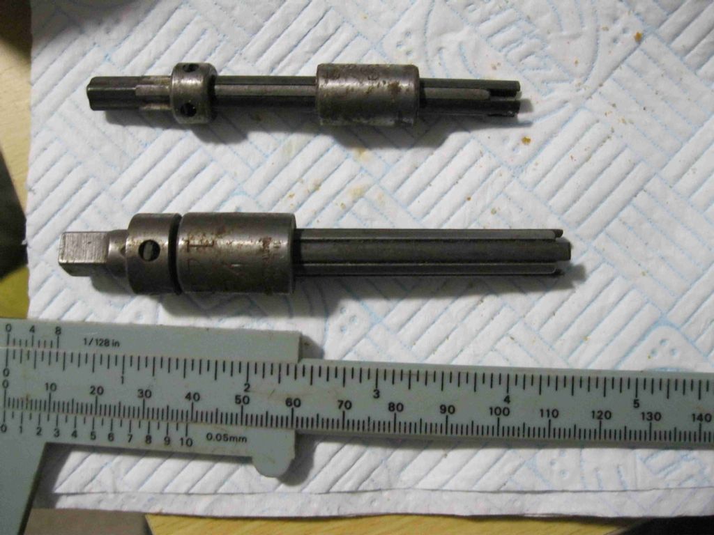

                                                      Having just broken an 8mm tap (best quality Chinese black chocolate!), this thread offered various 'escape' options. However, from the dim recesses of my remaining brain cell, I recalled a couple of oddments from 40 or so years back – see pic below.
                                                      The smaller of the two was adjusted to fit and … Bingo! . It unscrewed easy-peasy!
                                                      I cannot recall having seen these mentioned previously nor seen them advertised. Anyone else own or use one?
