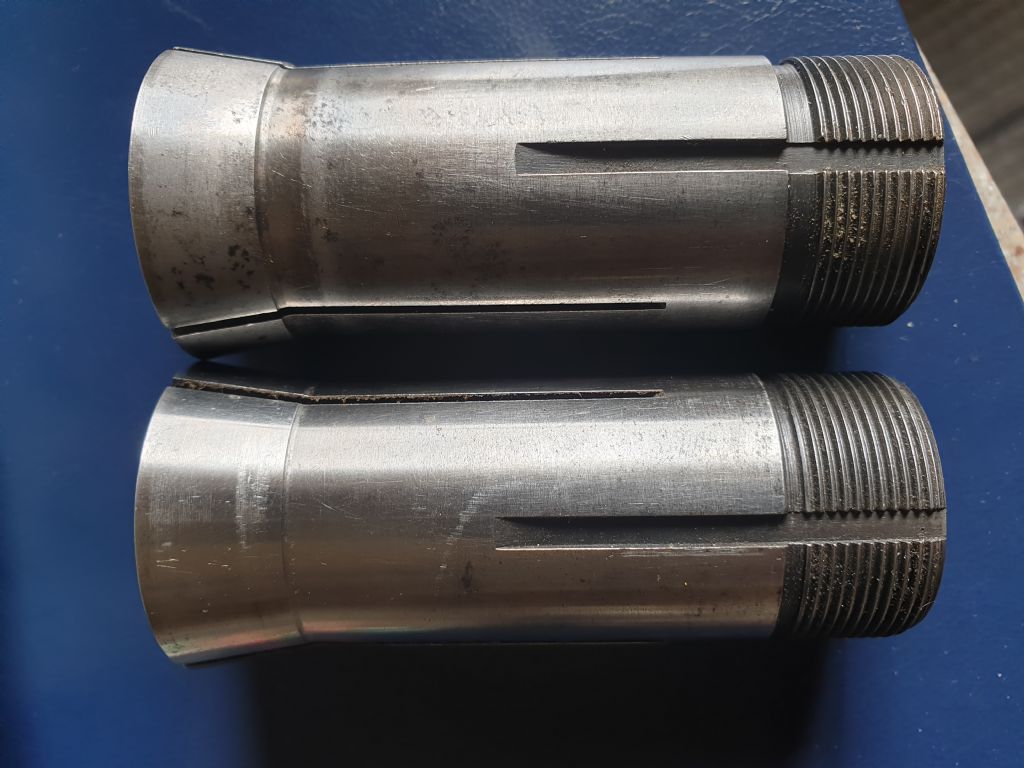

      Hi all
      I have a little problem….

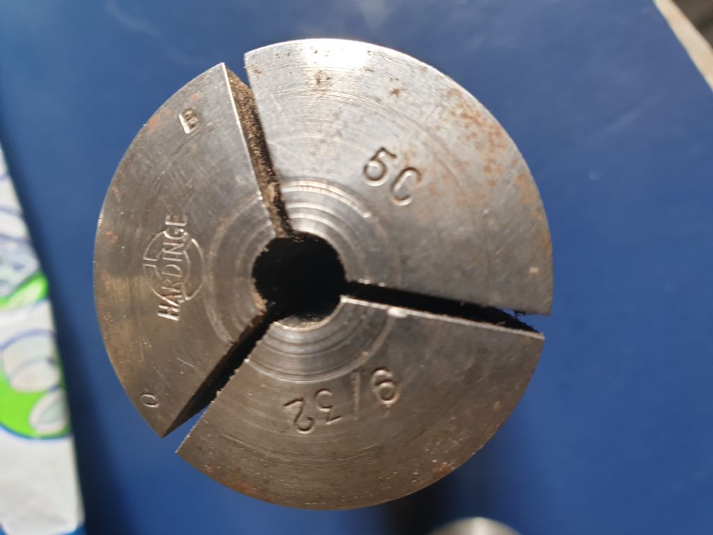

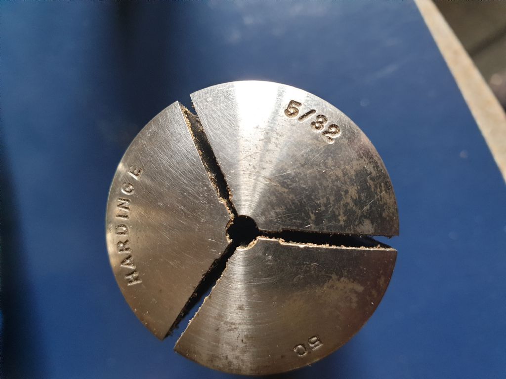

      A while ago I purchased a 5c collet holder from Arc and don't get me wrong there is nothing wrong with it. all of my collets fit from all different makes and sources etc except these-
      which as you can see are a good make. but these-
      which are made by hardinge but stamped differently DO FIT.
      the problem being, just after the threaded portion at the bottom, the ones that don't fit are 0.02mm bigger which is stopping the thread from engaging.
      hope iv'e explained that ok.
      So I need to take off 0.02 or there abouts off the bottom of these colletts.
      how would you go about it. I've about a 15 imperial ones that need doing
      thanks for any ideas/ advice
      regards
      Paul

                I don't know Jason but Hardinge are almost the last word in quality for collets. 0.02mm is less than a thou. Probably the collets are in spec but the draw tube is at the lower end of the diameter tolerance.

                  Just to add, i've measured some more collets with a mitutoyo digital calipers and got these results-
                  arc brand new collet 1.2485" fits
                  unknown brand old imperial collet 1.2485" fits
                  taiwan imp collet 1.2480" fits
                  all the hardinge collets that don't fit 1.2490" with the exception of 1 which measures 1.2480" and it fits
                  the few hardinge collets in picture 2 that do fit all measure 1.2480"
                  I have also noticed that my collet stop will not fit any of the hardinge collets, but will fit all the others so i'm assuming the internal thread is slightly different?
                  regards
                  Paul

                    The quoted Hardinge back-bearing diameter is 1.250" so it seems your draw tube is tight.

                              The top collet looks to have some damage on the start of the thread near the key slot. The threads are not hard and can be easily cleaned up with a thread file or a small triangular file. Clean up the treads and try again. I have never seen a Hardinge collet not work correctly but have seen them with damaged threads before. Also check the thread condition of the draw bar as well.

                                I am Barry, I started my apprenticeship at Hardinge Machine Tools, Exeter in 1966, ending in 1971. There was a factory in Hanworth Road, Feltham, Middx, but that closed a couple of years after I started. The head company base was Hardinge Brothers in Elmira, New York, USA. I continued to work as a Hardinge fitter building HLV-H centre lathes, a few HC turret lathes, but mainly the DV/DSM 59 range of centre and capstan lathes, as well as all accessories. Finally, I worked in the Drawing/Design Office and left in early 1979 to become a SkillCentre Bench Engineering Instructor. Before I left, I worked on redesigning the American KL pedestal unit to fit the English HLV-H to become "our" KL and updated HC models.
                                Your pictures show very different designs of 5C collet (known in English factories as a PH92 collet), going by the face engraving/stamping. The top one (5/32&quot looks correct but the lower one, 9/32" was not made in UK, in my opinion. It may be an American one, the circular collet design with Hardinge stamped through it is not an English factory 'thing'. It has added stampings "O" and "B" – I'm not familiar with this, it could have been made as elsewhere as a copy (Hardinge lathes were copied by a few foreign companies, including a Taiwan company called Feeler but their parts would not fit the genuine factory built machine). The spindle back bearing diameter is nominally 1.2500" with an exceptionally tight tolerance of +0.0001" if I remember correctly. Collet back bearing (you describe as just before the thread), I believe, has a diameter of 1.2498" tolerance of only -0.0003". The body length measures from the 10 degree head angle. Bore diameter max runout is 0.001" at a point 1" from the front face. The spindle collet key entering the back bearing is locked in place with a short, #10-32 UNF, grub screw, and is set for depth of engagement against a special gauge.
