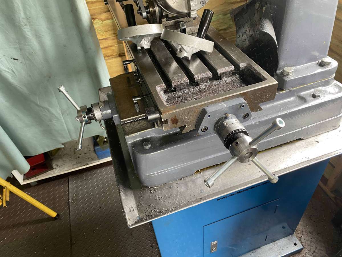

      The original black plastic handwheels with folding handle always annoyed me. So spent some quality time with many cups of tea yesterday. Had some lumps of 50mm dia MS, turned drilled faced and bored, then into dividing head to cut the three triangular bits to engage feedscrews, also drill for three 10mm dia 100 long socket headed screws and a 8mm grub screw and here is the result.
      Much better feel and control now.low both

            Hi Ian and Robin
            The folding bit always felt weird, sort of hard to keep smooth feed, like push down then across the bottom, up the other side and back across the top, now I can feed super smooth with two hands,,,,maybe Im just imagining it but it feels good for me.
            Also under no load I can spin them with one finger.
            And they filled in a day in the shed!!!!

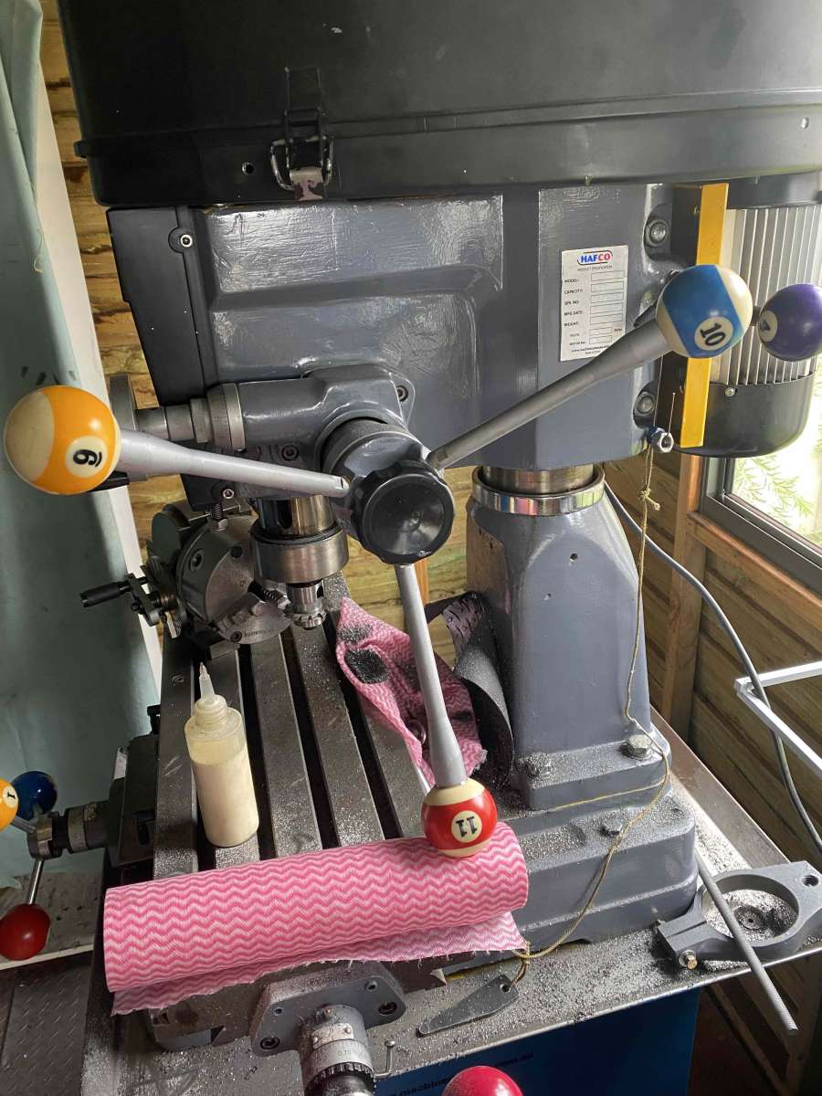

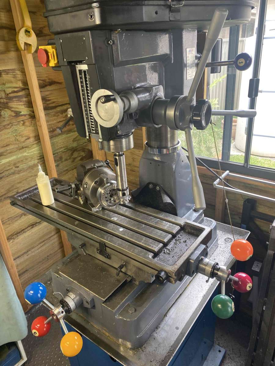

                        Back again, been doing some work and I have to say the “socket heads” didnt feel quite right, so I looked for some knobs. Local internet “for sale” didn’t turn up any knobs BUT they had a set of “8 Balls”… That brought back memories of my old MGB gear stick knob so I thought ‘why not”. Hacksawed off the sockets, whacked the balls in the lathe drilled a 10mm dia hole, mixed some Araldite and voilia!!! See photo where I have just finished the first set of cuts for a 40 tooth 1.5 mod parrallel depth bevel gear.
                        The “feel” is great, not unlike the traditional 3 ball (straight) handles I have been using since I was a young apprentice, nice and smooth feeding. Also I think they are “flash as a rat with a gold tooth”
                        Fellas,,,,never had a machine with round handwheels before, they felt wrong, maybe that was part of the problem.
                        Chris Gun…I never work with loose clothing for safety, dont want to get wrapped up in the machines, but you wouldnt catch these big knobs in your pockets balls

                            I agree OLD MART and JASON, you need both hands when milling to get proper control, BUT you dont need a wheel!!! Maybe the newer generation of machinists have only used handwheels (I have no idea how old you are,,,,I am almost 71)and have no experience with the traditional 3 ball straight handles where you “roll” both hands on the handle, its hard to describe but easy to do when demonstrated for you.
                            I think maybe you all have the wrong idea how I use them, left hand on the orange ball right on the red,,,turn anticlockwise with both hands until orange is at bottom and green on top, move left hand from orange to green, right still on red, when red is at bottom orange on top move right hand from red to orange left stays on green ,,,,a smooth turning continuous movement….NOT ONE HANDED like drilling! I hope you can understand this description, as I said its easy to be shown hard to describe.

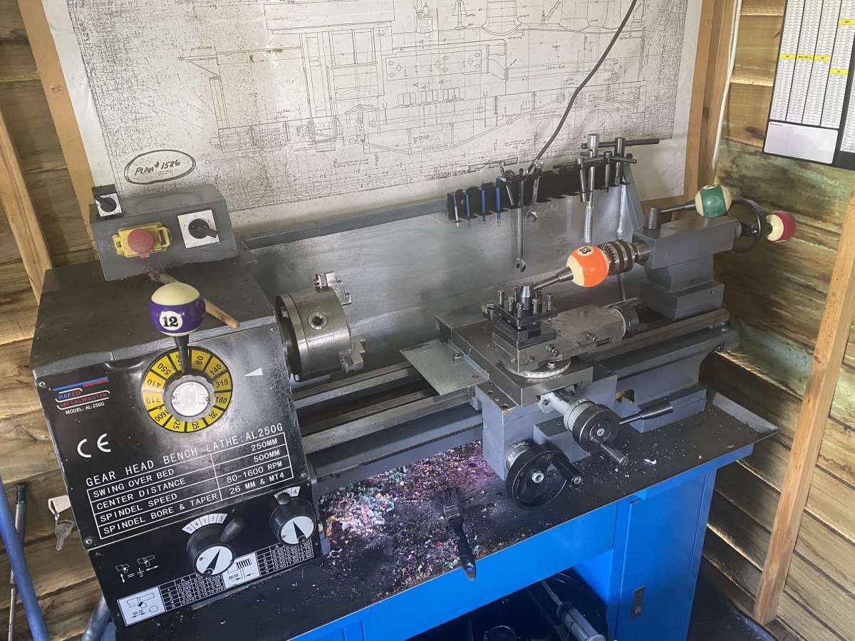

                                      I have balls left over, looked at my lathe and thought,,,,,”why not”lathe

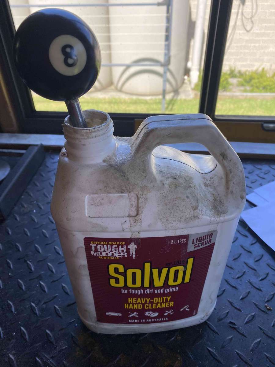

                                            So sitting around this morning wonderring what to do with the 4 pool balls left over from set. Then it hit me, had 3 handles left on mill so did the drilling downfeed. That left 1 ball, been having trouble with handcleaner pump blocking up and thought back to apprenticeship where we used a strip of flat bar to apply cleaner to hands, did a 10mm dia round bar for application and stirring of soapIMG_1877IMG_1885
