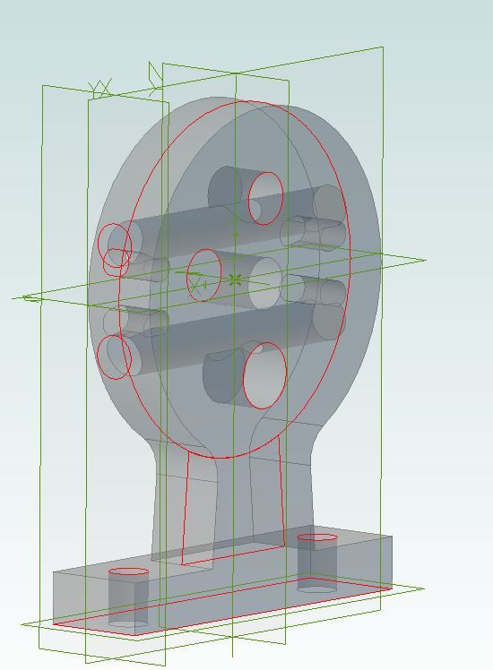

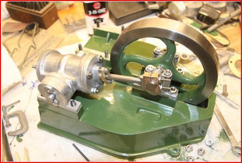

      I finally got the green twin oscillator running the other day.
      Still a bit more work to do with painting and fasteners, but it is running.
      Not a great video, but I will take a better one when the painting is done.
      And I built a new furnace for iron work, and it is shown here.
      It works extremely well at melting iron.
      How goes it on this side of the pond ?

            It is far from "JasonB-grade" quality, but I am pleased with it, since it is basically my second engine, with my first engine being a simple small wobbler.
            It all started as just a whim to see if I could do some serious modeling in 3D, and the next thing I knew, it mushroomed into a foundry hobby, etc.
            I must say it is great fun to get an engine to run, especially after many years of on and off work (six years maybe).
            The flywheel was cast in gray iron, and the remaining parts were cast in 356 aluminum.

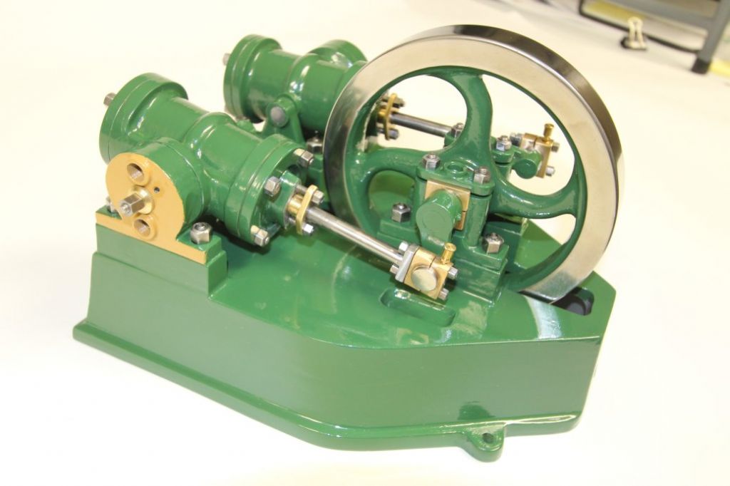

              Hi Pat,
              This side of the pond is good, a little cold but gradually getting warmer, assume you live stateside.
              Nice model well done, runs well.
              I am currently making a twin cylinder d/a oscillator with a similar configuration to yours using a central cast iron flywheel and cylinders cast in iron from home made patterns. Unfortunately I don't have foundry like yours!!!!
              Could I ask is there any particular reason that you have the port blocks on the outside of the cylinders and the pivot blocks on the inside? My plan is to do it the other way round.
              Also what size is your engine, i.e. stroke length, bore size etc.
              cheers Geoff

                Hey Geoff-
                My engine has a 1.25" bore with a 2" stroke, and a 6" diameter flywheel.
                It is a 60% scale model of an engine that I saw in three photographs on the Prestons Steam Services site.
                The Preston's site incorrectly lists some of the full sized engine dimensions.
                The full sized flywheel is actually 10" dia, and the full sized bore is 2", with a 3.5" stroke.
                I do plan on publishing full drawings for this engine this year.

                  Good work Pat.
                  I am interested to know what the original engine would have used for as I can't see a way power would have been taken from the flywheel. Any ideas?
                  #396494
                  PatJ
                    @patj87806
                    I have to assume that the power takeoff was via a flat belt that rode on the flywheel rim, and I suspect that because the original engine (and my model) have a hole in the front of the frame that would allow a belt to exit the base.
                    The engine could have been used in a number of applications to power machine tools, sewing machines, or small equipment, and would have been especially useful for equipment that needed a self-starting and quick reversing.

                      I see. The hole in the front was not visible in the video.

                        Hi Pat,
                        Thank you for your P.M., I'll get back to you on that.
                        Really glad you posted the video. I was have having a real problem arranging the pipe work for my engine.
                        Referring back to my earlier post you have given me the answer.
                        By switching the port and pivot blocks around, which I can do, I will have ample space to arrange the pipe work and be able to use compression fittings.
                        With the port blocks inside of the cylinders space was very tight.

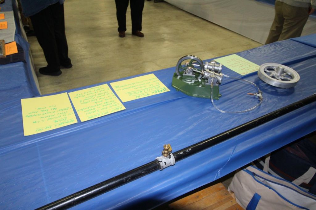

                                      I took the green twin oscillator to the NAMES show Saturday (2019 show), and it was a truly humbling experience to say the least.
                                      The guys who display at the national shows are rather good at what they do, and so my engine looked rather paltry compared to the many museum-grade engines at the show.
                                      But for those who took the time to read the description of how the engine came about, they were impressed with the process.
                                      And I am pleased to say that I am ahead of many/most as far as making my own iron castings, and I can definitely compete on the national scene with that, if not meet or exceed pretty much anything available commercially.
                                      Edited By PatJ on 29/04/2019 23:29:44
                                      Edited By PatJ on 29/04/2019 23:30:10
                                      #407120
                                      PatJ
                                        @patj87806
                                        A rather lowly little display (downright laughable in some ways)  if there ever was one.
                                        My intention was to get the engine painted before I showed it, but that did not happen.
                                        I was on the fence about displaying it, but two guy attending the show encouraged me to set it out, and so I did.
                                        The bright side is that this little engine has put me in a position from a knowledge and casting standpoint of making some hopefully really nice engines.
                                        And this was my first complete engine build, so I feel like I can only go upwards from here.
                                        Edit:
                                        The jumbo Cretors flywheel casting drew as much or more attention as the green twin oscillator.
                                        Most that looked at the green twin (without reading the text) said to me "Casting kit ?".
                                        I said "No, home cast".
                                        It was painfully obvious that many could not begin to comprehend what "home cast" meant.
                                        Very few seem to cast their own engine parts, especially in iron.
                                        Edited By PatJ on 29/04/2019 23:49:52

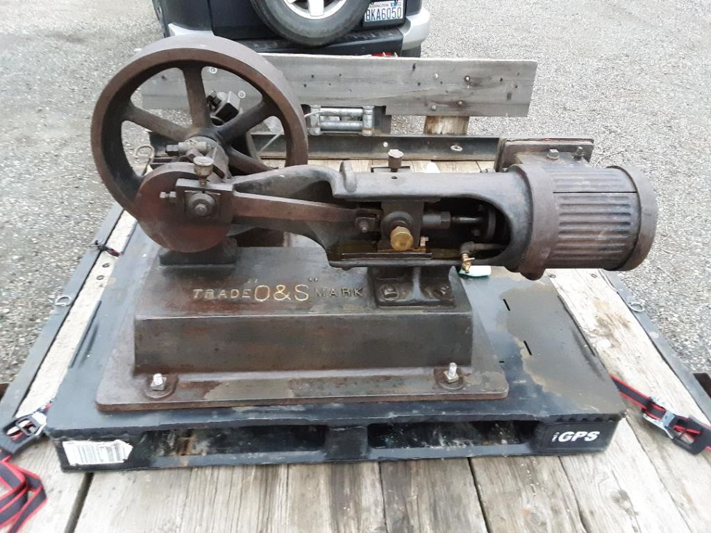

                                              Hey Jason, that sounds cool. Which one did you model?
                                              I am considering making a 60% O&S Horizontal, which would give it a 3" bore.
                                              The footprint would be 20"x20".
                                              Or I may downsize it a bit and make it a twin.
                                              I will attach a photo of my go-by engine.
                                              I picked this one up in the Pacific Northwest, so I would have something to measure.
                                              Edited By PatJ on 07/06/2020 19:52:45

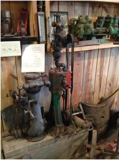

                                                  Since the O-S Horizontal came along, I am considering sharing the components between a horizontal engine and a bottle engine, so I don't have to make two sets of designs/patterns for many things.
                                                  Bottle rocker photo attached.
