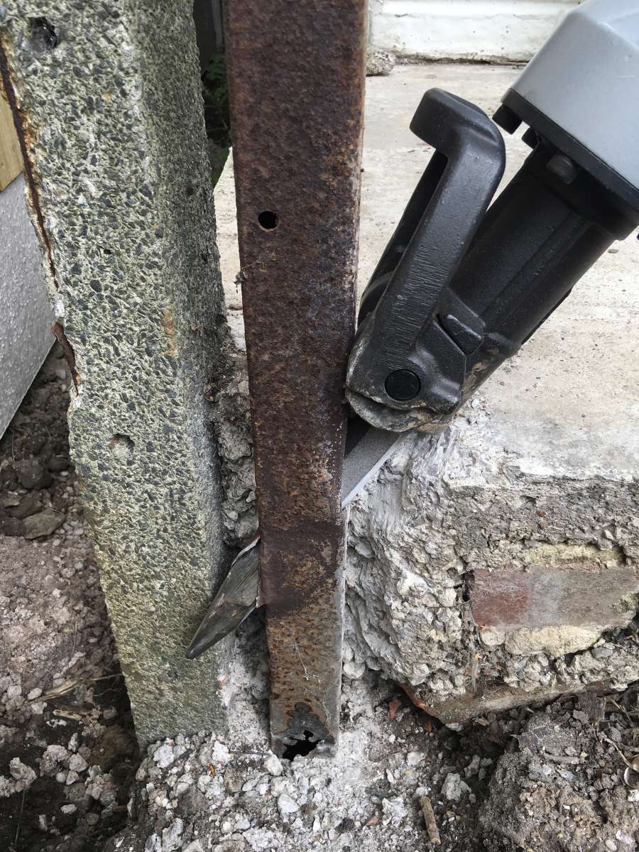

        Having seen how tough such items are … I would recommend using the cut-off disk !
        Edit: __ Here is one I abused earlier:
        IMG_8750

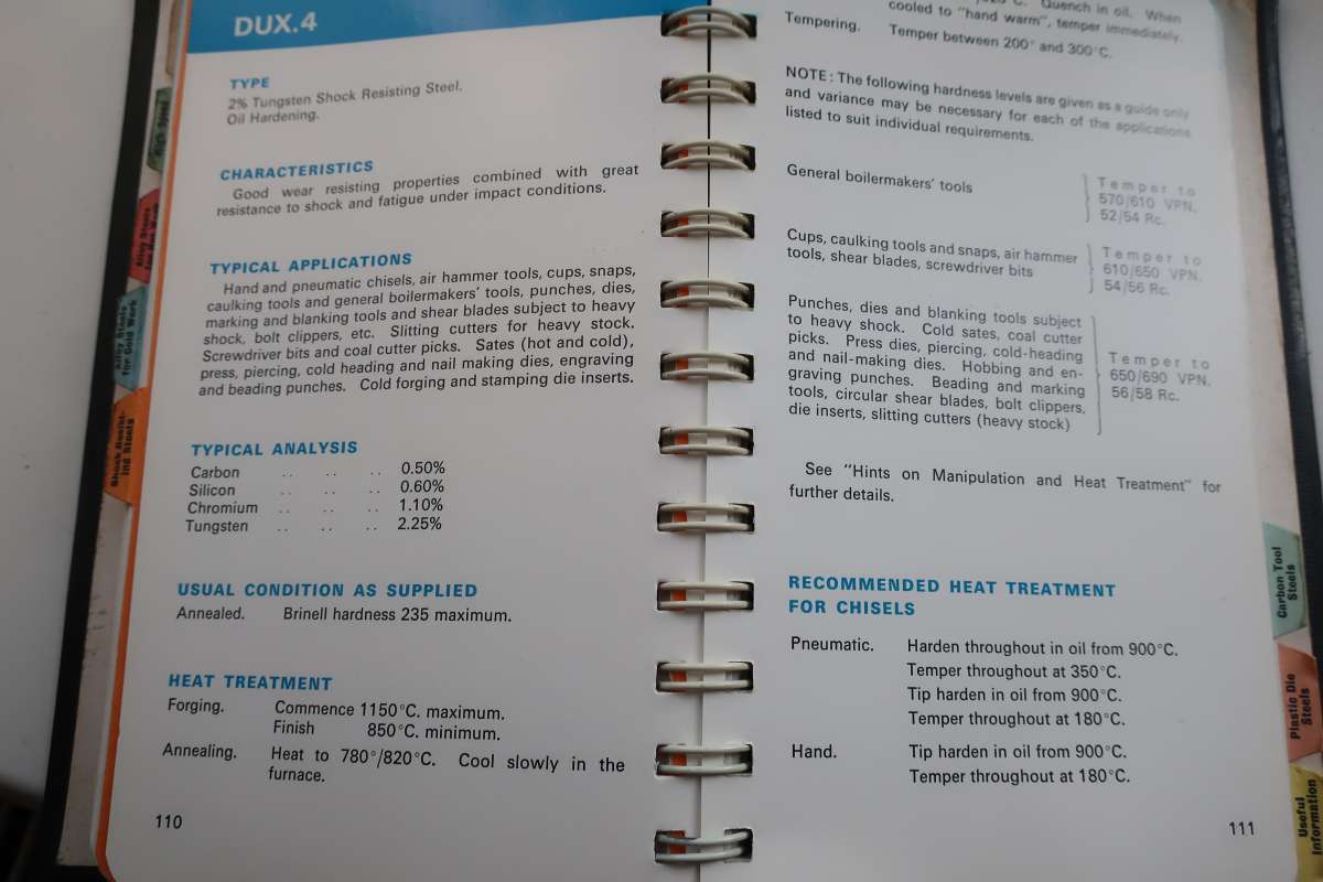

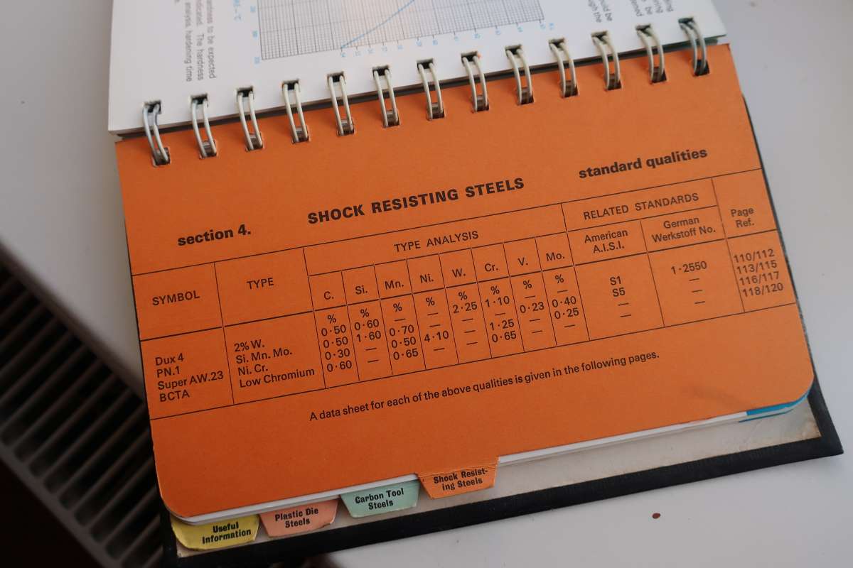

                  #788799
                  Diogenes
                    @diogenes
                    The defining characteristic of steel used in ‘Breaker Points’ will be resistance to repeated impact…
                    In any case, I wanted to show you this book because I’m sure your local suppliers must have produced something similar in days of yore – old, yes, but the ‘recipes’ will probably allow comparison.. it’s a mine of information.. ..an Ebay job for sure..
                    IMG_2579
                    IMG_2580
                    IMG_2581
