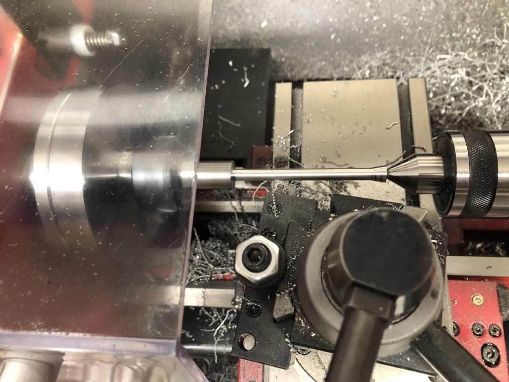

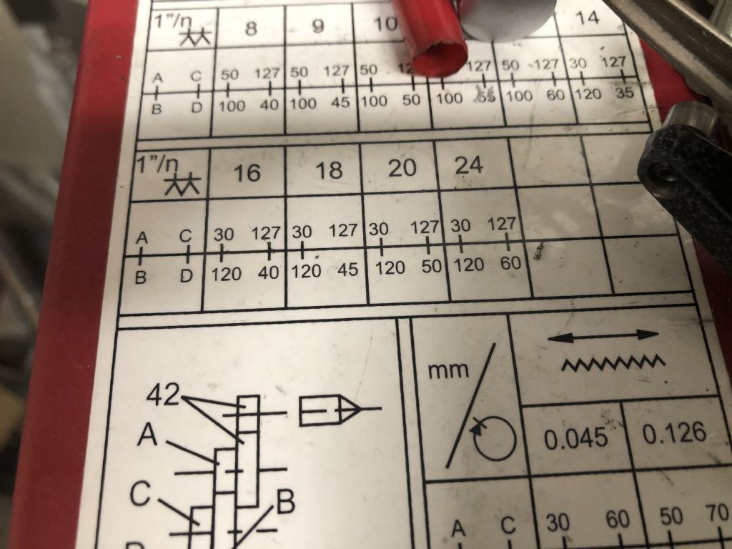

        I was in the local nut and bolt merchant last week to overhear the proprietor telling a local piano restorer that he had never seen anything like the bolts the restorer had presented to him.
        They basically hold a wooden frame into the top of the open part of the piano.
        As I walked in, the owner of the nut and bolt shop was saying that the local engineering shop would be the best first port of call, but that they were flat out busy. What he needed was somebody with a lathe in the garage…. (the words were…. just the man.)
        I agreed that if I could work out what thread was on the bolt, and also set my lathe up to cut it, I would oblige.
        Measuring the bolt, over both the shank and the threads, it is 6.6 mm, with a set of thread gauges, it is 22 tpi. The only thing that I can find anywhere near that is an old German thread, from the 1850s, a Hamann Partonen 7mm x 22 tpi.
        As the parts come from a 140 year old German Grand piano, it looks like a promising candidate.
        My lathe (a Seig SC4) doesn't have a 22 tpi gear setting –
        But looking at the above, as the 20 and 24 settings basically use the same first 3 gears and it is only the last gear that produces the 20 and 24, I used the logic that a 55 would be smack in the middle.

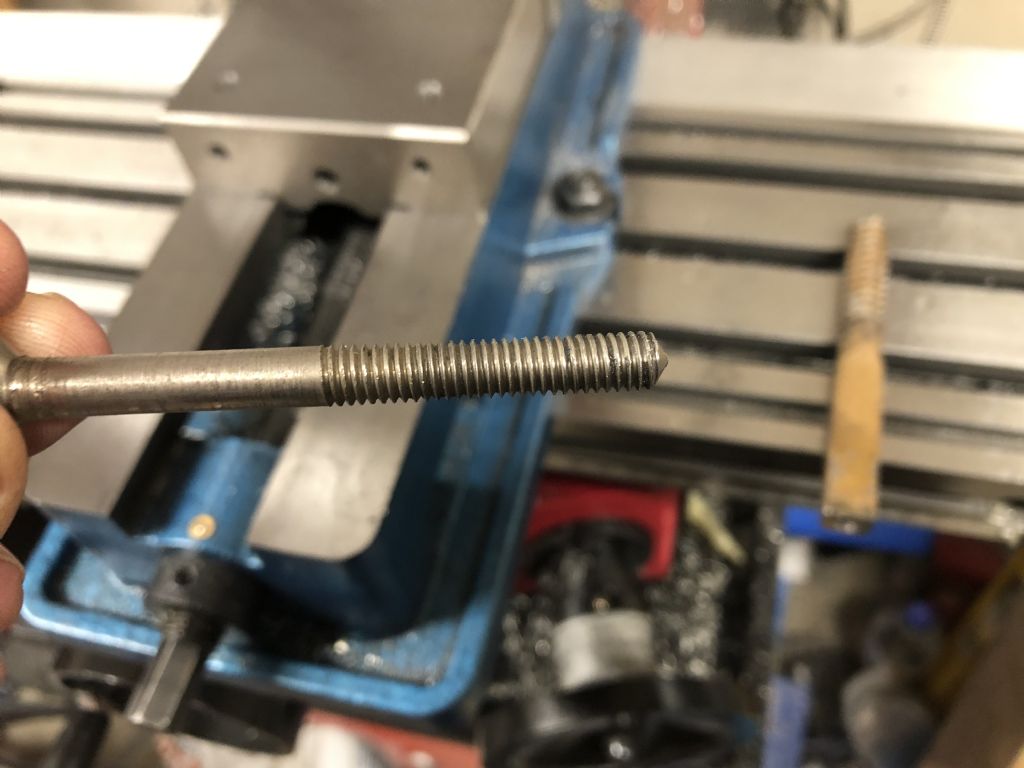

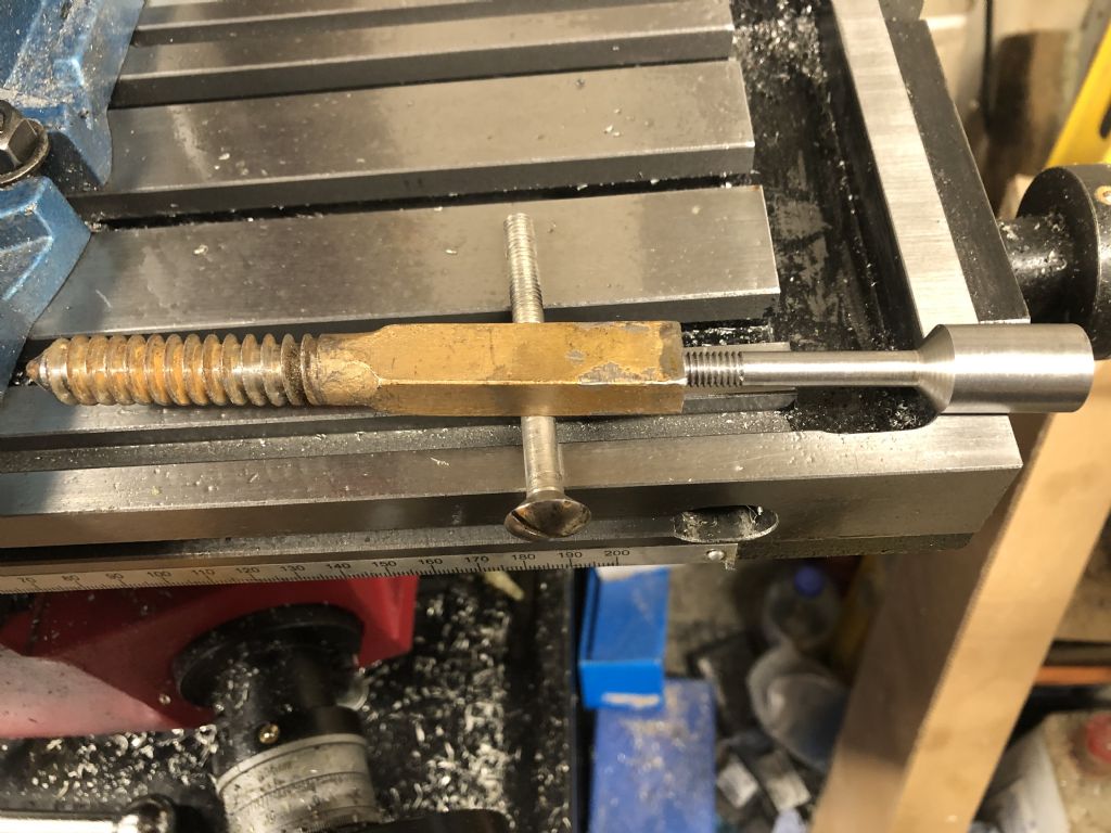

        I roughed out the shanks to 6.6 mm and set to work screwcutting the thread. Amazingly, it fits:

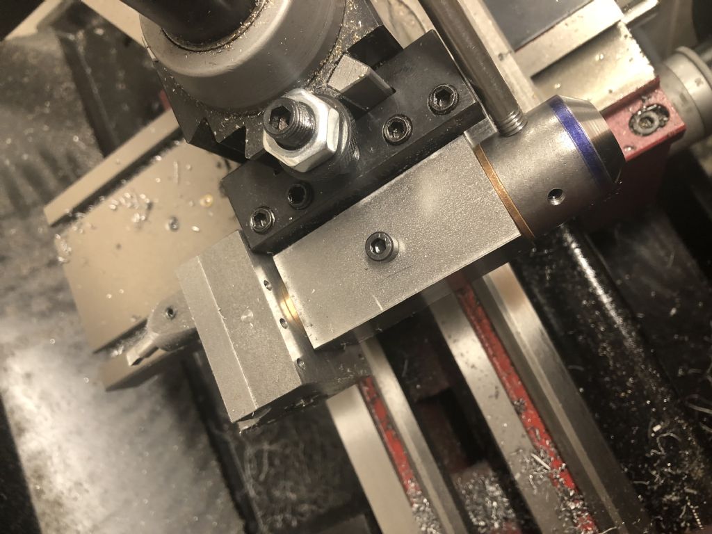

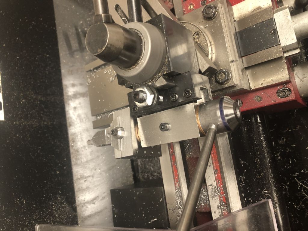

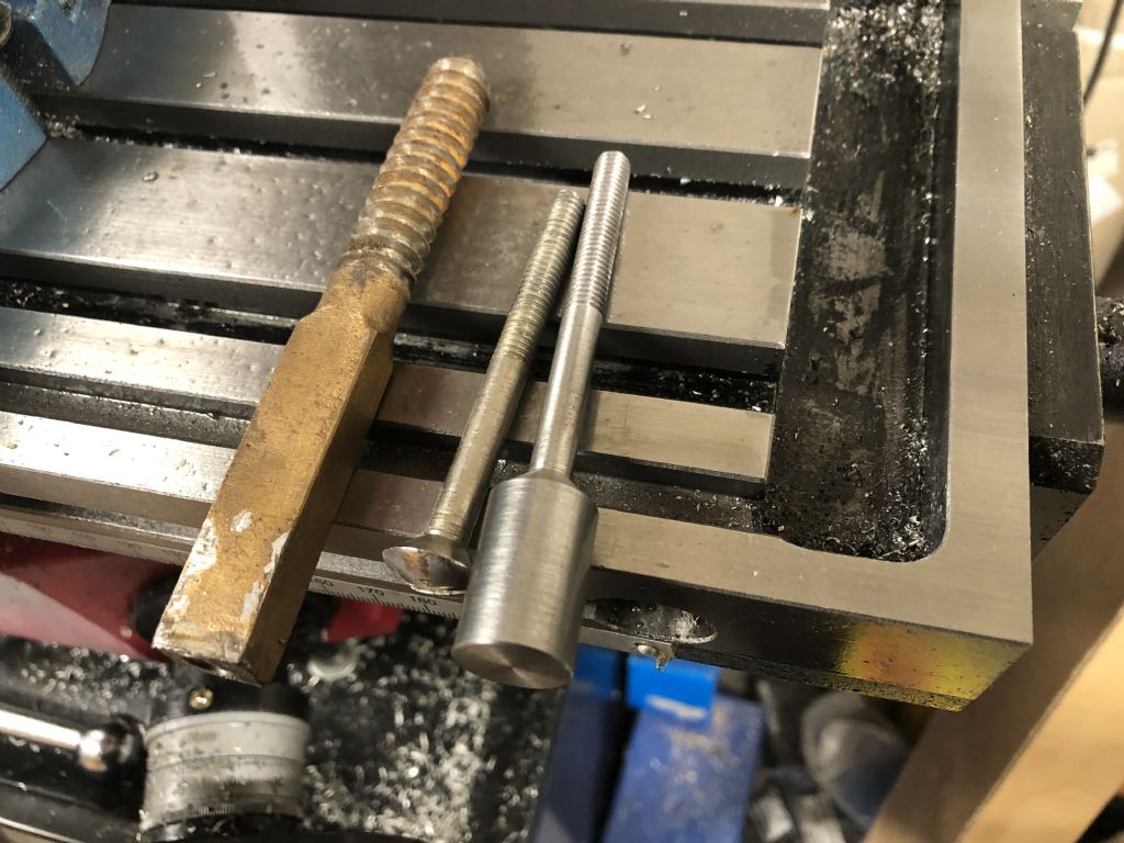

        3 made, I need to round off the heads and cut a slot, so I have ordered a Hemingway radius tool that I'm going to have to make. Once done, they can go in the mill and have the slots cut with a slitting saw.
        An interesting little project.

          I forgot to say that I got all excited when I found that 5/16 BSF is 22 tpi, and that I could get a die. Apparently the Germans used a lot of British Standard threads in those days. I thought great, just buy a die and cut the threads with that.
          Only snag is, 5/16 BSF major diameter is 7.9375 mm
          Cheers
          Mark

                Posted by Mark Elen 1 on 17/11/2019 15:08:51:
                But a BSF chaser would be reasonably agnostic regarding diameter.

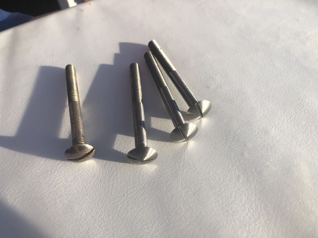

                        #440807
                        Mark Elen 1
                          @markelen1
                          Hi Mart,

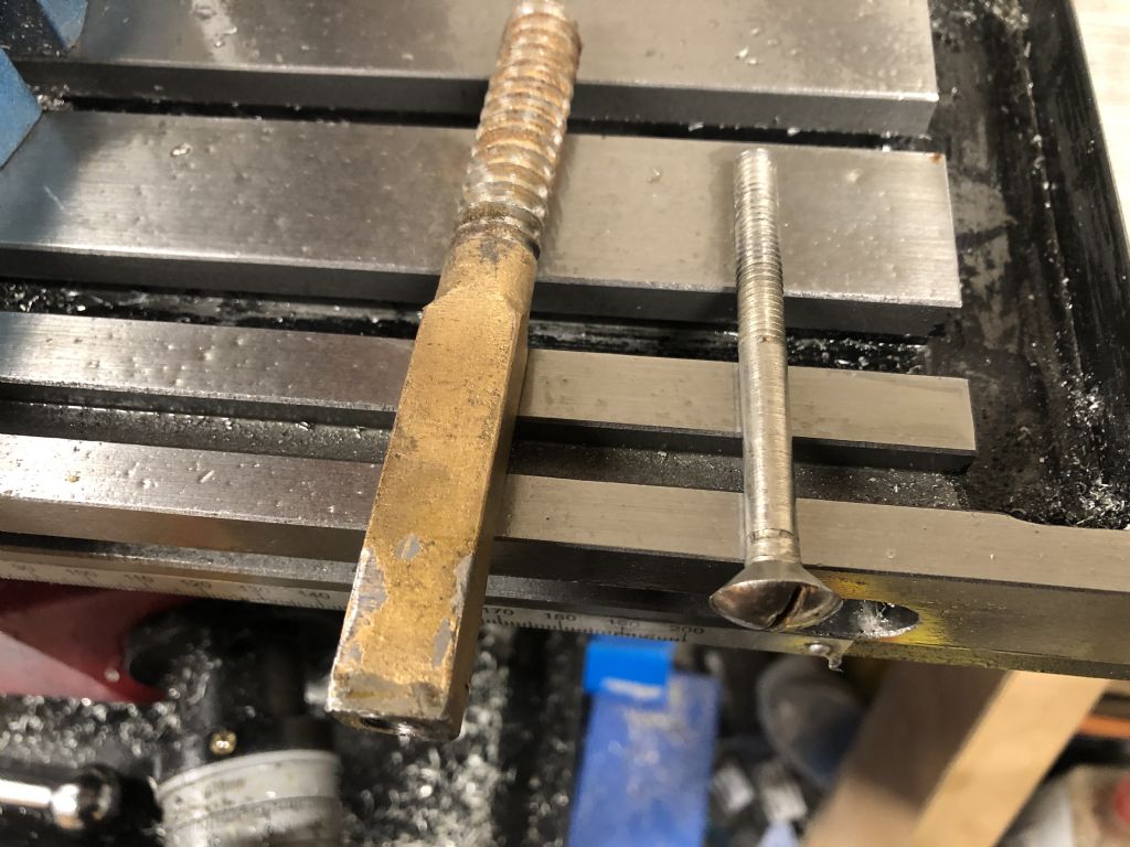

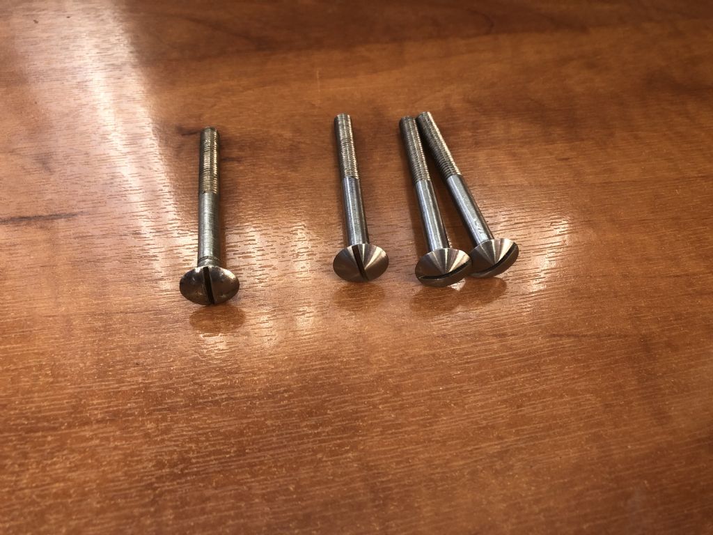

                          Yes, the restorer is going to give me a call when it is done to go and have a look. I finished off the radius tool last weekend, then finished off the bolts. The original is the one on the left. My new ones are the 3 on the right.
