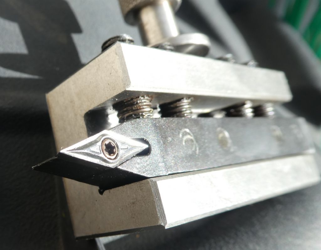

                I engraved some dials for a little lathe a few weeks ago using this:
                I was pleasantly surprised with the results which can be seen in my album "Record ML-10 lathe".

                  Neat approach, Rik. I don't know the angles on those tips, but it looks around 40º.
                  #535684
                  Emgee
                    @emgee
                    Posted by Nigel Graham 2 on 23/03/2021 22:01:00:
                    35 degrees
                    Emgee

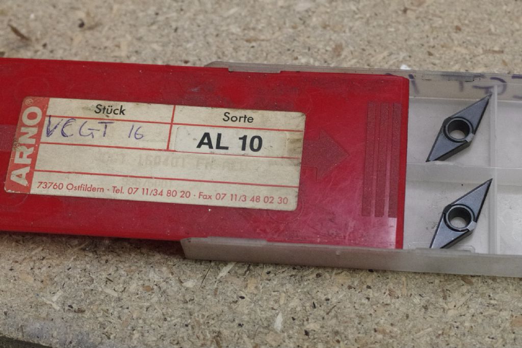

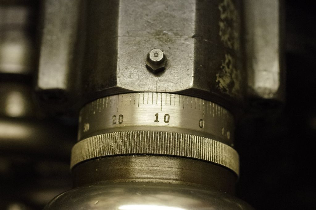

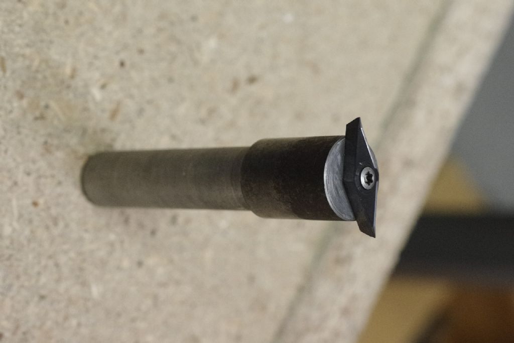

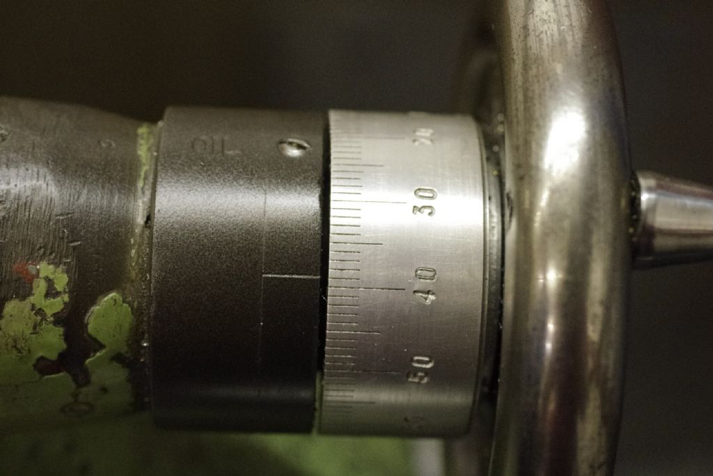

                      _igp2448.jpg_igp2447.jpg_igp2446.jpgI did some using some carbide inserts the same as Rik's on the cross slide dial and the tailstick on the Smart & Brown model A. They are VCGT 160401, came in a job lot and are too sharp for normal use (0.5mm rad tip).
