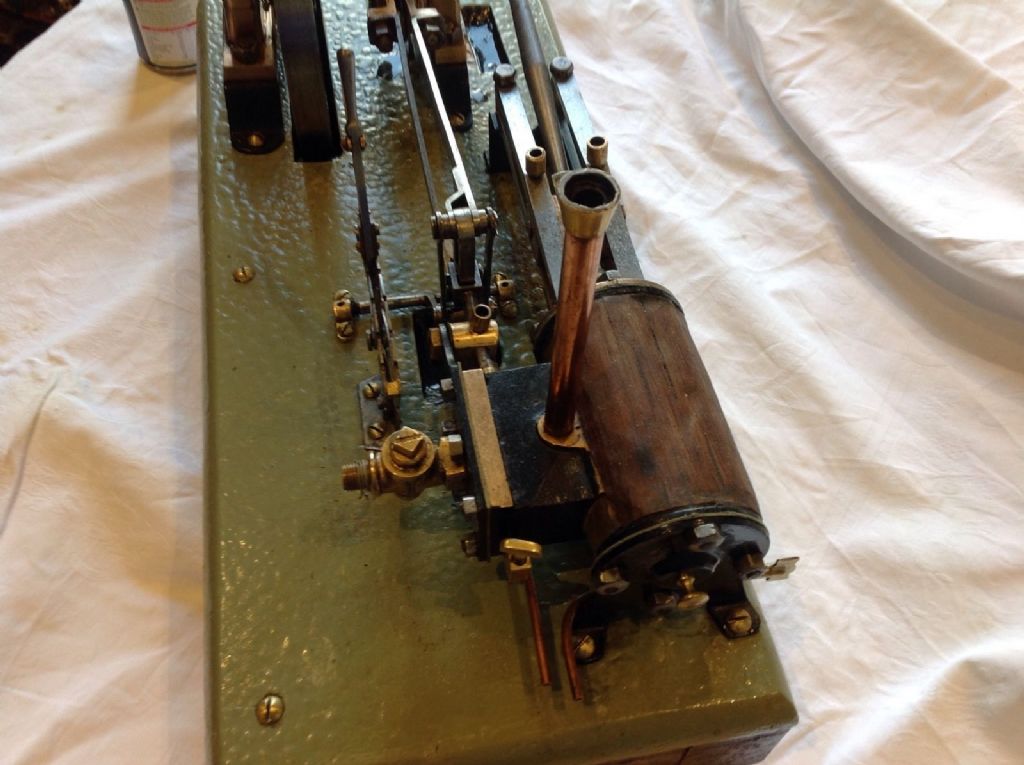

      Hi all.
      New to forum but not engineering but new to model engineering.
      I bought a second hand mill engine model that's in Ok condition bit too much slack etc. My main question is about fittings the globe style valve on the steam chest is well pass it's best but I am having trouble finding anything I can use online as I seem to only find upto 1/4 inch where my fitting is 1/2 inch thread.
      So far I either going to make new chest plate with 1/4 rather than the current 1/2 inch OR find a plan for a globe valve and machine my own.
      What would you all think?
      Thanks
      Gavin

              Is the thread 1/2" major diameter or 1/2" BSP/NPT there is quite a difference. 1/4" BSP thread is actually a bit over 1/2" outside diameter at 0.531" though may measure a bit less.
              Would also help to know the pitch of the thread as if 1/2 dia it could be 26, 32 or even 40 TPI or others.
              If it is 1/4" BSP then RA BAker do them

                Hi all thanks for replying I've uploaded a picture hope it works.they are of before stripped it all down.
                The valve does look oversized. I will get the thread measured later and let you know.
                Thanks
                Gavin

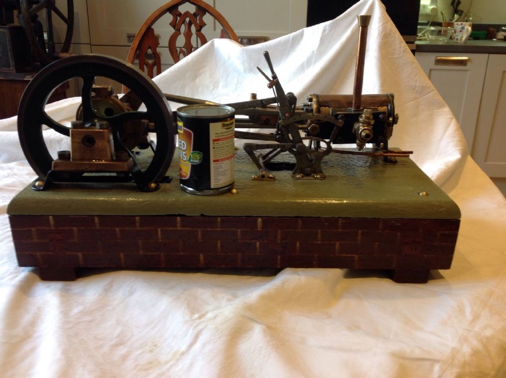

                        It is an old beast, I like the reversing gear.
                        Stew

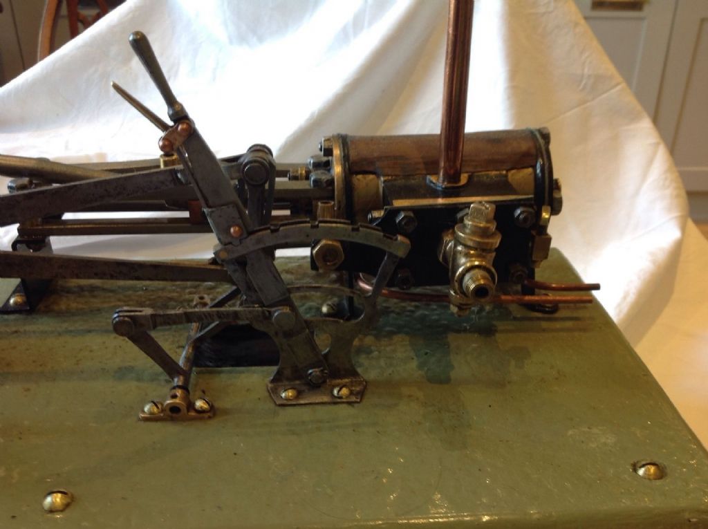

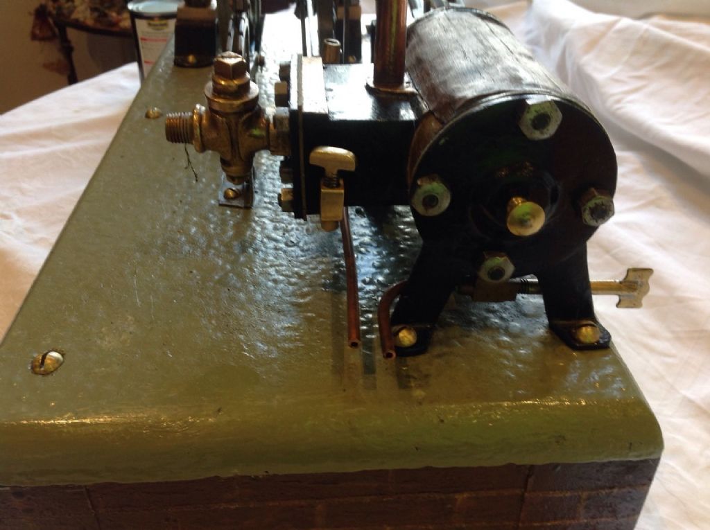

                          I'd say thats a 1/2" or there abouts diameter thread so could well be the 1/4" BSP I suggested.
                          Its also not a globe valve, more a 1/4 turn "cock"
                          The one you have uses a taper to seal the spindle to the body, that may just need lapping again to get it working but a globe valve would be a better option as it gives easier control of the flow
                          J

                            Hi Jason yeah I knew it wasn't a globe valve just didn't know what to call it but u are right it's a tapered 1/4 turn.it's been damaged so bad by who ever removed all the paint take alot of polishing it remove all the details on it.but I want a globe valve for same reason you said better control
                            I post more pictures as I rebuild

                              Also known in engineering as 'Plug valve' as well as 1/4 turn cock…
                              Plug valve.
