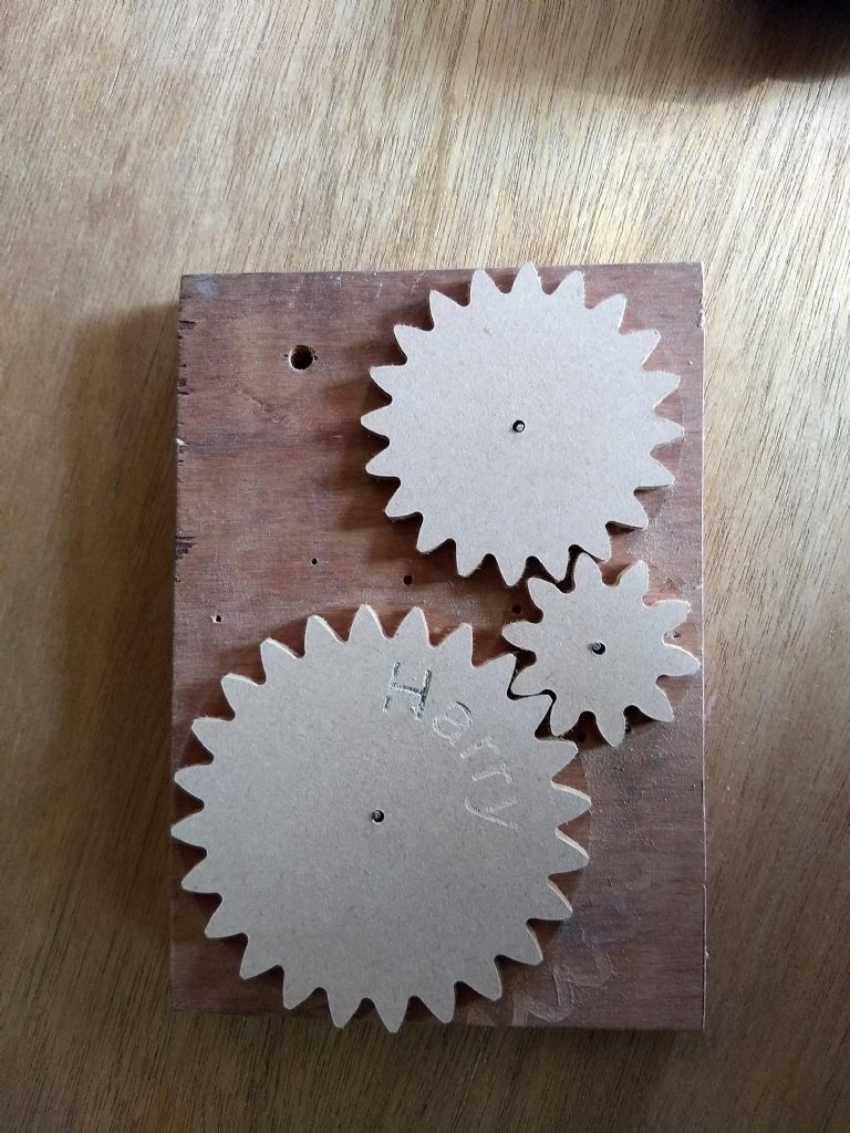

        Sort of model engineering. I came across this site:
        **LINK**
        For a $2 Paypal payment you get 24 hours to download as many gears in .dxf format as you need.
        Once you have the .dxf files you can then scale them up as you wish. I upscaled these in CUT2D and then had the KX1 cut them out. This is a set for a toy for my Grandson –

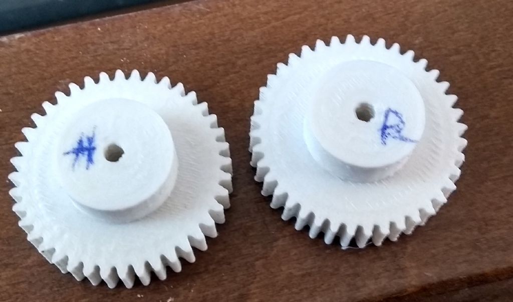

                                  I've downloaded a gear from Rush and one from Dr Hessmer's page. I'll print them side by side to compare.
                                  (In Cura they look identical, the RUsh one allowed me to create the hub as part of the design, I had to add it manually to the other, which meant some fiddly alignment as Alibre wouldn't let me add constraints based on the DXF for some reason).

                                    Printed gears, Hesser on the left, Rush on the right. dIffernces are negligible, a matching pinion doesn't seem to quite bottom out on the Hesser gear so its teeth may be slightly more full. Both perfectly usable and they run together nicely.
