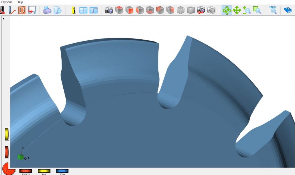

              Indeed it could. The Gearotic package will generate code to do this, though it assumes the use of a standard end mill rather than a saw blade.
              #581315
                Maybe OK for large teeth but typical ME sizes would need a thin and flexible saw.
                Would possibly be better with the blank horizontal, drill a hole for each root the mill a radial slot of the same dia to remove most of the waste and then just move it round as he does taking material off the edge of the tooth with the side of the milling cutter, subject to gear thickness
                If you have the CNC mill then you just use a ball nose cutter, or CNC cut a HSS single point gear cutter then use that.

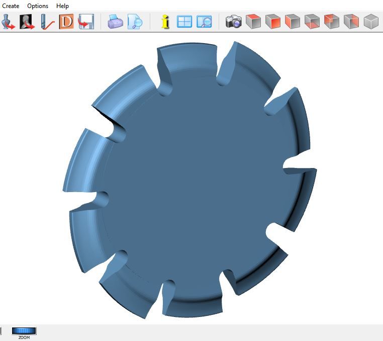

                    I went the whole hog and made a proper gear cutter, although I have used Gearotic to end mill one-offs successfully too.
                    Gearotic generated the correct tooth profile, which I took into MoI and made the model.
                    DeskProto then used the resulting STL file in a rotary axis operation to make the part.
                    It performed very well to make some Myford ML7 bull wheels.
