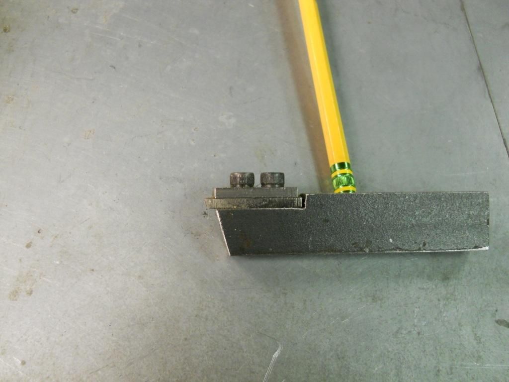

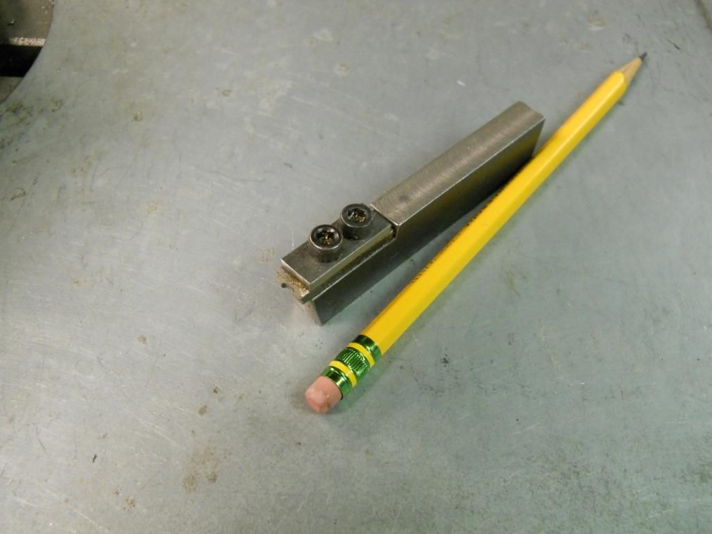

            #627117
            Jeff Dayman
              @jeffdayman43397
              Another way to make "insert style" form tools from .093 or .125" gauge plate is shown in the pics.

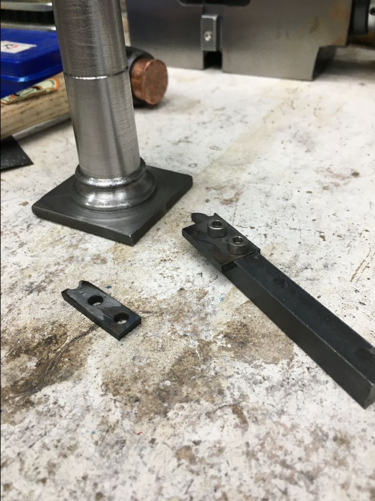

                                  #628516
                                  James Hall 3
                                    @jameshall3
                                    Thanks to everybody for some helpful responses. Got some 1/8" gauge plate and had a go – cleaning up the column mouldings for my Stuart beam. I started small with just the bead and then on to the rest. First attempt failed as the iron machined my tool – insufficient heat when hardening – judged by eye, next attempt used a magnet and all was well.
                                    Pic shows the result, which I'm pleased with as the casting was very poor quality, very oval, ill-defined, and full of sand pits (some of which remain, but it will be painted) – at least it's round now and the mouldings are properly formed. I'm now confident to further make and use form tools as and when required.
                                    Seems difficult to find cones – almost all people selling step drills advertised as cones, but not at all what is required. I eventually purchased a taper end mill (half as much again as a cheap cone but has already done more work than the only cone I ever owned and which blunted at the mere sight of steel), which easily produced relieved holes and allows very fine control of the hole size for beads etc.img_2130.jpg
