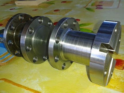

                                                    Speedy Builder5
                                                      @speedybuilder5
                                                      I have just finished machining some drive shaft components for a 1923 Bugatti. The steel bar was a flame cut piece of 3" diameter hydraulic ram. Super stuff to machine once you were under the hard chrome surface.g-boxshaft2.jpg
