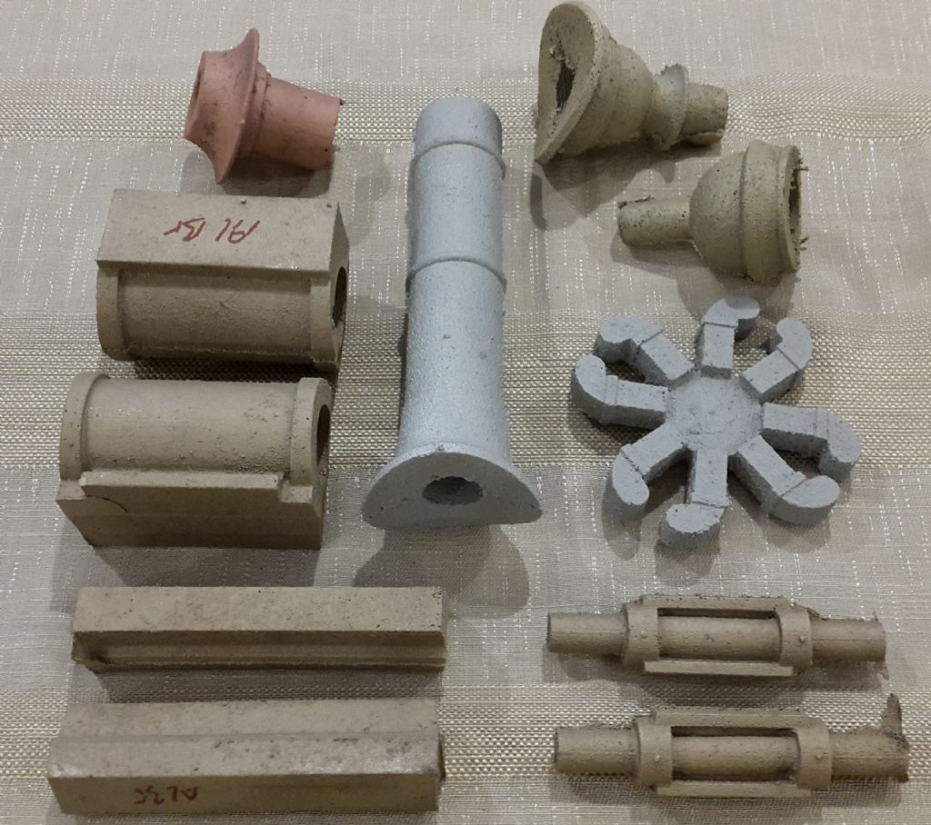

          Spot on Noel, can’t add anything to that! You should share the YouTube link of you casting; I found it very interesting. I picked up one or two tricks from that video…
          Believe it or not I had a gap day yesterday and did a few castings. Aluminium for the chimney (to bring the CG closer to where I want it for the new loco, but this is painted), copper cap, and AlBr for the bearing bits and cylinders. The safety valve cover and steam dome is normal brass. These castings were given a light sand blast and the ingates have been cut off, I still need to clean the flashes off and beautify.
