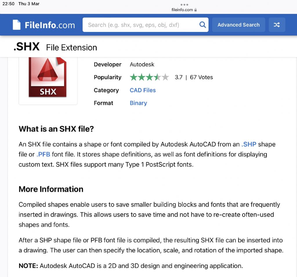

            Posted by duncan webster on 03/03/2022 22:03:54:
            … no idea what an shx is …
            Here you go, Duncan
            Edit: __ I have never used NanoCad, but you might find this useful:
            https://youtu.be/xhfIQRctcGA
            Edited By Michael Gilligan on 03/03/2022 23:15:21

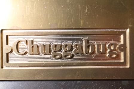

                  John Haine
                    @johnhaine32865
                    I agree with Martin, use Fengrave for this sort of job.
                    Here's one I made earlier…

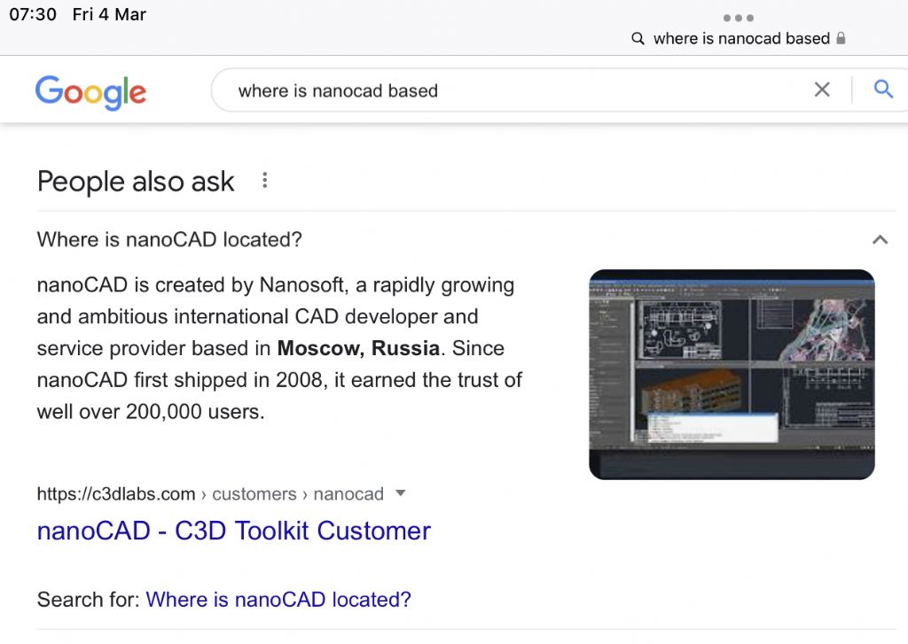

                        Posted by Michael Gilligan on 04/03/2022 06:53:48:
                        Just dug a little further, and will say no more:
                        #588055

                            Posted by Michael Gilligan on 04/03/2022 07:38:30:
                            If I thought that deleting NanoCad would have any effect on the Russian madman it would already have gone, but it won't, it's free. I'm trying to make artwork for chemical etch, not engraving, so would prefer not to have to learn a new package..

                              Posted by duncan webster on 04/03/2022 10:57:07:
                              Edited By duncan webster on 04/03/2022 10:59:28
                              dont know
                              That wasn’t really my point, Duncan
                              I was merely pointing out that my original gut-feeling about the Privacy Policy may be correct.
                              … I therefore leave it to you to decide whether the ‘free’ version is crippled, or whether you didn’t quite follow the YouTube demonstration.
                              If there is a privacy problem, then presumably you will already have it.
                              Edited By Michael Gilligan on 04/03/2022 14:05:53

                                  #588208
                                  John Haine
                                    @johnhaine32865
                                    Duncan, good it's sorted, but I was wondering, if you just wanted to make an artwork for etching from why not just use a standard word processing package? IIRC, I generated the original image for "Chuggabug" using Word.
