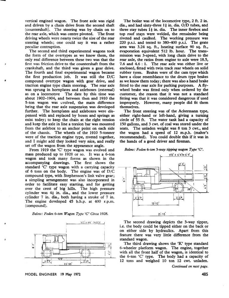

        Wonder if anyone can help, I am starting to work on a Mamod size Foden wagon using a couple of parts from Mamod for the wheels and the chassis rails, the rest will be home built – what I really need is a set of side elevation of a C type steam wagon – the rest I can work out as I go just need to get the dimensions right
        where can I get a set without having to buy the full set for a 3" wagon

          From ME 3441
          #310384
            You can zoom in quite well on the GA drawing on Reeves site which will give you more dimensions than Ady1's sketch. Just click the image a couple of times and the sheet comes up a reasonable size then save the image to disc and you can blow it up further from there.
