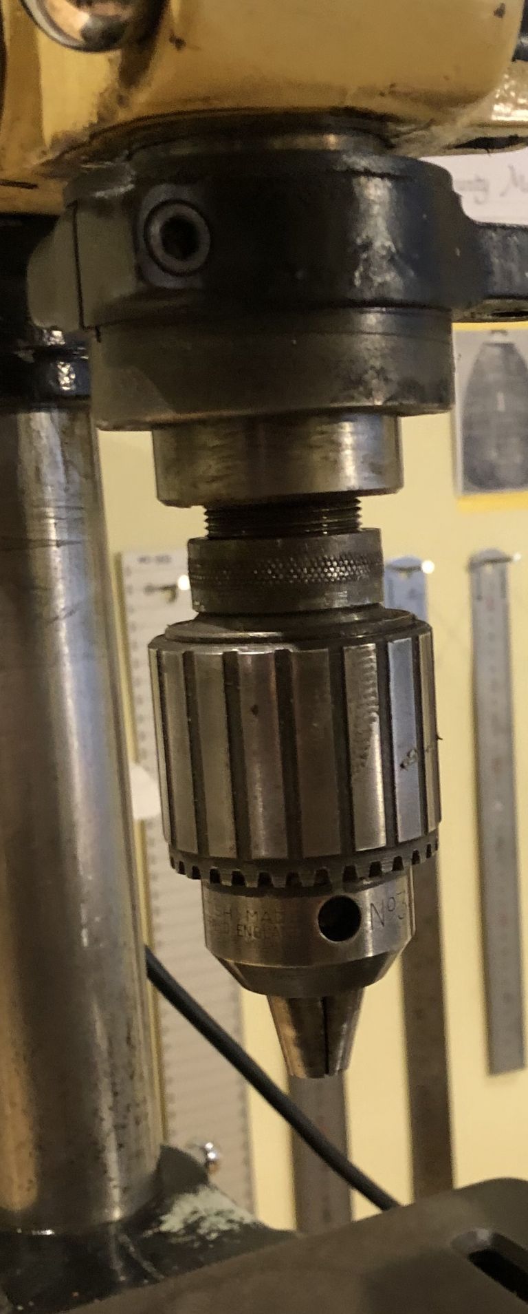

      I've recently acquired a Fobco Star drill. It seems pretty solid, no significant slop on the quill, but there is about 0.1mm runout on drills held in the (possibly original?) Jacobs chuck. Indicating on the chuck body just below the key holes gives zero runout, give or take, so I'm hoping that the problem is with wear on the chuck jaws. But how do I get the chuck off? It's a male taper on the spindle I think, no slots in the quill for a drift. Wedges and brute force?

          Between the bottom of the quill and your male taper (probably a JT6 ) there should be a knurled ring , it looks like its there from the photo
          If you unscrew this it will reveal a hole in the side you can put a pin spanner in.
          Keep unscrewing and the chuck should hopefully pop off.

              Thanks both. I can't see any knurled ring, but I shall get hold of the dismantling guide available from the lathes.co.uk site to which peak4 gave a link .

                Extend the quill downwards as if you were drilling and clamp it in that position. Remove the nut from the bottom of the threaded depth stop bar and remove the bar. Now loosen the casting cap head screw that is just visible at the top left of your photo, note where the casting is on the quill and then waggle it upwards on the quill and you should see the chuck removal collar. If at all possible, try to get a C spanner to fit the holes on the collar. Otherwise screw the collar downwards until it touches the top of the chuck, protect the collar with some soft metal and holding the chuck firmly (Chuck key in one of the holes helps) use water pump pliers or similar to wind the collar down until the chuck pops off. Put some rag or similar underneath to catch it or you may end up with a sore foot (don't ask!)

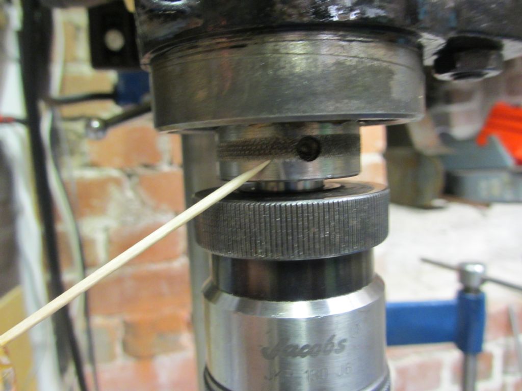

                  Hopefully a picture speaks a thousand words !
                  I've wound the collar down so its more visible

                        Yay! Thanks Gordon for your lucid instructions and T.B. for the very clear pic of what I should be looking for . The only snag I encountered was when trying to move the collar which holds the depth stop up the quill – it was rock solid even after removing the clamping screw. I had to drive a wedge into the split open it up a bit, worrying but I got away with it without cracking the casting.
                        Runout on the taper is a tad under 0.01mm, which I think I can live with smiley .

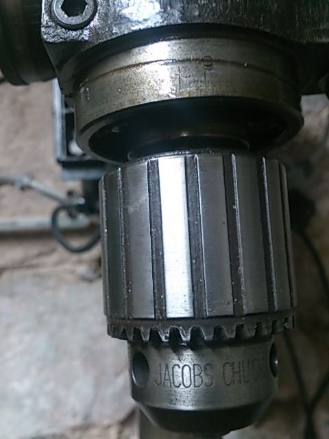

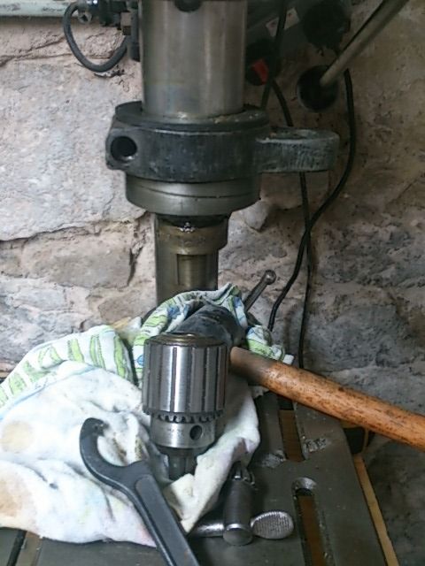

                            I recently bought a Fobco Star Drill (Bench model). There is some runout in the chuck which I am looking to sort out. Having not done this sort of thing before, my first port of call is to try to remove the Chuck, to see whether the runout is present in the Quill too. Hopefully this might be the case, and so it will then just be a case of sorting out the Chuck.
                            However, I am having some difficulties in actually removing the Chuck. Please see the photo attached as to where I am with it. I have removed the threaded depth stop bar, loosened the iron casting and positioned it upwards, revealing the chuck removal collar/knurled ring.
                            However, there is NO HOLE in the knurled ring on my Fobco Star, unlike the one pictured above. I have used water pump pliers to loosen the knurled ring all the way down to the top of the Chuck, and the Chuck still stays in place. Does anyone have any tips on how I can remove the Chuck from here?

                              Get a spacer to go between the knurled ring and the chuck…big washer with a slot cut out to go over teh spindle…
                              #637694
                              DMR
                                @dmr
                                As Ian says but make it wedge shaped along the cut edge so you can tap it in. search for "wedge" and you should get the idea. If you form two up you can clamp them together which is less stressful on the machine itself.

                                  You are still using the knurled collar but just need it to push a little more

                                    I managed to get the Chuck off. The runout is in the Chuck, not the Jacobs taper. Which is very good news for me.
