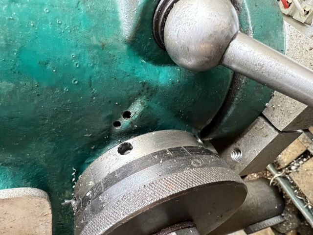

      I acquired a 7/8 Fobco drill press today along with Jones and Shipman 540surface grinder . The drill press is a non runner. I’m hoping it’s an easy fix. But I noticed the quill does not return had quick look and no return spring. Lathes .co.uk do the spring so no problem there but the housing just spins does anyone have a drawing of this assembly or a manual please. I am also looking for a manual and any useful info on the surface grinder. Many thanks in advance Mark.

              The spring housing has a small ball bearing with a quite powerful spring pushing on the housing so you can only turn it towards making the return action stronger theres a small hole nearby that you can poke a small rod into to release the ball..

                The hole near the front has a spring in it with the ball the hole behind lets you release the ball1533149e-7c0e-49c5-b0f5-e1f29c45314e.jpeg

                  Posted by Ian Parkin on 29/10/2022 19:09:21:
                  Thanks for the reply I’m assuming that your picture is of a Fobco Star !? There is a one hole underneath that feels like it has a ball bearing in it. It does release the drum to spin both ways if I insert a screwdriver. I have now found out that the contractor inside has a burnt out coil. So I’m trying to source one the will fit inside the machine. Thank you to everyone else who replied. mark

                    Well i posted the picture as you were asking about a fobco 7/8 which the picture is of..if you want a picture of a star ask away
                    #619166
                    Mark Harris 1
                      @markharris1
                      My 7/8 must be different yours then !
                      #619169
                      Ian Parkin
                        @ianparkin39383
                        Well lets see a pic then?

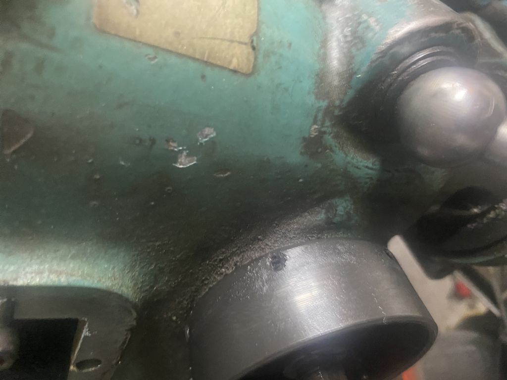

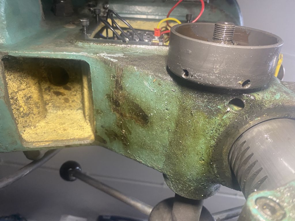

                        #619181
                        Mark Harris 1
                          @markharris1
                          #619182
                          Mark Harris 1
                            @markharris1
                            #619184
                            Ian Parkin
                              @ianparkin39383
                              Same machine mines just got another hole in the top

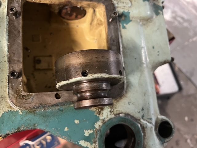

                              #619622
                              Ian Parkin
                                @ianparkin39383

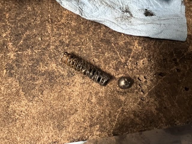

                                This is the spring housing removed from the body and the spring and ball

                                  Mine appears act as a one way clutch. Does yours do the same
                                  #619649
                                  Ian Parkin
                                    @ianparkin39383
                                    Yes as i said it only allows you to tighten the spring return action if you want to loosen it you push the ball off the housing and it will loosen it
