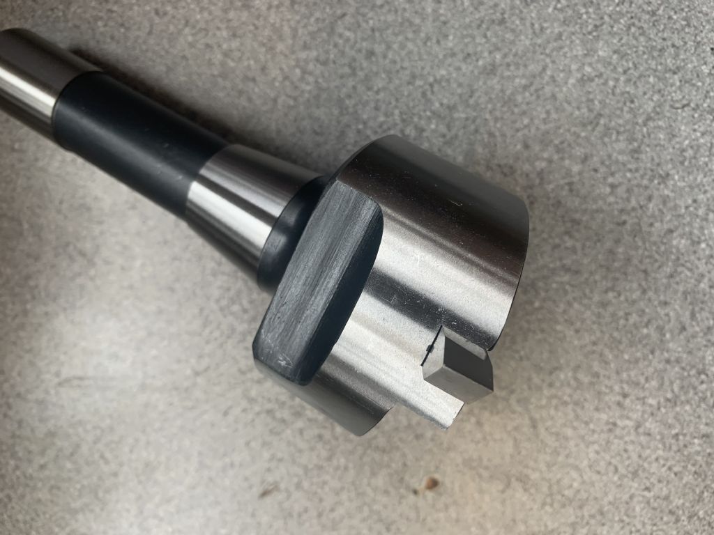

      Never used one before. Bought one from Arc and a cutting tool
      not sure which way the tool should be in the cutter
      this is how it is atm

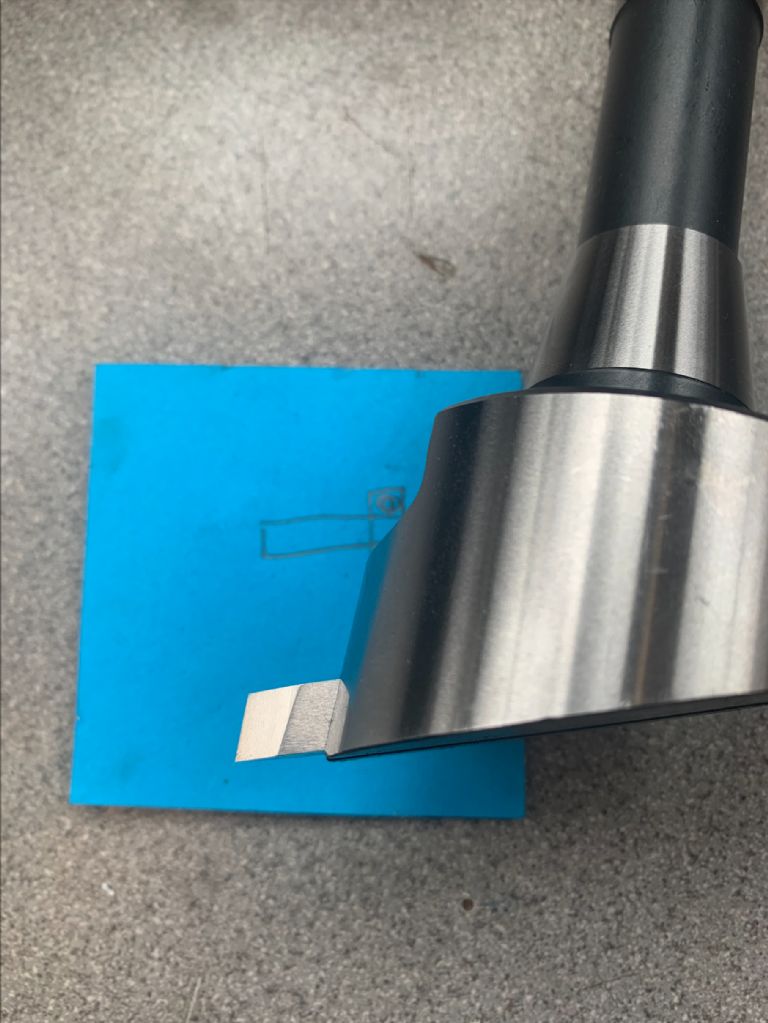

          Tool needs to be turned through 90 degrees.

            roatate it 90 degrees clockwise looking at your last image

                    I used to use them quite a lot mainly smaller ones but like the others now use indexable shell/face mills.
                    Remember you will need to run at quite a low rpm to suit the HSS at the diameter being swung and also a slow feed rate a sit is a single point tool.
                    Carbide can be run around 3 times faster and depending on how many insert fed 6 or so times faster. so a cut may only tale 1/18th the time it would with a flycutter. The FC does work out quite cheap though as you can sharpen the tool many times provided you don't go near chilled cast iron with it. Compromise is to put a left hand lathe tool into the flycutter so you can at least spin it faster and feed accordingly.

                              You set it up so the toolbit cuts just like a lathe tool, except in this case the tool is moving and the job is staying still. But the basic cutting action is the same.
