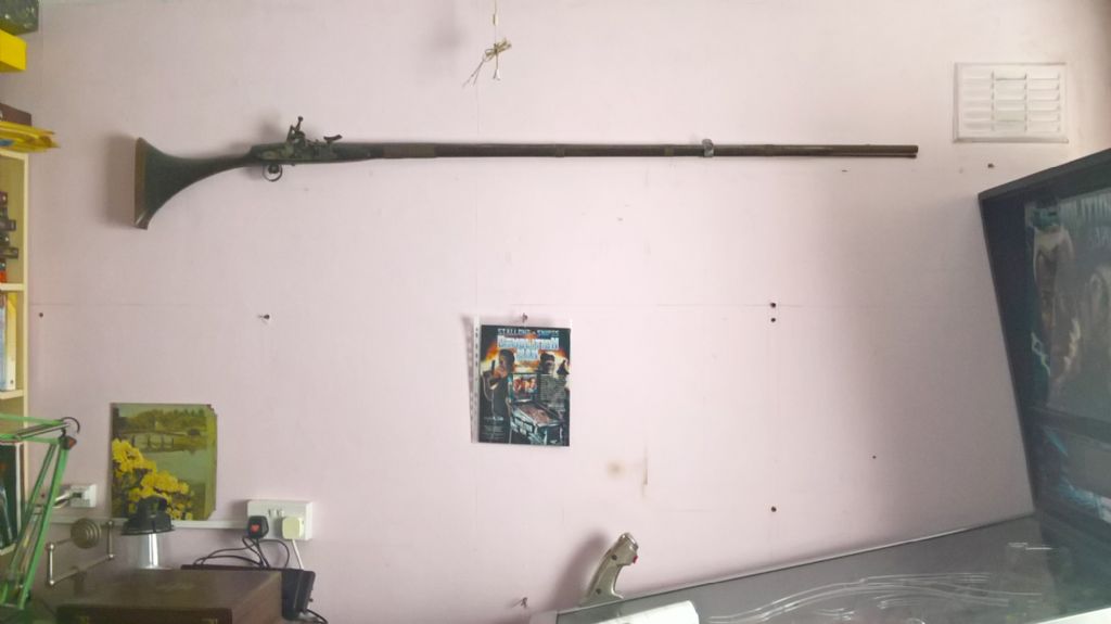

      I have started to make a copy of a flintlock pistol, the gun I have was a flintlock but many years ago they upgraded it to a percussion. The copy will be non firing, I can't bore the barrel anyway as its around 8 inches long.
      My question is ,when the days of battle using flintlocks how is it that after firing then reloading with gunpowder the powder does not ignite ,as there must be embers in the barrel after firing not only once but many times

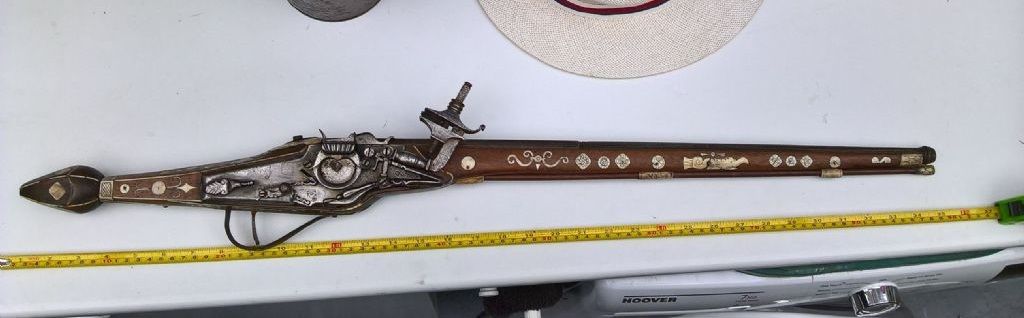

          I'm a vintage gun owner and have made several working replicas including a wheelock pistol which is posted on this forum somewhere.
          In answer to your question then we must presume that the small amount of powder in a pistol would leave embers no more than a few seconds. Cannons however were different and a charge as high as 16 Lbs was used in the British 68 pound cannon. A swabbing rod was quickly shoved in and out before the next charge went in and a wet sponge after about ten shots to cool the barrel

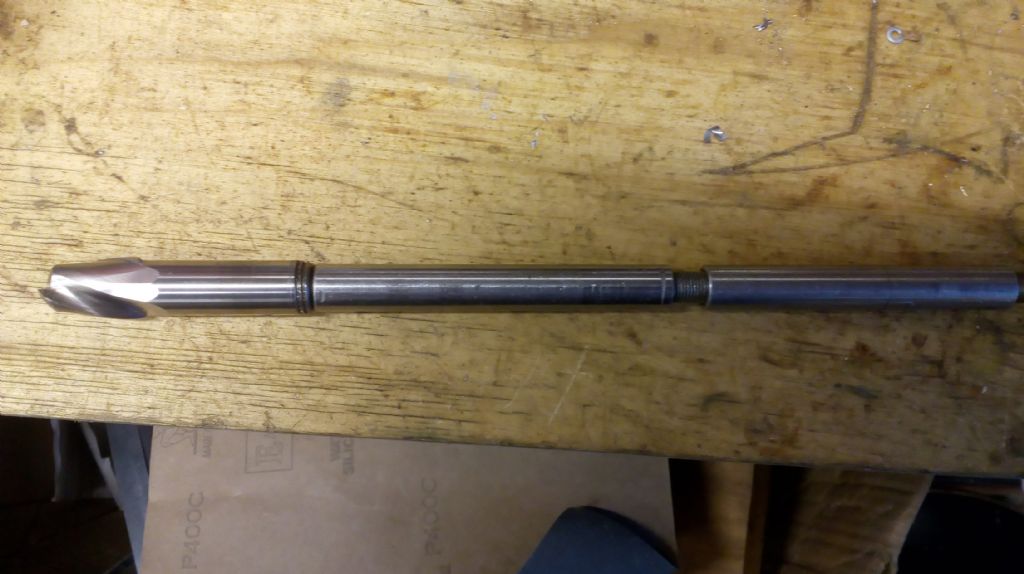

              It's not that difficult to make a bore that long – on my cannon I did it with a 9/16" slotdrill threaded on the shank to take 2 silver steel extensions:
              Came out straight enough to slide a stick of 9/16" silver steel down it, and only a couple of thou oversize at muzzle.
              My understanding is that it's the touch hole you better not drill through laugh.

                    For my Wheelock holster pistol barrel, (which is 2 feet long) I got hold of some 1" pipe with 1/2" bore which allowed considerable taper down to the muzzle as on the real thing
