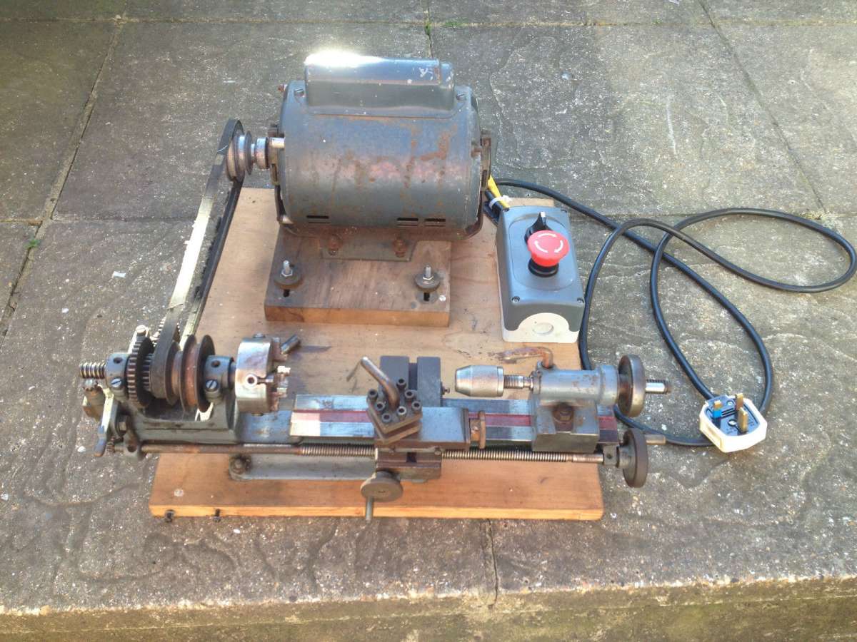

      Hi all,
      I’ve been given a lovely little Flexispeed Meteor 2 lathe (see pic). It’s in need of a bit of TLC as it is a bit rusty and dry, but the motor works in forward and reverse. It’s my first lathe and I am looking forward to using it.
      I wanted to ask if anyone has a digital or paper manual for it and any advice on cleaning is much appreciated.
      Thank you SandraIMG-20250122-WA0010

              Cleaning it, don’t be too aggressive, and don’t start by stripping it down completely!   The reason for not stripping first is incorrect assembly mistakes can be a pig to diagnose.
              Get the worst off with plastic kitchen scourers, tooth brush, maybe brass brush and WD40/paraffin.  Once cleanish apply plenty of lube and make sure everything that should moves freely.  Ask again if anything is seized, or there’s deep rusting.
              If the lathe runs, spend some time putting it through it’s paces by cutting metal.  This will reveal faults like nothing else – worn bearings, half-nuts, bed, gibs etc, broken/missing parts, knackered motor, bent lead-screw and other nuisances.  Also, if new to lathes, take time to get used to the machine – don’t rush it, there’s a lot to learn.
              You can dismantle simple stuff like the tailstock but approach anything else with caution.  Lathes aren’t exactly rocket science, but they do have gotchas!  Much safer to do a deep clean and paint job later after becoming familiar with the lathe.
              I don’t care if my lathe is grubby.  Matter of taste!

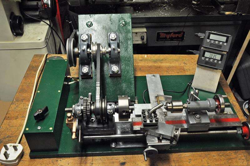

                  #780466
                  Roderick Jenkins
                    @roderickjenkins93242
                    Happy to see that Sandra’s lathe has a countershaft.  The spindle is soft and runs in cast iron.  As the instruction book says, the spindle speed should be kept to less than 1000rpm.
                    I purchased one:
                    ebay1
                    and did quite a bit of work on it including making a new spindle (the headstock itself was un-worn).  A gentleman over on MEM sent me the pdf manual.  One point to note is that the taper in the tailstock is the thin end of a Morse #0.
                    fin1
                    I sold it when I bought a Pultra.
                    Rod

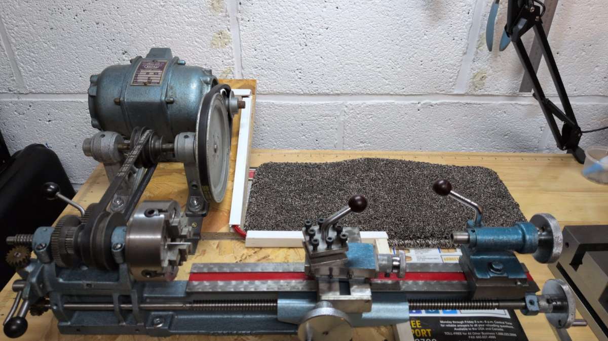

                                    #791947
                                    ferroequinologist
                                      @ferroequinologist
                                      Good morning all
                                      I have now cleaned the lathe and it is half back together. Now I am in need of two new belts. The manual states I need M-type ones. I have measured the old ones. One has an inner diameter of 51cm , 10mm width and 8mm thick. The other one has 57cm inner diameter, 10mm width and 8mm depth. i looked online and my head is spinning of all the types available. SPZ, SPA,SPB etc..
                                      Has anyone with a Flexispeed meteor 2 any recommendations please?

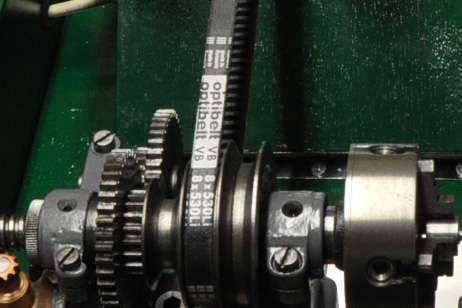

                                      #791966
                                      Roderick Jenkins
                                        I used an Optibelt on mine.  Although only 8mm wide it nestled nicely in the groove without bottoming and the cogging helps on the relatively close centre distance and small diameters of the pulleys.  There is a 10mm width option which might be more suitable for your Meteor 2, mine was a slightly earlier version although I suspect the pulleys are the same.
                                        Simply Bearings Optibelt
                                        optibelt
                                        HTH,
                                        Rod
                                        #792048
                                        ferroequinologist
                                          @ferroequinologist
                                          Thank you Rod, much appreciated. Yes, I had 10mm belts on mine, the motor manufacturer date is 1968 and it seems the original.
                                          #832493
                                          ferroequinologist
                                            @ferroequinologist
                                            Good morning all
                                            I thought I put an update to the thread here  I opened last year . My Flexispeed is finally finished and I have used it without the tailstock just to have a practice with it cutting some scrap metal and found her very nice to use. As she came without any tailstock tooling I’m in the process of modifying some ready made available MT0 arbors to take a chuck and make a centre. Here a couple of pictures. The lathe has a bit of vibration and I’m currently figuring out why. Today, I will try to figure out if it’s the motor, new belts or set up .
                                            Thanks again for all your help in guiding me along.
                                            Kind regards SandraIMG-20260108-WA0006IMG-20260108-WA0007
