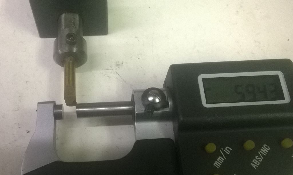

              Sorry to disagree, but I don't see how the boring bar will produce a flat bottom, unless the bar and cutting edge is half the finished diameter of the hole, or less without the outer edge of the bar contacting the "far side"of the 0.6" hole. That is 0.3 ". The insert boring bar in the photo looks far wider than that to me. I would venture to suggest that using an end mill will give the best result and even then the bottom of the hole will be slightly convex due to the nature of the grind. That probably won't matter a great deal and I doubt it will be seen, either. I won't tell, if you don't.
              I have a small Sandvik boring cutter which is about 6mm across the end which might just do the job without the cutter contacting the opposite side of the hole..
              sandvik boring bar
              Not a very good photo, I'm afraid. The micrometer reads 5.943 mm. This would do the boring and produce a flat bottomed hole as well. I would drill to 10mm, the tip of the drill to required depth, then use the boring cutter to finish the hole to size and form the flat bottom at the same time.
              Edit: Jason posted while I went out to take the photo!!

                Doc has said there is a 5/16" through hole so tool only needs to move inwards 0.144 from finished dia. Front to back of tool looks about 3/8" so 0.375 + 0.144 = 0.515 so back of tool will not hit the far side of the hole.

                    I missed the bit about the through hole, Jason. Must remember to engage eyes before typing!
                        Edited By John Hinkley on 17/03/2021 16:22:06
                        I've got a couple of those Sandvik tools, and a holder (Coroturn XS CXS-A10-05). The inserts for it have a chamfered end – I could have sworn mine were for internal threading. Perhaps they are, but you can get also boring bar inserts for them. I wonder what the difference is? Do you happen to know what catalogue # your small Sandvik boring bar is?

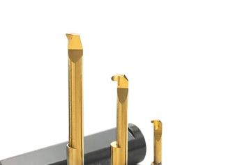

                          I can't find the original listing as I purchased the boring tool a number of years ago, but this, from the Cormorant range has the same tip shape.
                          Sandvik boring tools
                          The one on the left is the same profile as mine and will produce a flat-bottomed hole.
