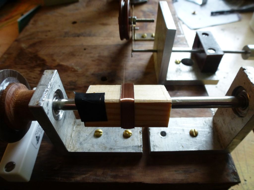

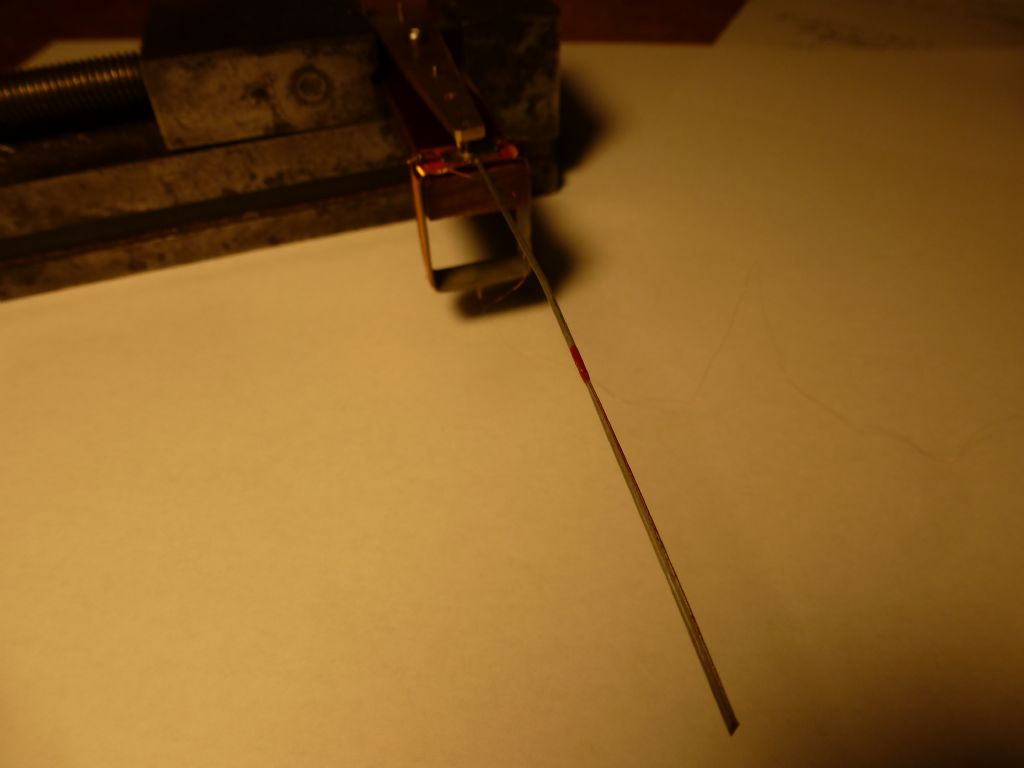

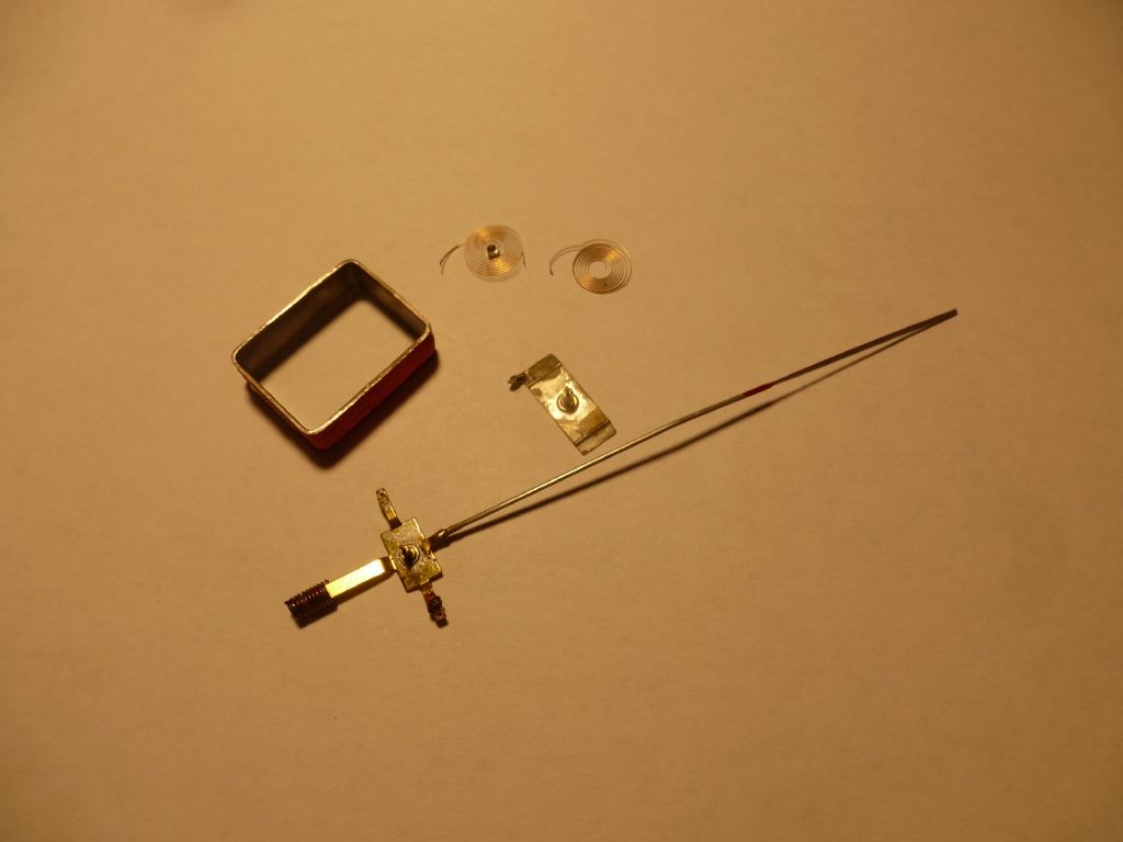

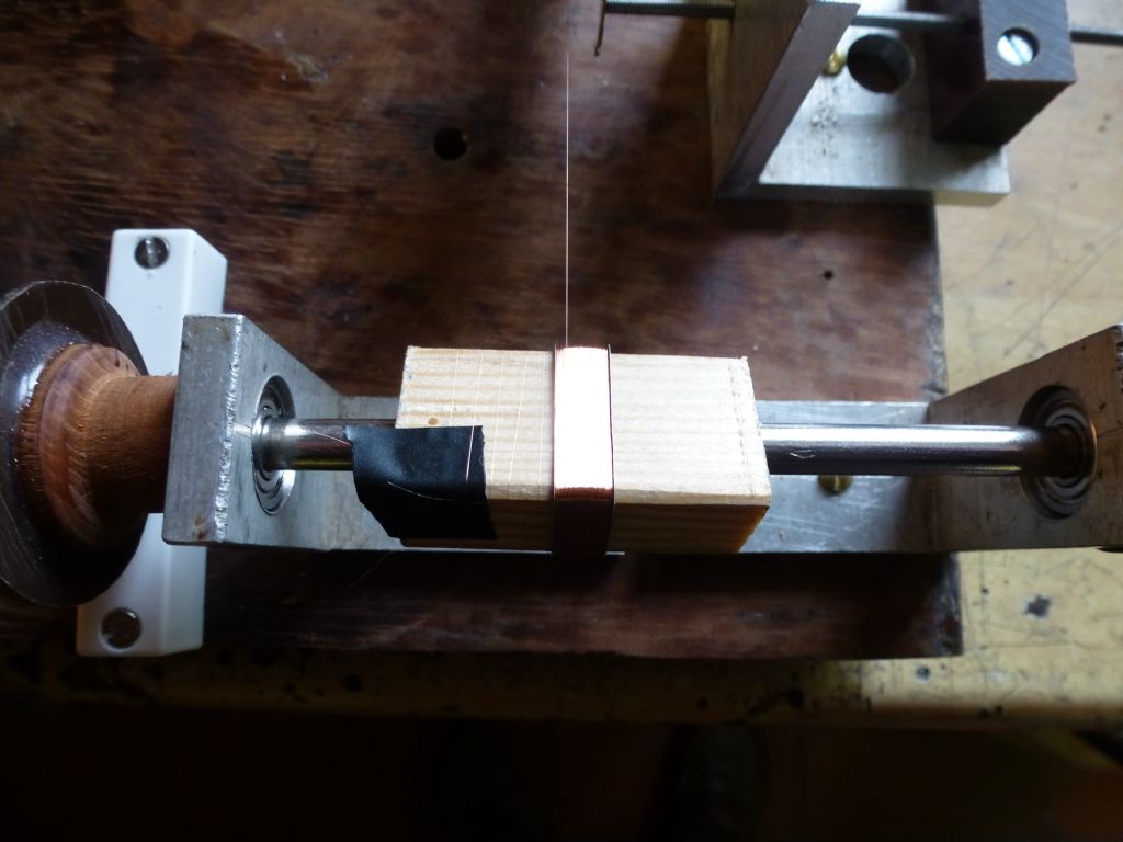

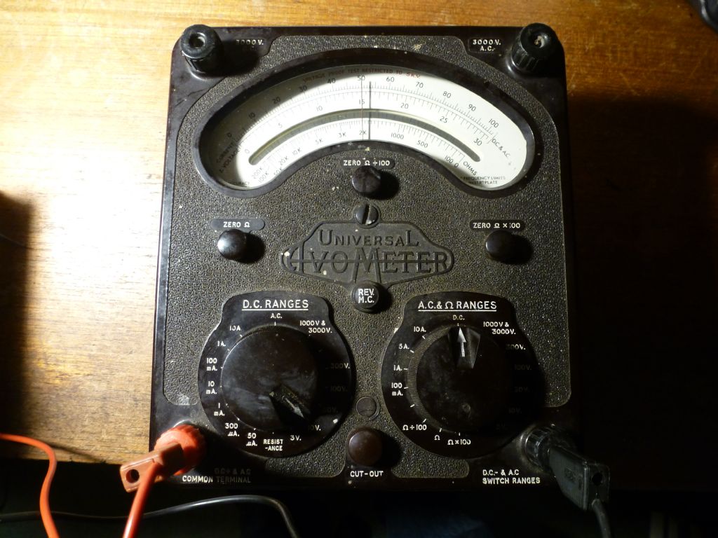

          p1040337.jpgAfter deciding to press on and rewind my AVO coil (see last posting) I took the coil apart and stripped off the wire and measured. Then built very simple coil winder for 50swg wire (a bit fine). Put on 1200 turns from calculated value plus 10%. Then made jig to re-glue bearing pivot plates and re-assembled. Disappointed to find read about 25%. Didn't fancy winding again so fitted some bigger neodymium magnets plus a bit of jiggy-pokery with shunts and swamp resistors. Now reads correctly. Was it worth it – no, cheaper and easier to visit eBay. But I've started so I'll finish…… Sorry about order of photos, not got the hang of that.p1040339.jpgp1040336.jpgp1040335.jpgp1040333.jpg

                Thanks for the responses. I looked at VintageRadio, very handy info. The bottom line is that I used 50 SWG wire which is 0.001 dia and requires 78,750mm for 2608 ohms resistance. This leads to 1078 turns approx. This IMHO turned out to be too few for the magnet block. Ampere-turns is what sets the sensitivity.
                Had I used 49 SWG .0012 dia and requires 113,550 mm for 2608 ohms which leads to 1554 turns approx I would probably had the right result. But being a bit dim, although the wire sample I measured did measure a bit over 0.001 I took the extra to be the enamel. That 0.0002 makes a lot of difference – cunning chaps those AVO people.
