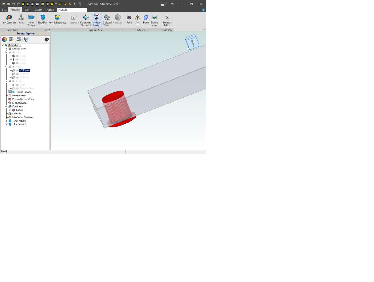

                  What goes into the M12 stud or bolt? You could simply thread to a common M16 and make a stepped stud, M16 to go into the new hole and M12 protruding.

                      On my mill when I fitted a 3 phase motor I re-used a cast iron pulley which had a large hole.  I made a steel bush a good fit in the hole and bored for the 5/8 motor shaft and loctited it in the hole using the strong stuff.  This on the advice of John Stevenson.  It has held up under repeated starts over several years.  So bore out the hole as large as you can, and make a steel bush with threaded hole, top hat as suggested, and use high strength loctite.  Don’t aim for a great finish on the external diameter, it’ll help it stick.

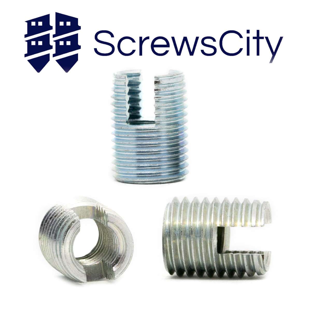

                                        Danni Burns
                                          @danniburns84841
                                          Helicoil is not suitable for a thread under constant use. If being nipped up and left, then OK, but it’s for a vice on a saw.
                                          Pete/Noel – I do appreciate the offer and would have tried it – but I’m in North West.
                                          The Time-Sert looks the quick ‘n’good solution but the cost is prohibitive, given that taps/tool are also required.
                                          I found/ordered a couple of these self-tapping inserts – as they are low-cost and obviously avoid the cost of a large tap that I may never use again.
                                          self tap s-l1600
                                          Just out of interest really, I will try it out in a lump of scrap first – see if the self-tapping aspect is reliable. I’d be interested in what the Helicoil users think of these.
                                          If I’m not 100% I will buy a large tap/die and go with the (belt and braces approach) headed threaded bush and Loctite in place. I see that an M16 tap/die set is the cheapest approx £15.
                                          cheers
                                          #693129
                                          noel shelley
                                            @noelshelley55608
                                            Are you sure there for use in metal ? I have seen something like this but only for wood ? Noel.
                                            #693132
                                            Danni Burns
                                              @danniburns84841
                                              Hi Noel
                                              High quality Inserts made of Case Hardened Steel and to AN 335 standards.
                                              Here is the eBay item number:253838305966
                                              It says:
                                              Application:
                                              – Light alloys
                                              – Cast iron
                                              – Brass
                                              – Plastics
                                              – Laminates
                                              – Hardwoods
