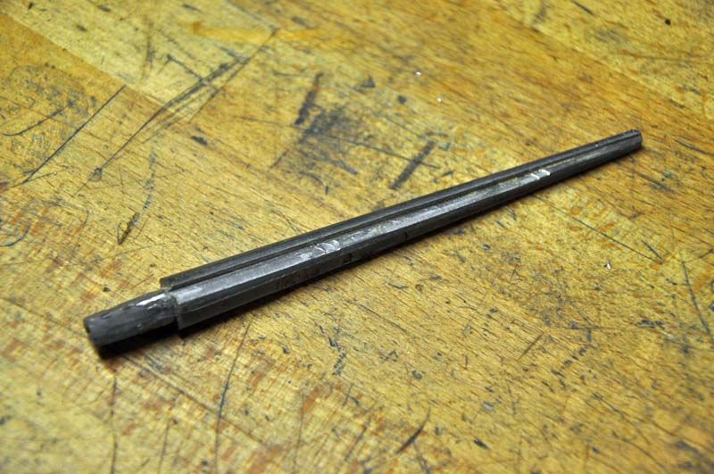

      The usual tools are a reamer and a 'pencil sharpener' that come in for about $130 the pair..The reamer has broad flutes so it cuts wood gently, the incl;uded angle is given as 2 degrees, or a taper of 1 in 30.
      My thought is a silver steel to copy the reamer, and make a d-bit style reamer at the same setting. use this to make a giant pencil sharpener with a gauge plate blade.

              I made the tapered reamer from silver steel and milled 3 flutes on half the circumference, leaving the other half plain. I didn't harden to avoid distortion. Experience suggests that one flute will do and that cutting the wood is best achieved by creating a burr on the cutting edge like you would when sharpening a cabinet makers scraper.

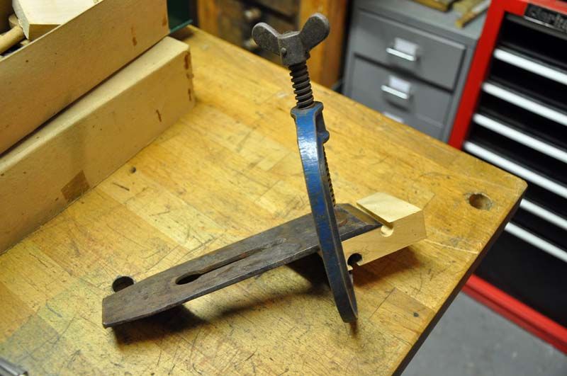

              The "pencil sharpener" was made by reaming a hole across a plank of wood and then planing this down until a narrow parallel slot is revealed. The blade from a hand plane can then be fastened to the plank, bevel up, with a G clamp so that it is tangential to the peg.

                Here's a couple of photos:
                The reamer – not my best work, one of the first things I made after getting my old Zyto many years ago but it works very well to this day
                This is the sharpening arrangement, the hole having ben reamed with the horror above
                Rod

                  That'[s smashing Rod, I'll have a go at doing it your way.
