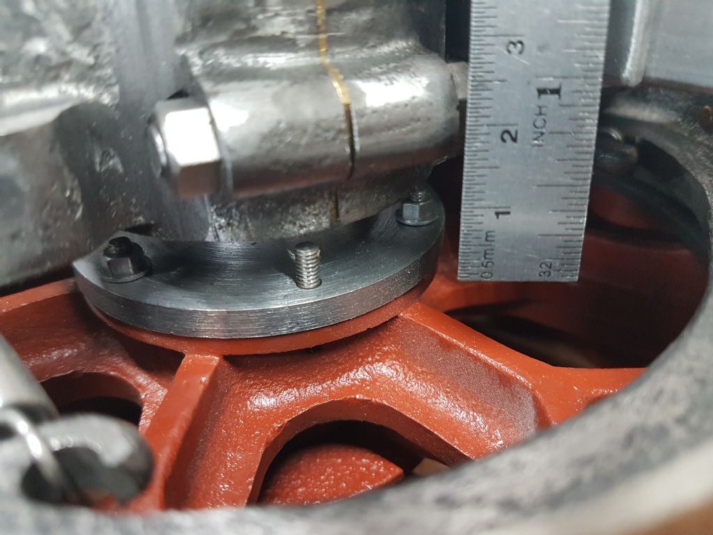

      As part of the model I am building there are some nuts on to studs where I can not get my fingers in, the space means I can get pliers/tweezers in from one side, but not a nut spinner/socket from the end. Has anyone got a suggestion of an easy way to fit nuts in this type of space? Currently I am holding the nut in pliers, trying to put it on the end and turning 1/4 turn before I run out of room and hope it turns enough to engage the thread.

                                  I have no taken a picture of the studs.
                                  I can get a spanner on to finish tightening the nuts, it is getting the nuts started on the stud starting that is the issue. I like the idea from Maurice, I think I will see if I can get that to work in this space, I probably won't get a chance to try for a few weeks but will try and remember to let you know how I get on.

                                    It would help too if you loosen off the other nuts and raise the whole flange up to maximise the space above the nut you are trying to put on. Then when all nuts have been put on their studs, drop the flange down and finish tightening all.

                                      That stud looks suspiciously over-long. If out of sight, one could remove some thread at the end of that stud as a lead-in – and as Hopper states, put that fixing on first and leave the easy ones until later.’ Or even maybe altering the order of fitting the parts together?

                                        Posted by not done it yet on 14/06/2018 06:08:42:
                                        That stud looks suspiciously over-long. If out of sight, one could remove some thread at the end of that stud as a lead-in …
                                        +1
                                        In fact, I would say all those studs look too long.

                                          Unfortunately I the order of assembly does mean that access is limited, the axle box holds the brakes and both fit in the wheel so the wheel goes on last.
                                          I have left 2-3 threads showing as that is the rule-of-thumb I have been taught, I could remove the top thread for a lead-in which may make it easier to get the nuts started, next time I have the wheels off I will look to get the studs out of the wheels.

                                            Hi Baldric, One and a half threads out of the nut should be enough. One thing with the studs the way they are at the moment, even if a nut comes loose, it won't fall off, if that was a worry they could be lock wired.

                                              You could gain a bit more wiggle room by not tightening the other nuts and leaving a gap between the painted part and your flange. Once all the nuts are started on the studs push the parts together and wind the nuts right down. That is what I had to do where the cylinder flange joins the crankcase on this engine plus make thin nuts.
