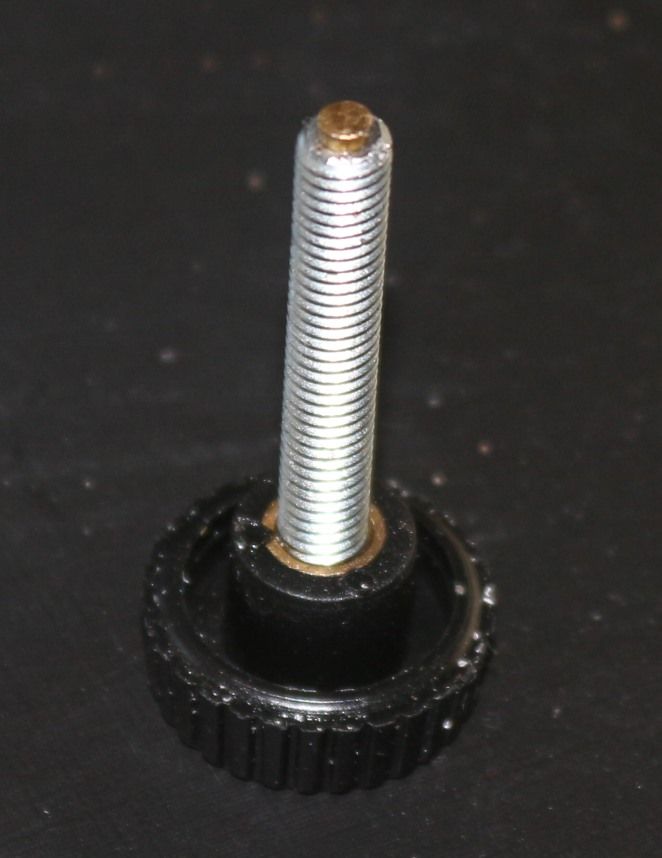

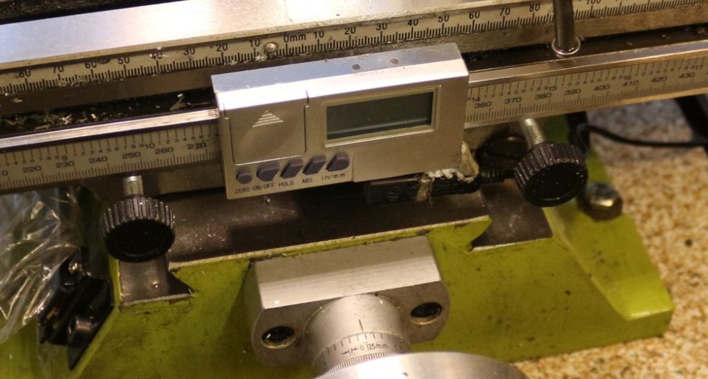

                              Bob – I used a cylindrical diamond burr approx. 3mm dia. and used it in "drilling mode" until I had gone in around 6-7mm deep. I took it reasonably steady to preserve the burr (and the mini drill) and eventually it did the trick and allowed the drill (Dormer HSS) to get a bite. Once the drill had reached the bottom of my excavation it was able to drill down deeper to the correct depth without a problem.>>
                              I also tried a masonry drill which was a waste of time, even experimenting with re-grinding the tip geometry had no effect on the casting.>>
                              I got over the problem of the table locking nuts fouling the scale by discarding them and replacing with my own version.
                              >>table clamp 1.jpg>>
                              I drilled out the tip of the studding and Loctited a brass slug in so as not to damage the ways.
                              >>table clamp2.jpg>>

                                  I did a similar mod to Rik on my Myford VMB mill to keep the scale on the front of the table and still be able to lock the table. I too thought of fitting the scale at the back of the table but prefered not to lose Y axis travel.

                                    I'm not willing to compromise on Y-axis travel (I'm surprised that anyone would actually). Frequently I want more than I have. So I mounted my (glass, with separate DRO) scales at the front. I extended the gib-screws out past the scale in the same way that Rik shows above so I didn't lose the use of those.
                                    What I have lost is the ability to mount the limit-switch box for my X-axis power feed in its intended location. I haven't figured out a suitable alternative so I run that "open-loop" (is there a smiley for "…gulp! " )
