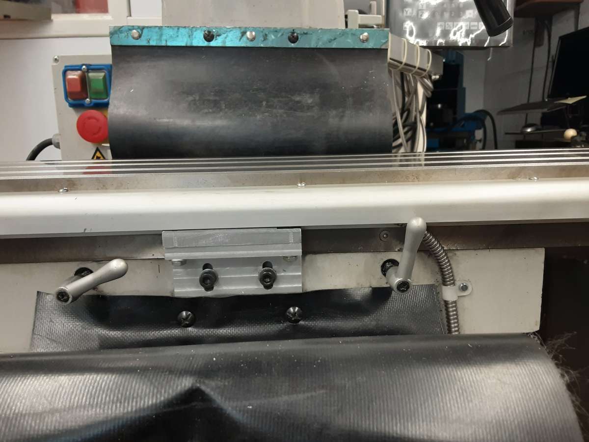

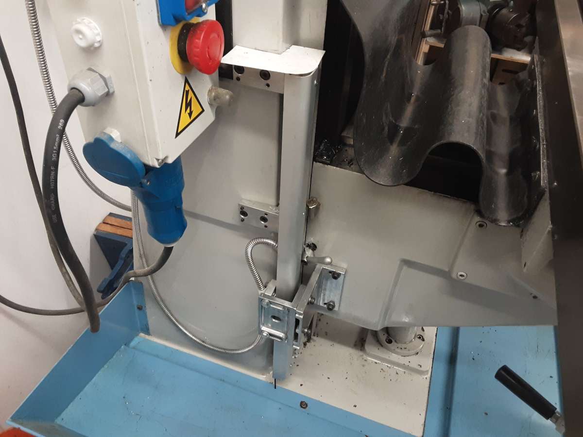

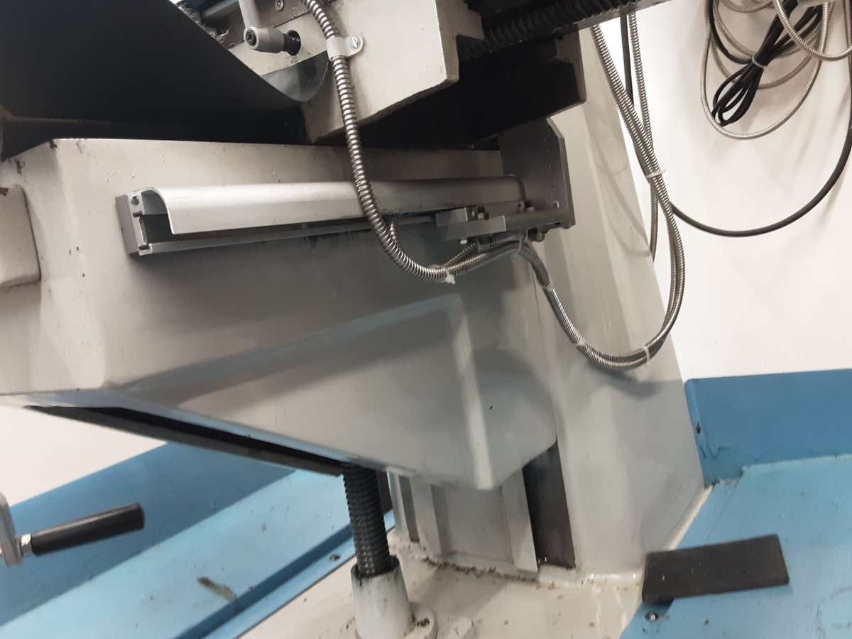

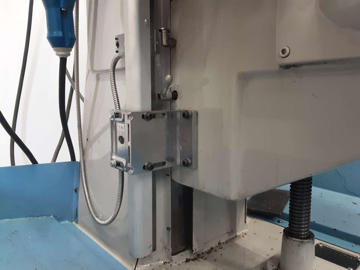

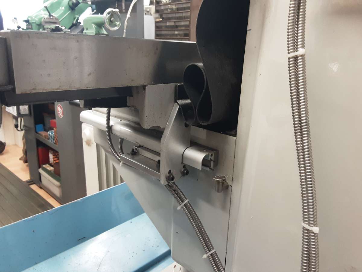

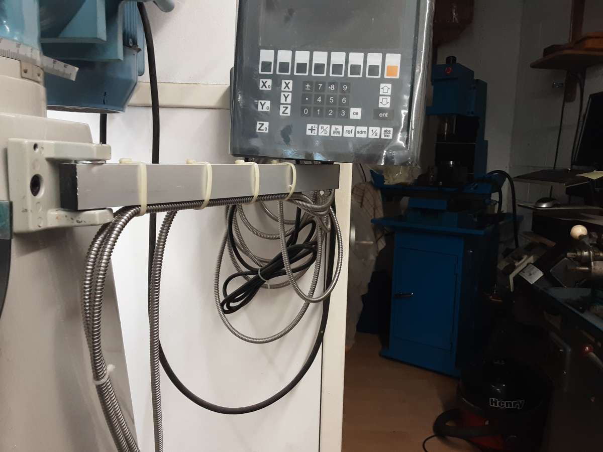

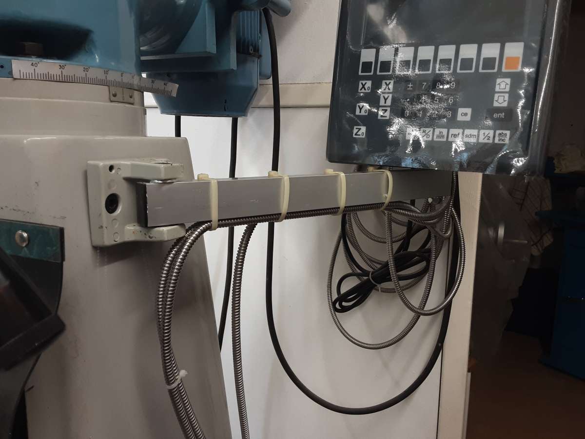

            20250425_14353520250425_14360220250425_14352420250425_14350820250425_14343720250425_14342620250425_143412Hi Martyn
            A few pictures of how I fitted DRO to my VME milling machine.
            Steve P

              Steve’s photographs show similarly to my “Machine-DRO” installation on a Myford VMC – though his is neater – and gives you the basic methods.
              I don’t know the VME but these machines were designed before DROs appeared, so a fair amount of ingenuity is called for to fit the scales to all those tapered shapes.
              On mine….
              The scales do need be truly parallel to the travel. I achieved this on the knee (vertical) travel by aligning the scale with a big angle-box bolted to the table, and verifying the setting with a DTI.
              The vertical scale is on stout aluminium angle (50 X 50 X 6mm I think) screwed to the column via spacers. A shield fabricated from 3mm PVC sheet protects the scale.
              The cross-travel scale is on similar angle screwed to the underside of the overhanging end of the cross-table.
              My system uses magnetic encoders. By chance, an expired, plastic association-membership card happened to be the correct thickness to provide a strip as a non-magnetic, non-scratching feeler-gauge for setting the gap between the encoder and scale.
              You need decide whether to keep the long-travel (“X”) table stops. I removed mine to use their T-slot to hold the DRO scale and its shield, and wish I had found some other way that would have kept them. Some would argue that with a DRO you don’t need the stops and I see their point, but as I prefer to make my machine-tools more versatile by adding parts,  not simply replacing them, I have pondered alternative end-stop designs. (A round-tuit task…)

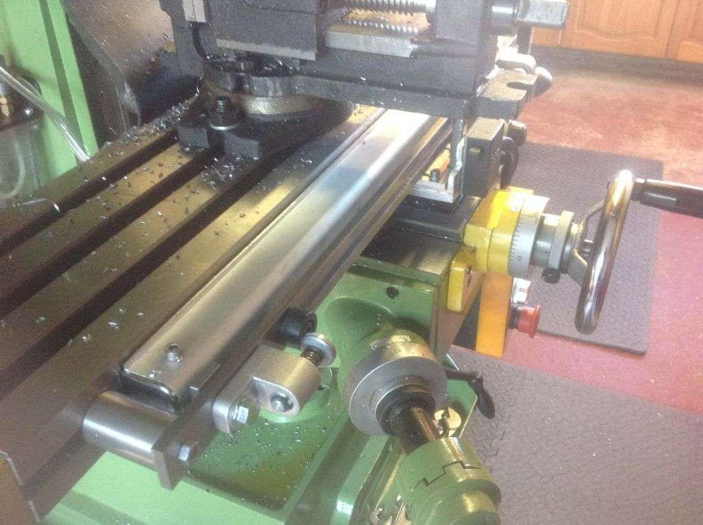

                  For what it’s worth, when I fitted the 3-axis DRO system to my Warco VMC mill, I decided to re-instate the table stops by fitting a slotted strip on stand-offs from the front of the mill table, like this:
                  626731
                  This arrangement also allowed the x-axis power feed stops to be mounted on the same plate. It wasn’t long however, before I found that neither were being used, so it was removed and has languished on a shelf in the workshop for 5+ years.
                  Nigel’s round tuit list is longer than mine!
                  I think I’ve still got the slotted strip somewhere in the workshop.
