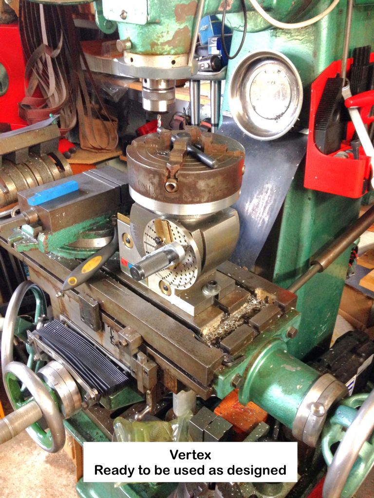

        Soon had the backplates for the lathe chucks mounted and registers done, then time for the Vertex dividing head ones and they had to have a 12tpi thread to fit spindle.
        No way was I forking out for Myford chucks/backplates, so procured a 4" 3-jaw Pratt plus a 6" 4-jaw Bernerd.
        This meant doing some screwcutting in the lathe for the first time believe it or not, as I've been able to get away with using taps and dies till now, and quite frankly funking the very thought to boot.

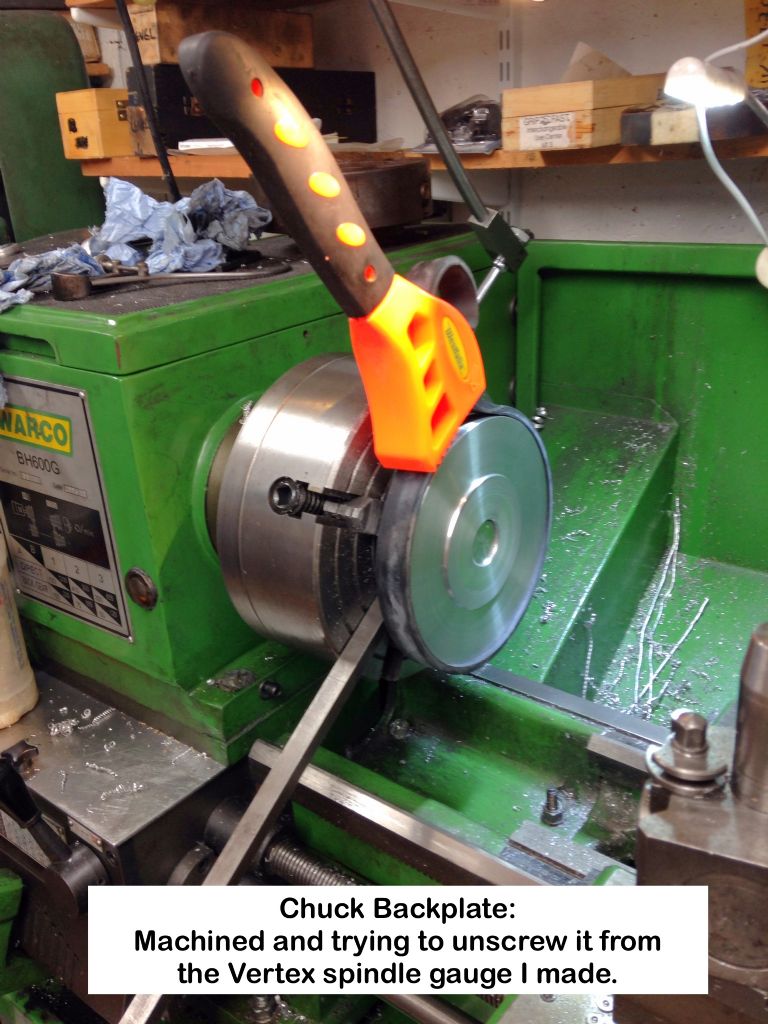

          Fun and games ensued checking the diagrams printed on the side cover of the lathe as to what change wheels where needed and where, then finding that NONE where marked with number of teeth, so had to count and stamp each one.
          Chucked a piece of aluminium to test, and then problems as I just could not get 12tpi, the closest being 11.5tpi!
          The usual wtf but after an hour of checking the positions of the feed and gearbox levers and finding them in their correct slots, plus change gears, went to have a bite to eat and coffee to calm down
          Back to the lathe and I just could not believe what I saw!
          As plain as possible the diagram on the gearbox showed two 40 tooth gears where needed and for some inexplicable reason I had fitted one 32tooth.
          What relief when that was rectified and the thread gge confirmed 12tpi!
          Measured the Vertex spindle nose and cut the thread in the aluminium rod to size to use as a gge for the backplates, and very pleased and somewhat surprised at how easy it was.
          I remember thinking to myself "Is it this easygoing!"
          Aluminium, so MS no doubt not the same.
          First go at screwthreading
          Replaced the 3-jaw with the large 8" 4-jaw and used thick aluminium plate for the two backplates, machining the centre holes then cutting the internal threads using the Jog facility, and leaving the Half-nuts engaged, just reversing the lathe using the 'Jog' facility again that the VFD control has.
          Took a little fine fiddling with Top-slide feed to get the threaded plug gge to screw into the plates all the way, but again pretty pleased, after being not a little apprehensive in the past about screwcutting in the lathe.

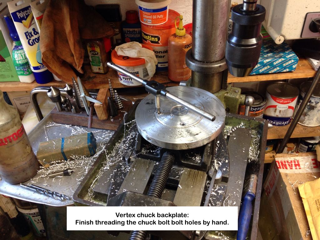

          Blind holes a totally different matter.
          Chuck backplate
          Chuck backplate,ate
          Chuck backplate
          Next problem was how to trepan the centres out.
          Easy said I, mount the aluminium on the dividing head, onto the Marlow and use a small dia end mill.
          After three passes I cried enough and time to use the lathe to trepanne the centres out.
          Found the toolbit I used to trepan the thick plastic from 'Oompa Lumpa' to make holders for Angle Eye lamps I made to fit round the spindles of the the Mitco and Marlow, and soon had both done.
          https://youtu.be/eXFRk-fUI_8
          Chuck mounting holes drilled and tapped.

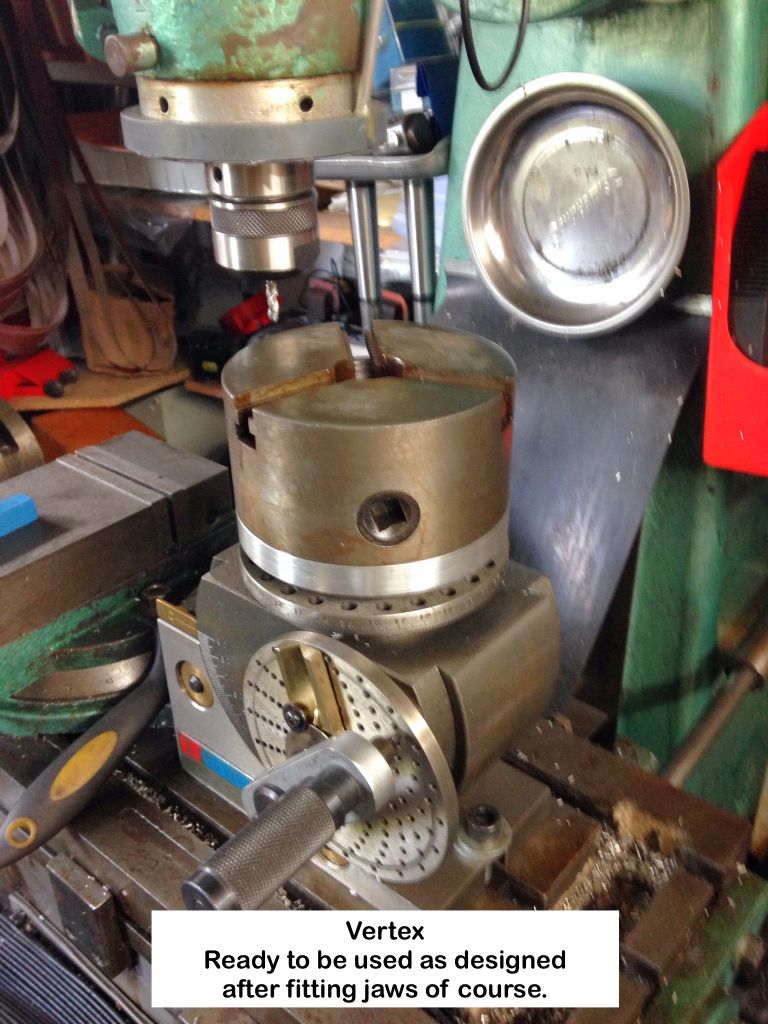

          Chucks mounted on the Vertex.
