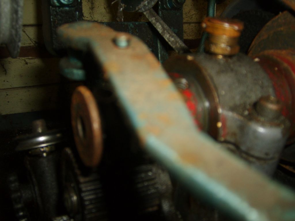

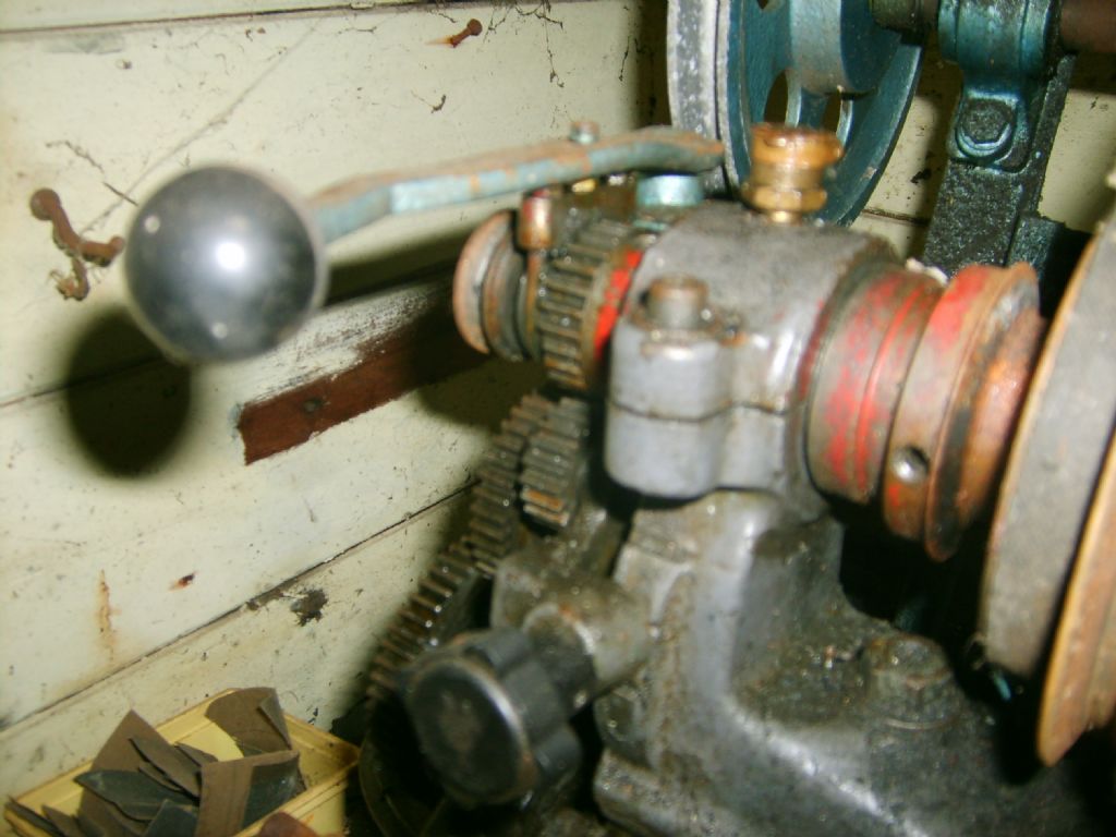

                                single tooth clutch 2Hello, some 50 years ago I obtained my first lathe, a secondhand Myford ML4. This machine suffered all the well known failings of the marque.
                                Screwcutting at that time, was a buttock clenching experience with any thread not a multiple of the leadscrew thread count of 8TPI, and no leadscrew thread dial .
                                I became aware of the single tooth mandrel clutch, this promised a great easing of the screwcutting experience, so one was made and fitted. All imperial threadcutting became a breeze.
                                I attach a photo of the ML4 headstock for anyone interested.I will now start anew thread under the heading 100 years on, concerning screwcutting.
                                paul.single tooth clutch 1
