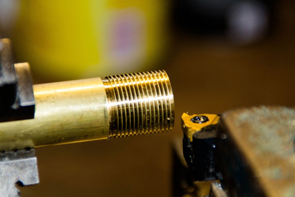

      hi fellas cut my first thread on my lathe today after getting my cutters sorted what do you think its 20 tpi same as gun barrel I am pleased to bits I managed to do it set gears as the chart said over the moon never used a lathe before

                                my first thread on lathe never done it before do you think it looks ok scrap bit of brass

                                  Looks good to me, better than my first attempt 😀

                                    one problem I had was the cutter the tip was small and had trouble using the fish tail is there another way to set it up so its straight ?
                                        If it's an accurate holder teh tip should be aligned with the shank, just use a square between the work and the side of the holder.

                                          With the cutter you are using, and assuming the end of the bar is squarely faced, move the tool in front of the bar(lathe stopped), and square the two against each other, no fishtail or square needed, takes about 10 seconds.
                                          My recommendation is use HSS, learn to grind your own.

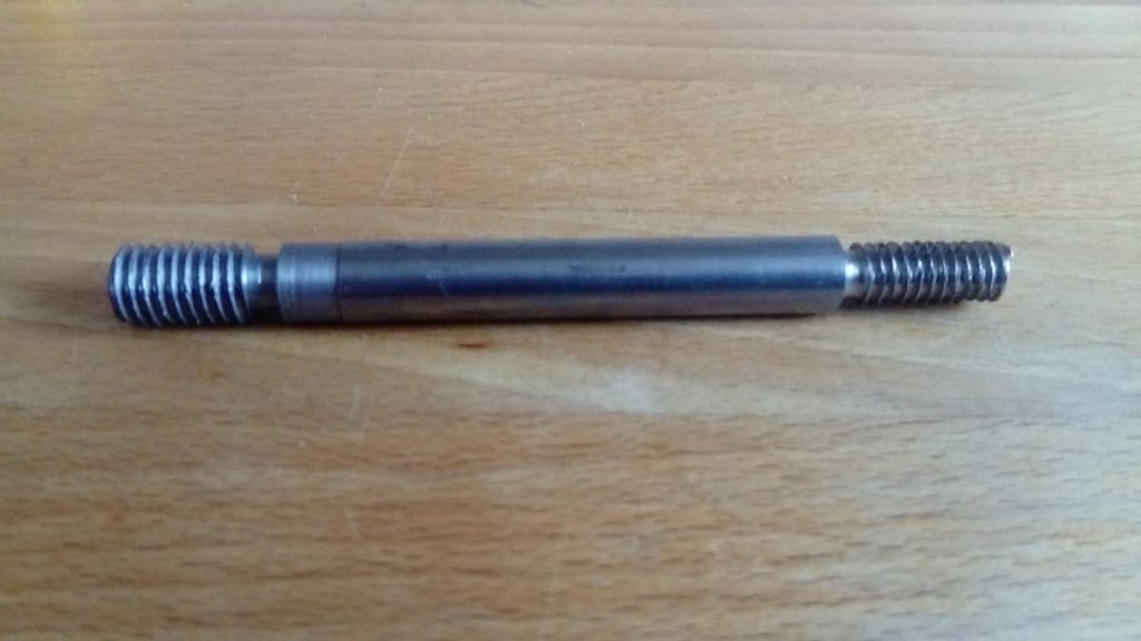

                                                this was my first attempt, the smaller side is 8mm diameter with a thread, the other end is 10mm diameter with almost a 1.5mm pitch, its actually 16TPI which comes out at 1.588mm pitch, so the M10 nut will only go on by a few threads

                                                  You don't need the expensive metric conversion set. Didn't check which thread Neil linked but for the Myford there is a thread showing details for metric conversion (approximations) that only uses one small gear change so very much cheaper. JS makes the gear so possibly sells it through ARC. Read the whole thread and follow the later link by JohnF.
                                                  If you are not using the angled topslide method (lets not go into arguing about that) when you are using an approximation and the nut is tight just put in a small extra cut with the topside moved along a few thou and you will get clearance. Yes a tad weaker thread but in non stressed parts it's ok.
