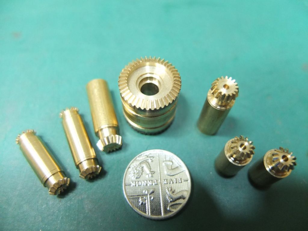

      After what seemed like an age acquiring cutters and making arbors, a centering micrometer and other bits I finally got round to cutting some gears.
      They are Mod 0.3 bevel gears, and spares, for a differential I’m making.
      They still need parting and cleaning up.
      There are 6 x 12 tooth mitre gears, and 2 x 40 tooth crown wheels with matching 16 tooth pinions.

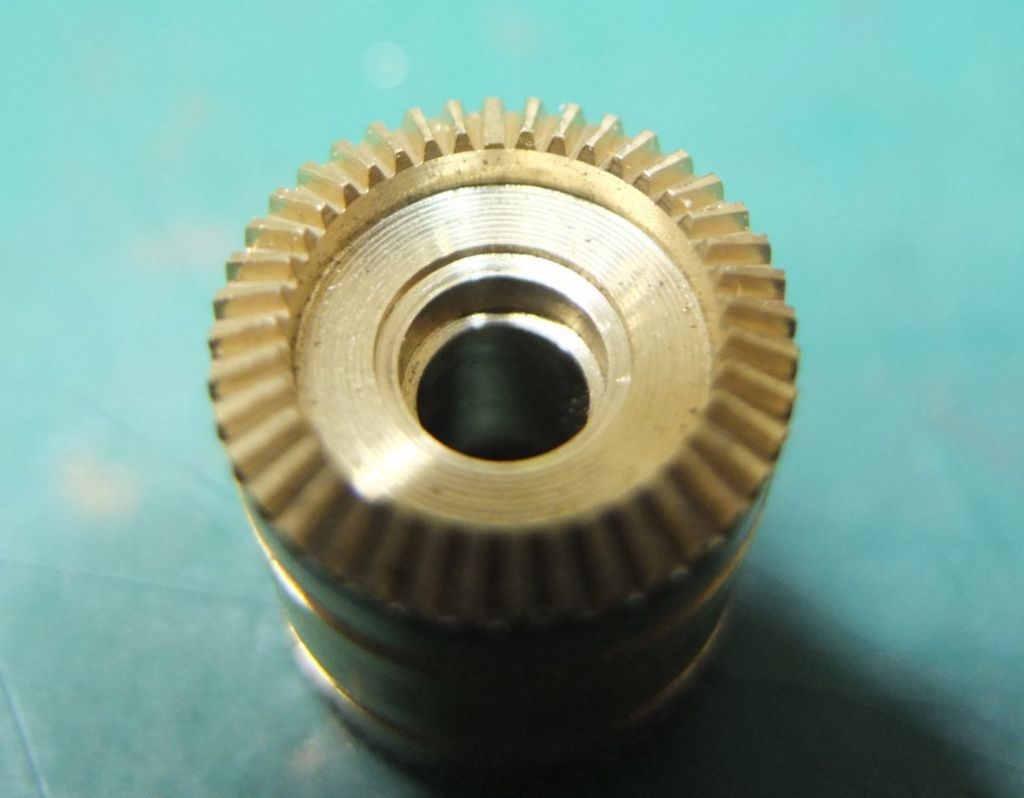

      It wasn’t entirely a success though. I lost the top of one tooth after turning the rotary table before I’d retracted the tool enough (back centre on photo). Stupid error but that’s why I made spares.
      I used the parallel depth method from the Ivan Law book and everything was straightforward once I’d got my head around the maths.
      A lengthy process though. The 10 gears I made needed a total of 552 separate cuts. (Each tooth gap is cut 3 times). This is my excuse for making the error – a mixture of tiredness and complacency.
      They look fine under magnification and seem to mesh well (even the bit with the half tooth).
      I will report back when they are finished and assembled.

          They look good Steve. What a shame about the half tooth after all the work that went in to it. I look forward to seeing the assembly.

            Nicely done Steve I didn't realise how small they were until I got a five pence piece out of my pocket!

              Fine work! Yes – pity about the damaged one, but that's why one makes spares. It's done in industry too.

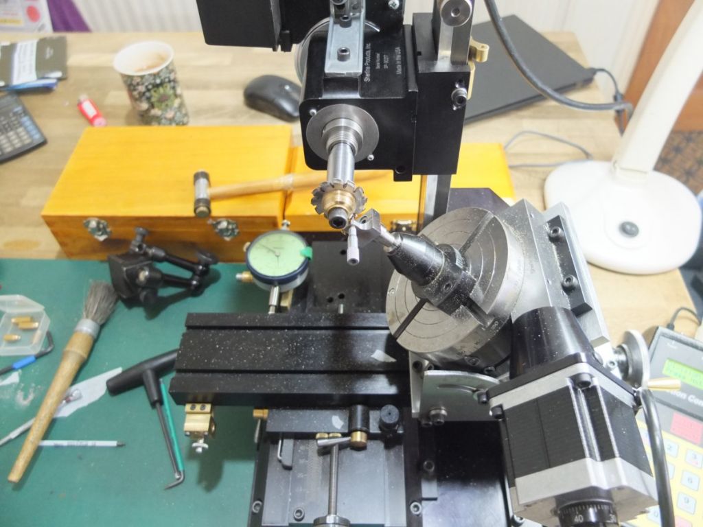

                    Did you take any shots of the set up Steve?
                    #516385
                    Steve Crow
                      @stevecrow46066

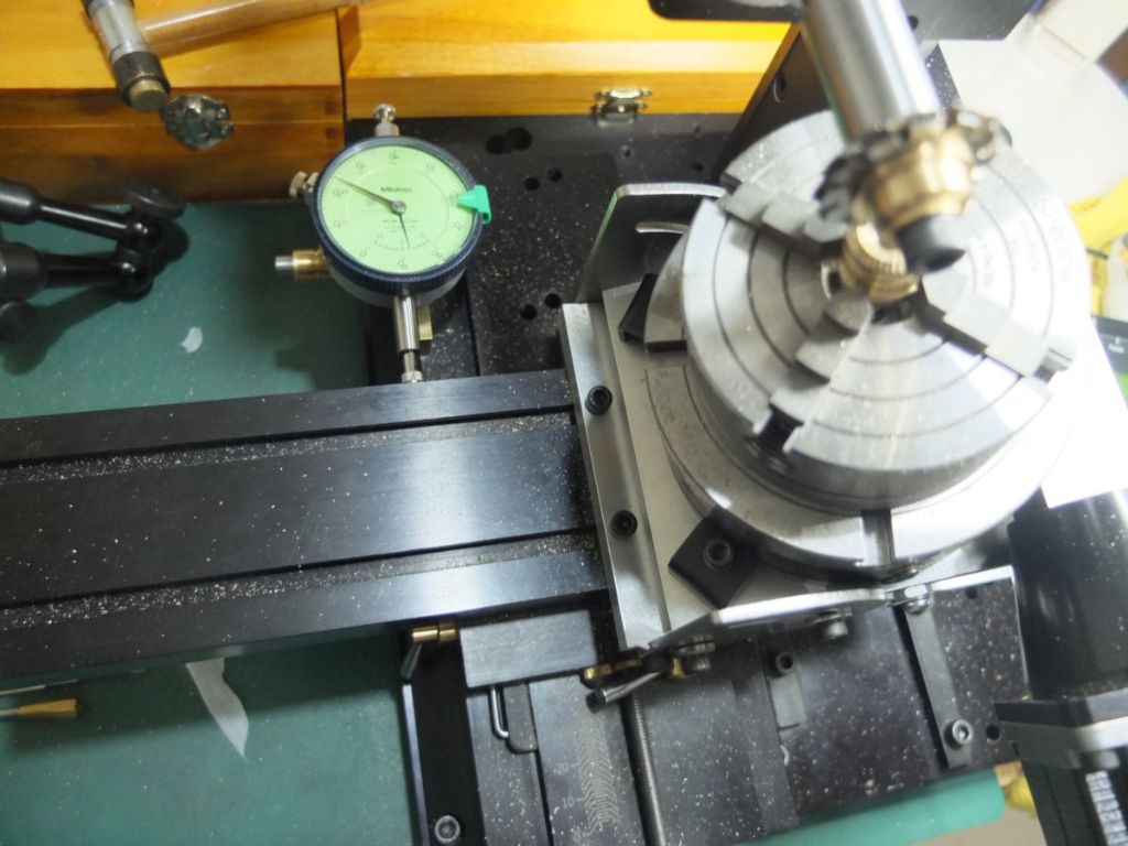

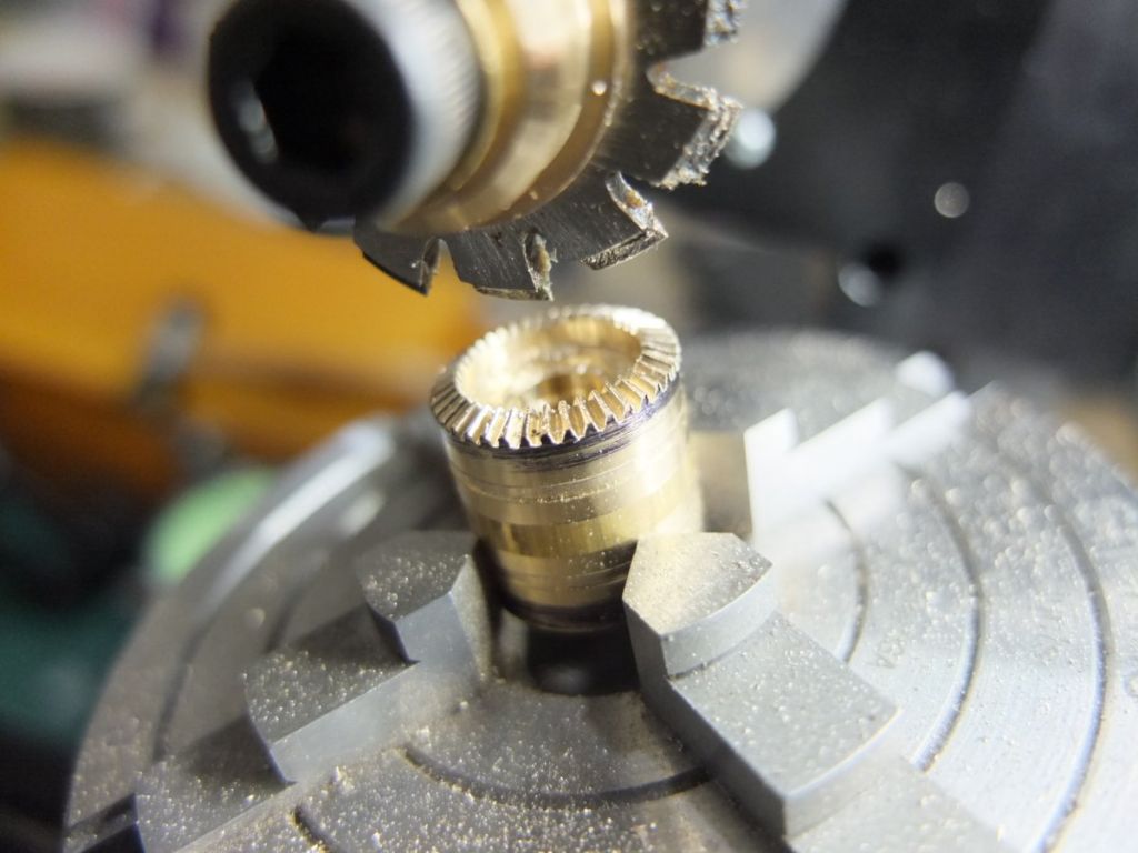

                      I didn't take many photos of the set up – I always forget to.
                      Here is one showing the micrometer for centering the cutter.
                      And a couple from cutting the crownwheel.
                      Steve

                        Wow Steve, that is the machine for the job.

                            It took about 4 hours to set up.
                            I thought the only chance I had of doing these correctly was to have everything square and spot-on.
                            First I had rebuild the mill in horizontal configuration, something I hadn't done before. Then everything needed to be clocked on each axis before tightening. Then the angle plate had to be clocked square and the 8mm collet adaptor dead centred on the rotary table with a DTI.
                            Hours of tapping with a little rubber hammer.
                            After all that, when I went to centre my cutter I found out that the arbor was 5mm too short! (the angle plate screws fouled the column). So I had to remove the painstakingly clocked headstock, put it back on my lathe, set it over for morse taper turning (more clocking) and make a new, longer arbor.
                            This set me back the best part of a day so I didn't have much time to do the cutting as I had to give the kitchen table back!
                            In the end, I did all the cutting in one long session. It took about 6 hours including roll-ups, tea and sandwiches. That still works out one cut every 39 seconds.
                            As suggested by Nigel above, I would have liked to split it up over a couple of days but it wasn't possible.
                            I was getting quite tired by the end of it, hence the error.
                                I used my travel stops to tell me when I'd gone far enough to move the cut safely when doing my bull gear ring.
                                #516539
                                Steve Crow
                                  @stevecrow46066
                                  Posted by Dave Halford on 31/12/2020 14:51:23:
                                  Dave, just after I finished cutting I realised I could have done that. Lesson learned.
