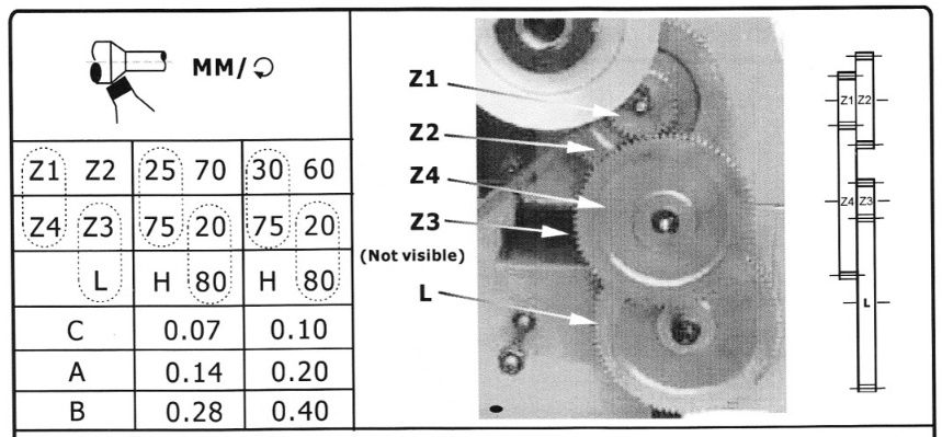

      I have a Warco 250 MV. Changing the change wheels for different threads can be a hassle & whatever set of wheels one selects gives one the feed speed on the leadscrew & the cross slide. Too high & the cutter goes too fast giving a poor finish, Too slow & it is time consuming, especially facing cuts
      As I do not do much thread cutting it would seem sensible to set the speed at a suitable speed for feeding the tools along the material when doing general machining. In addition I have a fairly ridgid set up for the cutters so my parting is rarely a problem. However winding the cutter in & out by hand is a pain & an even feed works better
      I also find the constant meshing of the gears noisy & different ratios can be a little quieter, but because I have not found a nice "optimum" I tend to feed everything by hand
      So I was wondering what set of wheels most users of the 250MV use if not thread ciutting but just want to travers or face cut. As for tools, i use tipped & HSS but I like Brazed carbide. However I am told father Xmas will be delivering a pair of diamond tool holders so that could be the tool of the future. The parting blade is an eclipse tapered 13mm deep HSS
      Any comments please

                  Like Jason, I usually leave my WM250 set with the finest feed gears in place. To avoid too much noise from the gear train use a sheet of paper between the gears when setting up, as per the manual. I find that liberal application of grease helps to reduce rattle, also make sure that the right washers are used to prevent the sides of the gears rubbing.

                      With the gears set for the slowest speed I find that the slow C and medium A lever positions give me two suitable speeds for finishing and roughing when turning along the lathe. The B and A positions give roughing and finishing for facing. I prefer to run a fast spindle speed with lighter cuts to a deeper cuts you get there at the same time either way.
                      So 0.0025" per rev finish turning, 0.005" per rev roughing turning and 0.0015" finish facing, 0.003 rough facing
                      this would be in the region of 200tpi rough turning and 333tpi rough facing
                      If you find that too slow then just use the next feed ratio up or the next one from that.

                          Posted by Sam Longley 1 on 04/11/2021 18:17:42:
                          So how do I equate that to TPI, which is what I need to know what change wheels to use? Metric lathe.
                          Feeds are not usually measured in TPI. If yours is a metric machine it will be in mm/rev. The table from the manual should make it clear:
                          This for the WM250 but should be similar to your later machine.

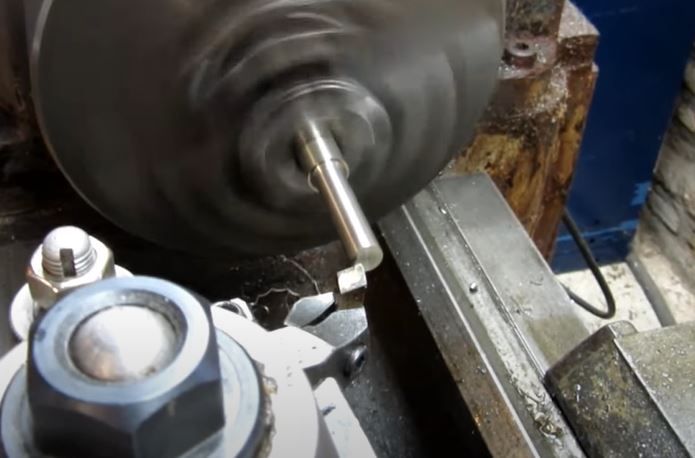

                                            I would not dispute what you say. However, i am confused. This video at 22.45 suggests something different. Further in the operator takes some ridiculously large cuts later on & a silly 1500 RPM as a test. . Obviously one would not do this, but it does disprove one's comment somewhat.regarding the tool itself.  I am aware that some you tube videos can mislead. But it is a big cut at 1000 RPM. At one point the cut is almost half as wide as the piece of steel
                                            So the cutter will take whatever  I throw at it. It stands to reason that if the lathe can cut it with a brazed tip then it must be able to cut it with a diamond tool holder & i should  not notice a slow down in speed.  Or is that different?

                                              Revs is only half of the equation, Its around the top end of what I would expect for a bit of 1/2" bar, I'd probably be at 100sfm compared to his 130sfm. But at the same diameter you could be at 100meters per min surface speed
                                              Its when you come to turning larger diameter work that things have to change. take a piece of 100mm or 4" dia he would need to be turning that at 130rpm or 6" at 85rpm which is where the vari speed machines start to loose out so a shallower DOC or finer feed has to be used .
                                              He is turning that bar with a feed of 0.006"/rev, In my reply yesterday I said I use 0.005" yet you say mine is "hardly moving" and his is fast? yet I'm only feeding at 20% less than him. Just because the spindle is turning fast it does not mean a high feed rate is being used.

                                                  Sorry to spoil your Christmas but what you see on Youtube can also confuse and get your hopes up. Anyone else spotted it yetquestion
                                                  The video Sam linked to shows a guy using a tangental tool holder with a 1/4" sq bit a sit is the 5/8" shank one. This is a screen shot from the video of him about to start a 0.200" depth of cut so one would expect the tool to be overlapping the end of the work by say 75% allowing for the angled grind making the 0.250" edge of the tool look a bit longer.
                                                  What he is actually doing is taking a depth of cut of 0.100" or a total of 0.200" off diameter, no wonder his 5HP machine is happy with it. Fair to assume all his other DOC figures are half what he says.
                                                  So Sam don't get too excited as he is actually taking off half the amount he says. Nothing wrong with the Diamond tool just understand what it is doing and what you machine can do. What's the saying "don't believe the hype"wink 2
