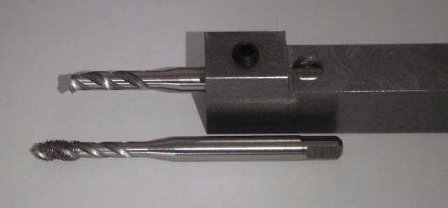

                                  Jup. Finaly a partial success of having less than 0.02 mm throw on short FC3 business end.
                                  I didn’t want to skim OD, so I was limited to booring. Made a nominally 6 mm booring bar out of M6 thread tap, shank OD is 6 mm, shaft arounf 5 mm and it was broken, only three teeths left to save a lot of grinding. Made a booring bar holder for it and gave last finish with a diamond lap. Worked out fine.
                                  Probably will make one OD 12 mm holder with bottom hole just to practice. I don’t feel proficent yet.
                                  I know that one tooth of threading tap is not ideal, because of the 60 decree from, but on the positive side, the tooth has almost all the right angles. I could have groud half a teeth further to introduce more traditional form, but this small tap has very small teeth and regrounding the whole would have been a lot of extra work.
                                  Extra lazy bit on this one was to bolt the holder in place and step drill with the lathe chuck to 6 mm shank size. I can almost guarantee centered hole and correct edge height with tap/booring bar!
                                  Went fine into 5,8 mm hole, but needed careful aligment, high RPM and SLOW feed.

                                    You can measure .004mm of wobble on a 3mm cutter? Or is that a typo? Even the .02mm in the later post sounds pretty small. Or was it 0.2mm, which would be about 8 thou.
                                    I too have a boring bar made out of a very expensive gun tap!

                                      This 0.004 mm was a typo. I would have been overly happy with that and it’s also pretty hard to measure accurately these magnitudes. The correct figure was 0.04 mm of “throw” on 6 mm shank cutter at 15 mm away from the adapter face. I was making a holder for 6 mm shank, 3 mm short FC3 cutter. I was expecting it to get even worse when in use, because the hole was a little bell-shape, a litlle too big, a little inclined and off-centre!
                                      0,02 mm woble was after few experiment later and I’m happy with it, the hole is of proper size, hardly can push most of the FC3s in. I made a hole trough to allow brass drift to push FC3 out if they get stuck. The hole  looks pretty straight and close to centre.
                                      What size is your tap booring bar? How do you use it? I used this to take overly small cuts. My finishing cuts were in order of 0,02 mm and there was a noticeable spring on return, althoug it seem to cut on return stroke as well.
                                      Tried to make another adapter and I was hurrying up – I botched it right there. The hole for FC3 came out too big! Should have learnt by now.

                                            My tap boring bar is made out of a 6mm tap that “just came apart in my hand”. It broke near the bottom of the cutting section, leaving a piece that stuck out on one side that suggested a boring bar to me. So I ground away what I had to and now have a cute little boring tool that will go into a hole about 4mm diameter. It is really useful for those tiny bits that need to be concentric, although I have never tried to measure the runout I get, I just know it is lots better than a drill will give after it has wandered about.
