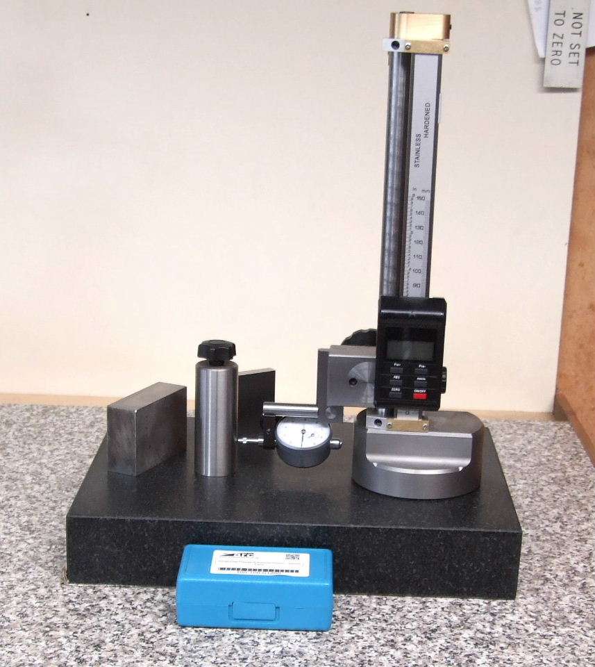

                        Having had FB-2’s for well over 40 years setting the column to the vertical in this plane is not going to be easy.
                        A good known to be true Engineers square can be used, but a Cylindrical square is a much better proposition. A DTI or “Clock” needs to be traversed up the side of the “square” using the Z-Axis until zero-zero is achieved top and bottom. The Z-axis adjustment needs to be good and I would advise locking the Slider before taking any reading.
                        If you are not sure of the squares accuracy use it one way and then the other. Splitting the difference, it is a real pain but the only alternative to a good cylinder square.
                        Perpendicularity Check
                        The square in the photograph was turned between centres truly parallel and faced on the recessed end at one setting. It is shown checking another item I made for checking perpendicularity. Be warned most Height gauges cannot do this.
                        That is it in a nut-shell.

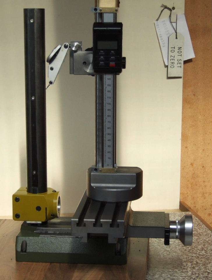

                        Tramming the head only makes the head square to the table. The Column could be out of plumb by several degrees and this will not affect Tramming the head. What the out of plumb will effect is that as the head is raised vertically any hole located at a lower setting will not be in the same place horizontally in the X-Axis.
                        Checking Proxxon Column
                        Using the same tool to check my Proxxon Mill.
                        I hope this helps.

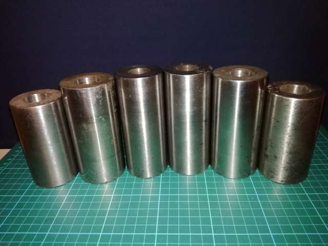

                                        For anyone looking for a cylindrical square, very often the gudgeon pin from an I C engine, one with floating gudgeon pins, will have ends square to the OD.
                                        One from an engine of about 12 litres or more should be adequate.
                                        Howard
                                        #788127
                                        Nicholas Farr
                                          @nicholasfarr14254
                                          Hi Howard Lewis, I have one or two, which I have used a few times.
                                          Gudgeon Pins
                                          The tallest two in the middle are 120mm high X 50mm in diameter.
                                          Regards Nick.
