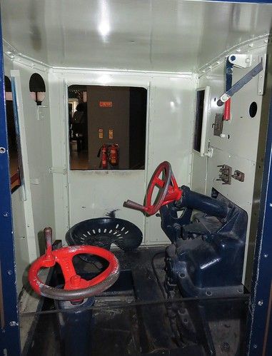

      2) For the life of me I can't find any photos of the cab and their controls. It's more out of interest than anything, I won't be modelling anything along these lines, but I would like to see a photo of the details. Does anyone have any photos of the controls or know where I could see some?

          The Guinness brewery tramway in Dublin used F.C. Hibberd Planet locos, but only of 1ft 10" gauge.
          This is a picture of the inside of the cab of the one in the Guinness Museum, if it is any help.

            Superb, thank you Nick
