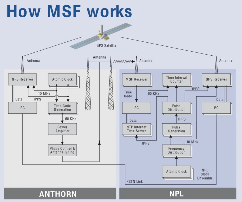

  • #632169
      Tinkerers might find this of interest:
      **LINK**
      http://www.roevalley.com/newsbrowser/v-projects/MSF_clock/v-rugby.htm
      Edit: __ alternatively : https://www.amazon.co.uk/60kHz-Atomic-Clock-Radio-Receiver/dp/B01KH3VEGS
      Edited By Michael Gilligan on 05/02/2023 22:42:19

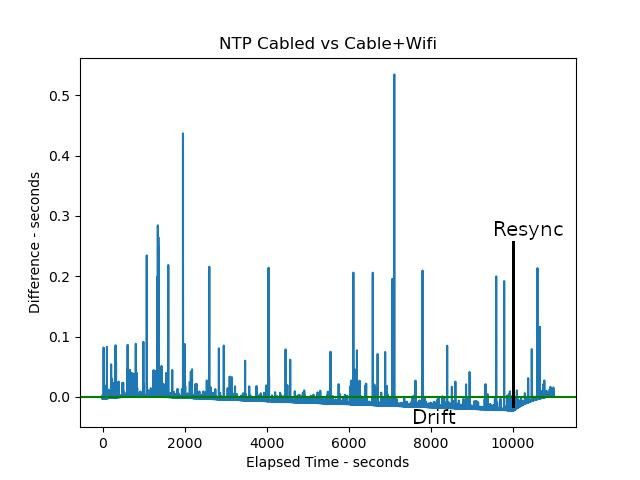

      #632170
        Posted by John Haine on 05/02/2023 14:51:47:
        Dave, don't despair, those errors could be in part due to NTP wandering at your location…
        **LINK**
        I thought that worth investigating and set up a server program on a raspberryPi3B that responds to network requests by returning the Pi's NTP time.
        The Pi is connected by Wifi to my router.
        I wrote a client for my workstation that asks the Pi for NTP time every second, and timestamps the reply. The workstation is directly connected to the router with a cable, so is one layer closer to atomic time than the Pi.
        The log looks like this:
        Pi Time___________ Workstation Time____ Difference
        1675617302.9517045 1675617302.9547412 -0.0030367374420166016
        1675617303.9578679 1675617303.9608333 -0.0029654502868652344
        1675617304.9659832 1675617304.9672174 -0.001234292984008789
        In the example, the two NTP times differ by about 3 milliseconds, but the graph shows wilder excursions and that the Pi and Workstation clocks drift apart, until a correction occurs (marked Resync):
        Mean difference between the two NTP sources is -4.15mS, including network delay of about +5mS. But the clocks are quite noisy, at one point over half a second apart, and they drift slowly apart until one or both resynchronises with an NTP server on the internet. So NTP is good, mostly almost always considerably better than 100mS, but far from perfect. A good chunk of the errors are likely due to both computers multi-processing, causing delays if either happens to be busy doing something else.
        Anyway, it appears John is right. Very likely some of my troubles may are caused by NTP and the Linux computers I'm using – neither is real-time. I did say at the outset that NTP was good on average, but not sub-second reliable.
          Hence my interest in NPL’s 60kHz carrier frequency … which [at least whilst it’s active] is very reliable
          … possibly [depending how you look at your ‘uncertainties’] the nearest thing to real time that most of us will ever see.

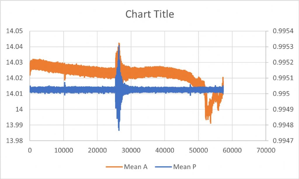

                              Dave, were you logging from your clock overnight? Fortuitously I completed my logging setup yesterday and set it off about 18.20 last night, stopping it about 10.30 this morning as there were some changes I knew were needed. I got a couple of emails today from Tom in the US asking if I'd detected the Turkey earthquake so I had a quick look at the data and saw this:
                              Left axis is amplitude (mm), righthand axis period (s). At the moment the main sensor isn't quite centred so alternate periods are slightly different, and this affects the amplitude measurement as well. That's why there's all the "fuzz" on both plots. You can see the big burst of transients at a time which corresponds to the quake (which was at 01.17 UTC I believe). My clock is a seismometer as well! Would be interesting to see if you detected this too?
                              #632307
                                Posted by John Haine on 06/02/2023 17:10:36:
                                Yes it was running, but I see nothing like your result in my log, maybe just a hint:
                                X=0 on the graph is 2023-02-06 01:16:49 and 200 is 2023-02-06 01:19:34
                                My pendulum is vibration sensitive, but I've not seen much sign of it since moving the clock to a solid window sill.
                                I wonder if the direction of swing makes a difference? Mine is aligned about 100° off true North.

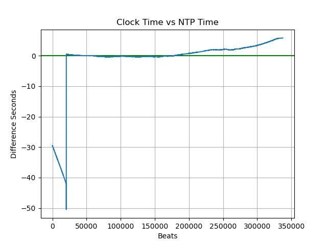

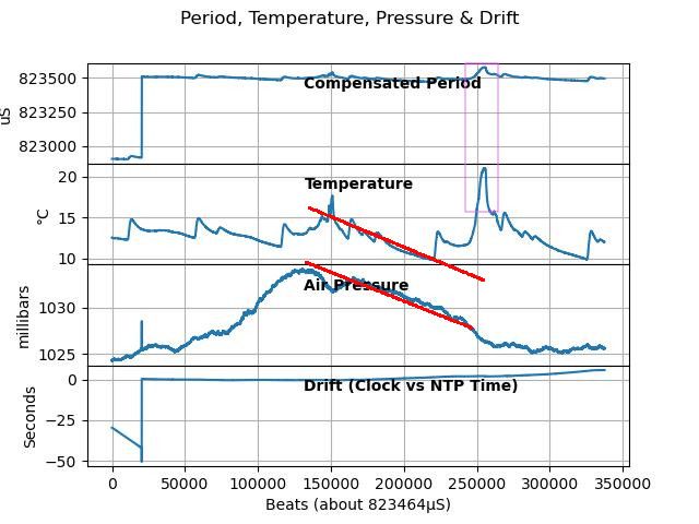

                                      Log this morning is disappointing.
                                      ClockEnd = 2023-02-07 09:46:07.401568
                                      ActualEnd = 2023-02-07 09:46:01.587103
                                      After keeping step for 36 hours my clock started gaining over NTP at beat=180000 and is now nearly 6 seconds fast (mostly over the last 17 hours):
                                      Not obvious that the cause is environmental, but it may have been triggered by air pressure and temperature falling together – red lines below:
                                      Possibly due to fault compensation. I already know it's imperfect, a hint being in the purple box above, where a temperature spike causes a bump in compensated period. More sinister there's a statistical correlation between drift and both pressure and temperature. (Pearson)
                                      Drift & Pressure -0.62
                                      Drift & Temperature -0.26
                                      I've decided to let the clock run to see what it does next.
                                      In the meantime, get the OCXO running – it's nearly finished. Then see if I can get the graph X axis to show real hours and minutes rather than beats. At the moment my graphs don't show what's the clock is doing relative to night and day, and beat scales make it hard to look for earthquakes at 01.17 UTC! Also follow up SKs suggestion about the strange Amplitude vs temperature graph.

                                          duncan webster 1
                                            @duncanwebster1
                                            Posted by SillyOldDuffer on 07/02/2023 10:50:45:
                                            Falling temperature should increase air density, and falling pressure should reduce it, so if you get a fall in both they should offset each other to some extent. Are you measuring humidity? That changes density as well.
                                            It would make life a lot easier if you could temporarily control the environment so that you could change one thing at a time, but that in itself isn't easy.
                                            Edited By duncan webster on 07/02/2023 17:41:39
