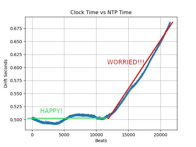

        #631478

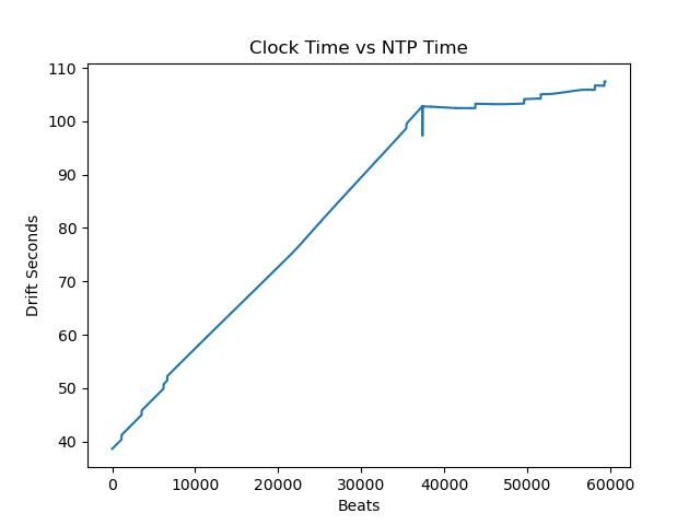

          Good to report something worked for a change, well nearly,
          This graph shows my clock gaining more or less constantly relative to Network Protocol Time until I applied drift correction at beat 37360, after which the line becomes more horizontal.
          The result is marred by 5 step jumps, all of which, I suspect are due to the bob not quite breaking the beam. The faulty timings occur in pairs that sum close to a correct period, but on the slow side:
          Beat Time
          6186 4205678
          6187 8967229 = 13172907
          6627 4202164
          6628 8968950 = 13171114
          43724 4233017
          43725 8937554 = 13170571
          In hope of curing incomplete swings I've increased Impulse by one notch and left the clock running. A better way would be to move the beam, or to pass it through a slit, but that means taking the cover off. I'll do it when the long awaited new suspension is finished.
          Edited By SillyOldDuffer on 31/01/2023 17:20:13

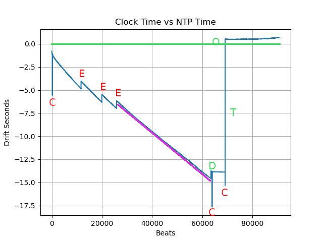

                Still ploughing on, three steps forward, two back.
                After various software tweaks I set the clock to compensate for pressure and temperature but not drift and let it run overnight until lunchtime. Purpose, to identify the drift rate from scratch and apply it. Result, a mix of good and bad news:
                The green line represents perfection, the settings at which my clock and NTP agree exactly.
                Good first. The purple line establishes the drift rate, and the necessary compensation was applied at point D, resulting in a flat line. After waiting to confirm it, I resynchronised the clock to NTP, causing the line to jump to point O, and carry on flat, about 0.18s faster than NTP. The line stays reasonably flat for about 10000 beats, just over 2 hours,
                Bad news!
                • Commands sent to the clock disturb timekeeping at the points marked C. It appears the clock is correct and the error occurs in the raspberryPi when the log is timestamped. Probably a software fault.
                • The beam break sensor misreads period 3 times at points E. Hardware fault.
                • Setting the clock to NTP time causes a synchronisation error. Design fault! The clock is set to the nearest second, but the raspberryPi should wait until the exact next second before sending the synchronisation message. Otherwise the clock starts wrong by up to 1 second, not good when it's aiming for sub-millisecond accuracy.
                • Although it should be compensated out, Temperature effects are still visible. Maths, logic or programming error.
                • Worst of all, corrected drift doesn't stay parallel with the green line. OK for a couple of hours, then it suddenly rises – red line below:

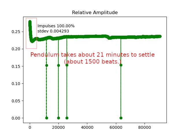

                Lastly, the relative amplitude graph shows my pendulum takes a long time to settle after a cold-start, red box below:
                Arguably, the graph suggests turbulence lasts for about an hour. I think the clock should be allowed to run for at least an hour before trusting measurements.

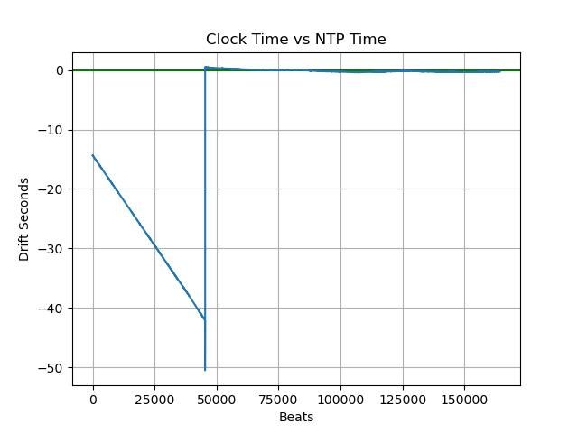

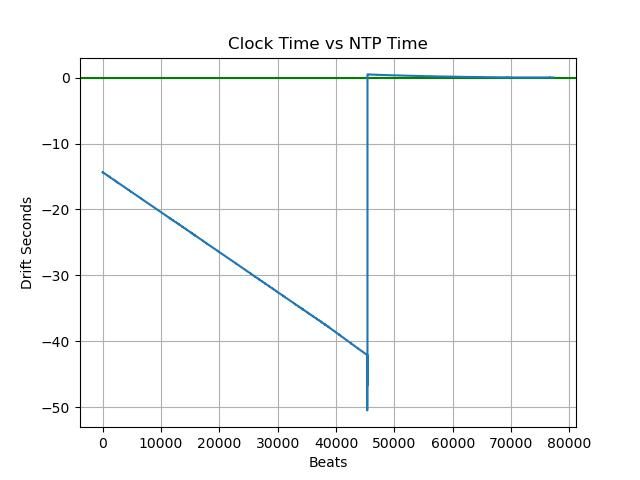

                  Too early to break out the champagne, but today's results are best yet. I'm encouraged!
                  Yesterday I improved the clock software so that it would synchronise closer to the NPT time command. The program on the main computer was changed so that, on receipt on a synchronous command from me, it waits until the next whole second before telling the clock. This eliminates most of the error due to ignoring microseconds at the sender.
                  In the clock, when a synchronisation time message arrives, I obtain the bob position by reading the pendulum timer/counter. This varies between zero and about 13175309 ticks. As each tick is 62.5nS, how far through a swing the bob is can be calculated accurately. This value is used to adjust the gearTrain so that counter time aligns with pendulum ticks. How good it is varies, but better than 0.1s is typical. More work needed.
                  I also changed the clock so that it only sends messages immediately after time reports. As these are written immediately after a 'tock', any extra messages have a whole pendulum period in which to send. Previously, clock messages where sent immediately, which meant the microcontroller could be tied up when a 'tock' was received, and delay reporting it. Touch wood, seems to have stopped glitches. The graph is clean, and no bad ticks are in the log:
                  The graph shows the clock running uncompensated for 45000 beats to establish drift rate, then the spike when drift compensation was loaded and the clock resynchronised to NPT. Thereafter the clock stays close to the green line, showing it's not far off NPT. Actual numbers:
                  ClockEnd = 2023-02-04 16:32:00.388850
                  NPTEnd = 2023-02-04 16:32:00.376452
                  Difference = 0.012s 0.000019% (0.195ppm)
                  The pendulum is unusually well behaved so far in this run, reporting Q=13883, Hopefully because the impulse is right and needn't be touched again.
                  It's what happens next that matters. With luck all is now good and the clock will stay close to NPT for months. More likely next time I check, it will have veered off for no apparent reason. I know the temperature and pressure compensation isn't spot on, but earlier runs showed deviations with no obvious cause. I suspect the suspension because it's not well made.

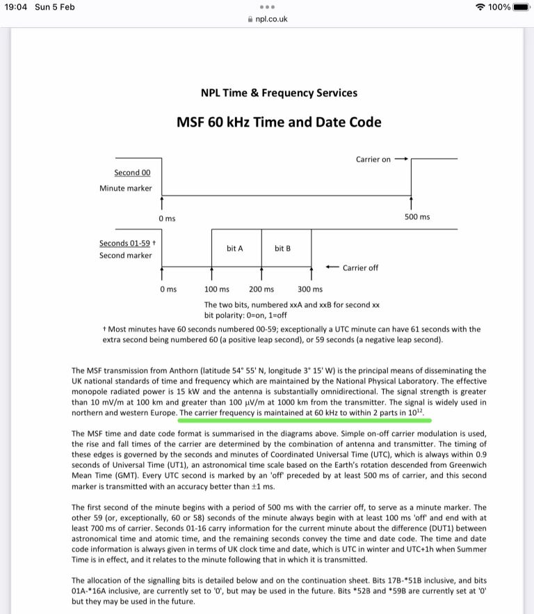

                                #632095
                                  I’m not sure how to pick the useful bits out of this, but:
                                  I noticed last night that NPL seems to ‘speak with forked-tongue’ about the availability of this carrier signal
                                  **LINK** : https://www.npl.co.uk/msf-signal
                                  [quote] The MSF radio signal is a dedicated standard-frequency and time broadcast that provides an accurate and reliable source of UK civil time. It is available 24 hours a day across the whole of the UK and beyond. The signal operates on a frequency of 60 kHz and carries a time and date code that can be received and decoded by a wide range of readily-available radio-controlled clocks.
                                  The MSF signal is transmitted from Anthorn Radio Station in Cumbria by Babcock International, under contract to NPL. The signal covers the whole of the UK, and can also be received throughout most of northern and western Europe. It is monitored against the national time scale UTC(NPL) and corrected when necessary, ensuring that the transmitted time is always correct. [/quote]
                                  At first sight ‘It is available 24 hours a day across the whole of the UK and beyond’ appears to be an unambiguous statement … but dig a little deeper, and there are a lot of caveats.
                                  To apply useful synchronisation, it would appear to be necessary to do this on an ad hoc basis, as-and-when the carrier is actually [and unpredictably] available.
                                  Eagerly awaiting someone’s clever work-around.

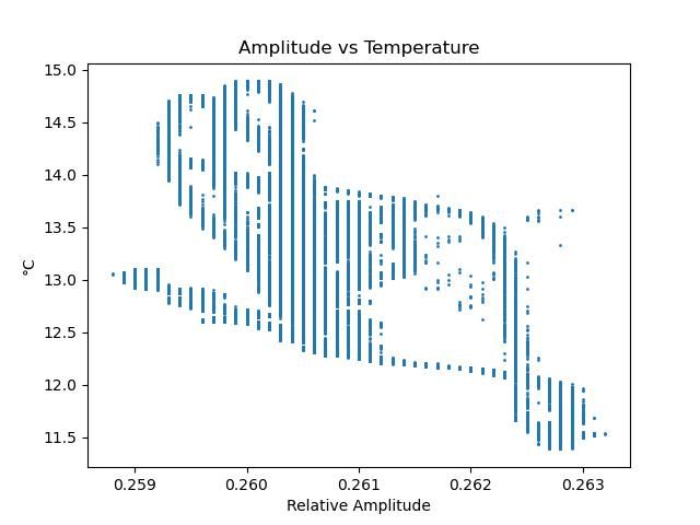

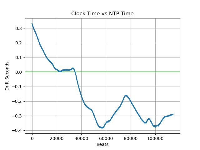

                                      Today's report, clock still close to Network Protocol Time, staying close to the green zero line:
                                      Sadly zooming in by changing the scale shows a swing of ±0.3s either side of NPT:
                                      Going to collect more data before investigating the wandering.
                                      As an aside I graphed Amplitude vs Temperature and drew a Possum on a branch:
                                      The vertical stripes are due to mathematical rounding between sensor and graph. Otherwise the graph shows amplitude broadly increases as temperature falls but the effect isn't precise. No idea what causes the horizontal gaps.
                                      #632114
                                      John Haine
                                        @johnhaine32865
                                        Dave, don't despair, those errors could be in part due to NTP wandering at your location…
                                        **LINK**

                                        S K
                                          @sk20060
                                          Your data in X starts with integers? The horizontal data looks to be quantized in units of 0.0001. So either the horizontal gaps are the natural result of starting with integer data, or there's rounding to 0.0001 units in the X axis as well?

                                              [ Addendum ] __ For clarity:
                                              Ref. __ **LINK**
                                              https://www.npl.co.uk/products-services/time-frequency/msf-radio-time-signal/msf_time_date_code
                                              I think, therefore, it may be the carrier frequency that would be most useful in the present context, rather than the time signals.
