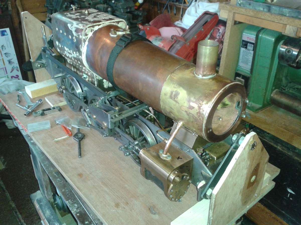

      How to assemble expansion links to gear frames on 5” gauge speedy.
      Can anyone help me,?  Chris west 1

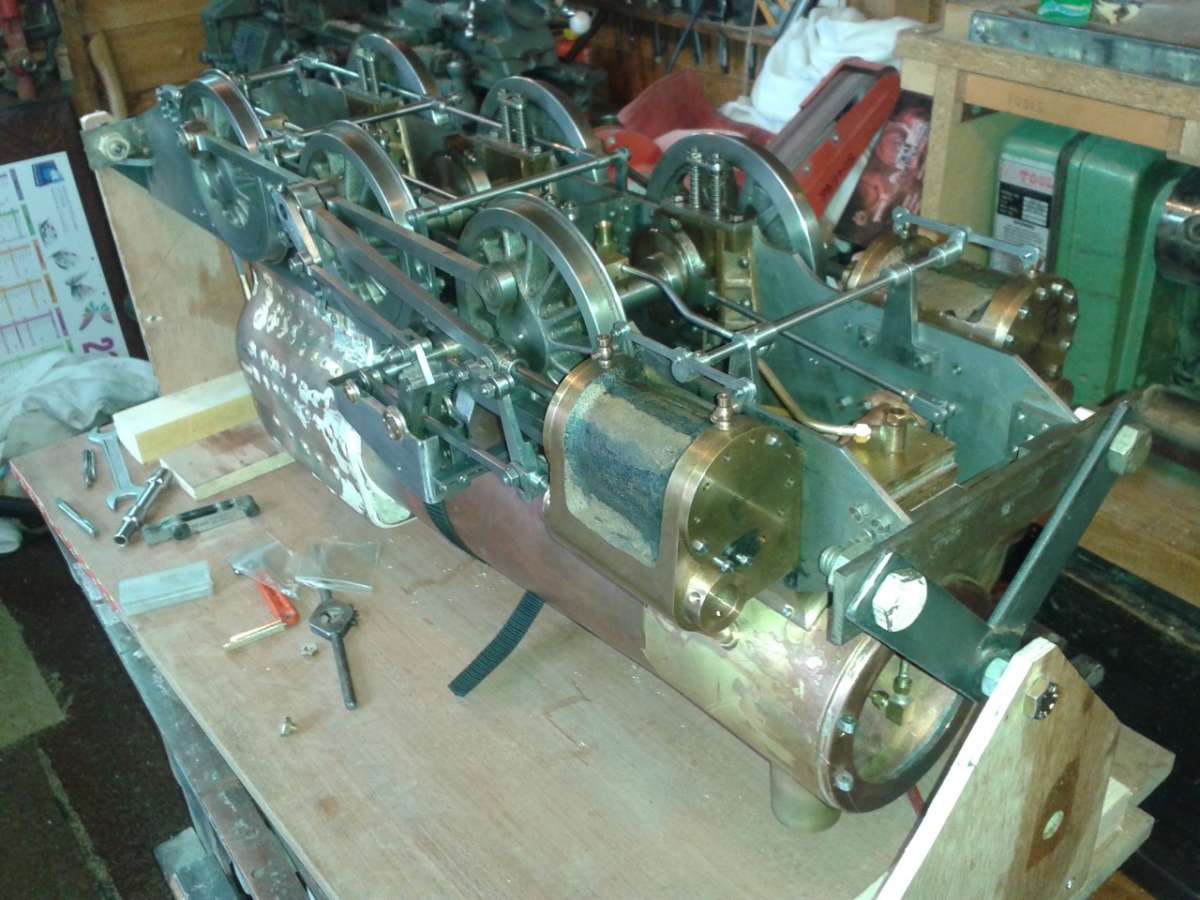

        Speedy Builder5
          @speedybuilder5
          I stumbled here and added a second bush to the outside of the gear frame. I have seen other SPEEDYs that have the outside plate of the gear frame bolted on.
          Top view Large
          UndercarriageView Large

            Hello Chris, I have just joined your band of brothers and I understand that you want to know how to get your expansion links into the frames.  I am not too au fe with GWR engines but on a B1 you need to put the side pivots into the frames first and then build up the links on to the pivots from scratch.  Try that and see if that works.  It is the same with most of the big LNER engines.
            regards,
            Doug Hewson
