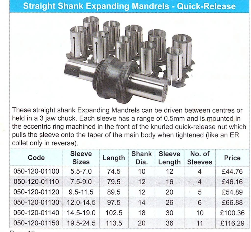

      A set of expanding mandrels would be good for something I'm doing, and looking at Arc Euro's paper catalogue #10 I thought I'd found the ideal things:
      However, it seems that Arc no longer do them, and I've drawn a blank looking for the same things from the 'usual suspects'.
      Anyone know of a supplier?

          Strangely [?] Ausee seems to have them in stock : **LINK**
          https://www.ausee.com.au/shop/category.aspx?catid=8384
          MichaelG
          #616026
          peak4
            @peak4
            Tobler do them, but I suspect the price might be rather higher.
            https://www.tobler-workholding.com/en/standard-expanding-mandrels/
            So do RC-Machines, but only morse taper arbors, rather than the ARC Eurotrade parallel ones
            https://www.rcm-machines.com/en/machine-accessories/expanding-mandrels
            I have some of the ARC ones; they do seem to work quite well, if a bit rough around the edges.
            Various people do 5C ones, but they seem mainly designed for one off jobs and need turning to size for each one.
            You could also look up "Expanding Arbor"  on ebay for something similar; look for 8 of them standing up in a wooden block.

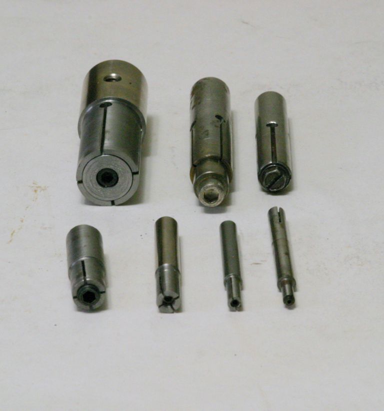

                    Robin
                    Like Ramon and Martin I make my own as the need arises. The largest in the pic is 7/8" and the smallest is 1/8". The three largest are expanded by a tapered plug and the five smallest are just drilled and tapped with a taper tap and expanded with a normal set screw. ( The 1/8' one has a 1/4" one on the other end ). The slits are made with a slitting saw, four for the larger ones and two for the smaller. (On occasion If I'm in a hurry I have just used a junior hacksaw! ). In use I chuck them in the 3 jaw "Griptru" chuck ( a 4 jaw would work just as well ), clamp the part onto the mandrel by tightening the screw, then, with a DTI on the outside of the part, adjust the chuck till it runs true. For non circular parts I just adjust the mandrel itself to run true.
