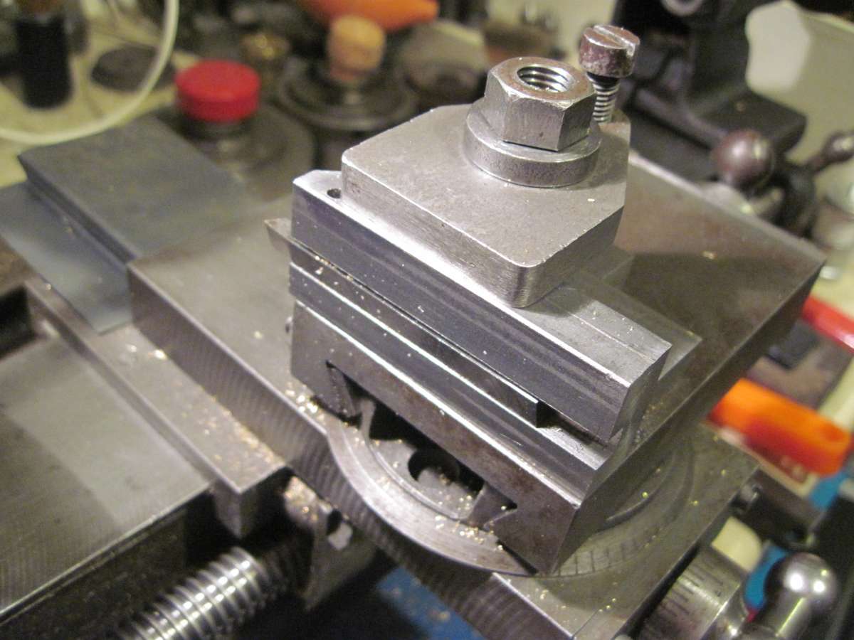

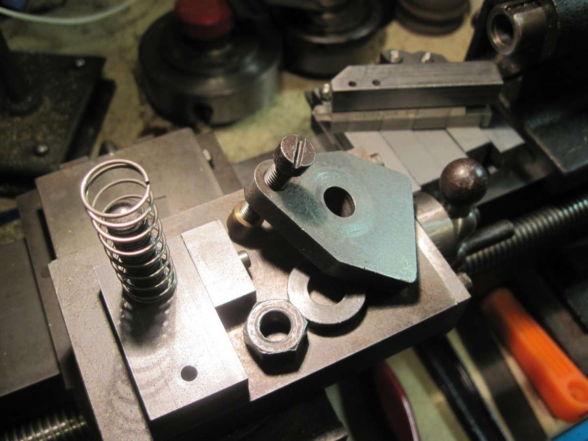

          Hi Merlot,
          We’ve been looking after one of our grandchildren today – so I’ve just about had it I’m afraid.  🙂
          However, here are a couple of (posed) shots I’ve just taken of my usual EW set-up.
          IMG_5705
          I normally use 3/16th HSS tools and mount them in simple blocks (as proposed by Dr Rose in ME many years ago). Once the tool is set for height, you can swap them in and out without any faffing around with packing etc. They are as quick as using an QCTH, easier to make and have some other advantages on a small lathe. I’ve evolved my set-up over time, starting off with just the blocks themselves and then adding the other ‘components’ shown below…
          IMG_5707
          From memory (the top of) the EW top-slide is 1/2″ below the centre line, so with 3/16th tools, you need the bottom of the slot to be (slightly under) 5/16th. In practice, my blocks are reversable, in that they can also be used the other way up, to mount correctly on my boring table fitting. Not something you need to worry about though.
          I do have a small (e.g budget) QCTH but on a small lathe like the EW there are a number of problems with them, as they can add another inch of ‘stick-out’. This causes problems not only with rigidity (which is not that great on a small lathe anyway) but also limit the amount of cross-slide travel.  You can easily over-wind the EW cross slide out too far trying to cut larger diameters if you are not careful. I’ve also had issues with not being able to get the tail stock near enough to the chuck with that extra inch on the front of the cross-slide (to use a live centre for instance).
          If you would like to read Dr Roses ME articles, then PM me with your email and i’ll send you scans.
          With respect to setting gib-strips, for both the cross & top slide, I’d suggest you unscrew/remove the lead-screws and set the gibs by sliding the top/cross slide too and fro as you do it. You want them slighly stiff but not too much so (with no really tight spots). Make sure the gibs are well seated and the ways cleaned & oiled before you do it.
          Hope this helps. The EW is a really great little lathe. I’ve had mine for quite a while now and use it regularly. Wouldn’t want be without it.
          Regards,
          IanT

            Merlot,
            The screw is used to accommodate differing sizes of tool bit and ensure a proper balanced cantilevered force is applied to the tool. Looking at your picture, try to imaging if that screw was not present, how ineffective the clamping pressure on the tool would be (and if it could be secured at all).
            With this type of clamp, what I do is approximately set the height of the underside of clamp to rest on the  tool bit so it is roughly parallel with with the surface of the top slide and finger tighten the nut. Then turn the screw a little so that it slightly lifts the clamp plate on the screw side and exerts a little more pressure on the tool bit. DONT  overdo this bit of the procedure because this is how you crack the top slide under a high point load – 1/4 to 1/2 turn will do.
            Then finally tighten up the nut to securely hold the tool.
            I would advise you take a good look at the base of the screw, making sure it is not rounded or pointed and also consider using a decent sized piece of  1/8 flat m/s to spread the load of the screw and so avoid the disaster that I caused on mine (shamefully turns to corner with dunces hat on).
            Gibs on this machine never feel like they are set properly. To do the best you can, No. 1, take them all apart and give a good clean. Check to see that the sliding surfaces are straight and not bent, galled or burred. If so clean up and lap as best you can.
            Check to see if there any reference dimples that perfectly line up with the gib screws, and what manner of screw they are (pointed ones that sit cleanly in a neat little dimple would be a good start).  If there is just a mass of scarring and random pits on the part of the gib that the screws bear on, blue up and try to establish a true location point using new gib screws and drill a clean location dimple.
            Once everything is back in position, for the saddle, remove the apron set the centre gib screw with saddle in mid bed so you can freely slide the saddle up and down the lathe bed with modest pressure. If you find it is much looser at the headstock end of the bed then at the tailstock, that will be due to wear on close to the chuck. Not much you can do about it but just adjust the gibs according to the part of the bed that is being used.
            Assuming you get a reasonably smooth action with centre gib screw set, lock it if you have a locknut. Then tighten the other 2 gib screws to take out any rocking motion of the saddle. You should be able to move the saddle by hand but find it will not lift or twist over its usual range of movement(subject to what degree of differential wear there is on the lathe bed). Replace apron and curse the fact that you only have a fixed nut!
            Use a similar sort of procedure on the cross and top slide by undoing the screws that hold the end plates in the slides and winding out the leadscrew so you can check slide movement by hand. Aim to get to get free movement without any lift if the slide by setting one gib screw then remove any rock n roll with the other gib screws while keeping smooth movement over full range (or as much as is acceptable to you). It is a bit of a faff but this way will reveal any issues with the movement of the slides when free of the influence of the leadscrews.
            If it is all to daunting, just use the same process leaving all leadscrews connected, although more difficult to feel motion accurately. The aim id to arrive at a situation where there is minimum play and rock over the range of movement, but you can twirl the leadscrews comfortably.  Don’t be disappointed  if there are loose and tight spots – it will depend on the mileage your particular example has done.
            On this class of machine it is all a bit of a compromise and as long as excess play is minimised and you can minimise chatter, that is about as good as it gets. I find it is not unusual to have to adjust gibs mid job, because my EW is slightly worn about 3-4 inches from the headstock.

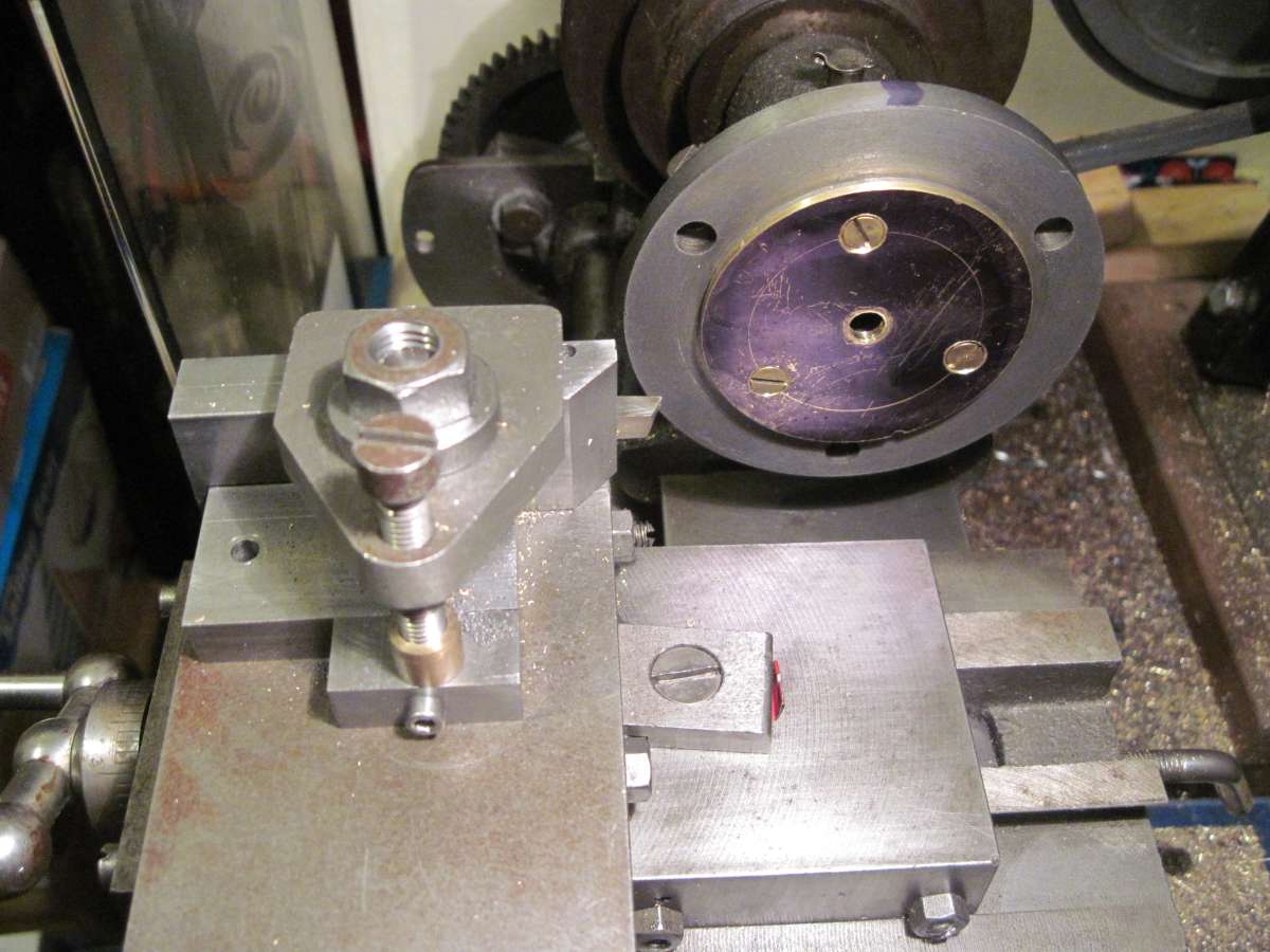

              IanT
                @iant
                For anyone interested, here is another view of one of my tool blocks in use on my EW – as seen from the tailstock
                IMG_5706
                You can see that the tool block is fully supported by the top-slide and that it can reach the edge of the (55mm diameter) brass part being machined. With my QCTH, it would hang out further to the right by over an inch.  More importantly, I’d have real problems trying to wind the cross-slide much further back without running out of V-guide for it to hang on to. Small machines need different approaches to these problems…
                As an aside, I’m machining a new register on this backplate here because the old one was too small.  I originally started just cutting one into the cast iron again but it was a really dirty job and I went a few thou too far whilst trying for a fit (I said some bad words). The 60mm brass offcut was trepanned from another job, so ideal for the work (I never throw anything non-ferrous away). I superglued it to the backplate, clamped, drilled & tapped for 4BA countersunk screws. I machined the plate down to 55mm and got it bang on second time around – a tight sliding fit. I mention this because I think there were a couple of advantages to doing this. First of course, brass isn’t quite as messy as cast iron and it’s easy to take very light/small finishing cuts with a sharp tool. But because the plate was ‘raised’ (by the old register which I left in place) there was no need to undercut the base of the register, which means the chuck seated perfectly against the backplate when bolted up. The plate is purely an alighment device, it doesn’t take any load in use.
                So although this was one of my (not uncommon) screw-ups, I might do it this way again if I needed to, certainly if I was re-cycling an old backplate that was already a bit thin. My ER32 chuck fitted this way now has a run-out of 0.006mm (less than a quarter thou) if my metrology is correct. Unfortunately, I doubt this will be repeated with actual work held in a collet as my collets were not very expensive (e.g they were really cheap) although I’ve not tested them in it yet and I may have just got lucky with the chuck. I will certainly look more closely at my other ER chucks now and maybe try this approach if it seems worthwhile.
                Mileage may vary for others doing this of course but I’m feeling quite pleased with it.

                  I like those tool-holders, Ian.
                  And that thrust-pad for the screw.
                  If I may so though, I think the toolpost stud and nut would prefer to be married rather than just engaged! They are hanging on almost literally by a thread, well, probably two. I would make the top of the tool block and that washer a bit thinner so the nut is used to its full depth.
                  A trick I use sometimes when working out on the edge of a large diameter – on any lathe – is to mount a left-hand tool cross-ways on the outer area of the top-slide, so the cross-slide is well inside its travel even when the tool is far out from the centre.
                  I see your lathe still has its bent locking-handle for the saddle clamp. Mine broke, and examining it, it seems to be aluminium! It might of course have been a replacement made by the previous owner, but as I now have some proper bar-bending tools I’ve no excuse for not making a new one from mild steel!
                  I assessed the wear on my EW using a short length of precision-ground steel. This suggested a replacement spindle 0.001 – 0.002″ oversize might be enough to put it back into operation: I’d need make some plug-gauges to try that. A lot of work to make it and turning anything parallel to that limit over more than an inch length on my Myford lathe is difficult or impossible. The pulley and back-gear pinion may need lapping out to suit, as they are not very worn. Making a new spindle is still a possibility though. As far as I can tell the original is plain mild-steel.
