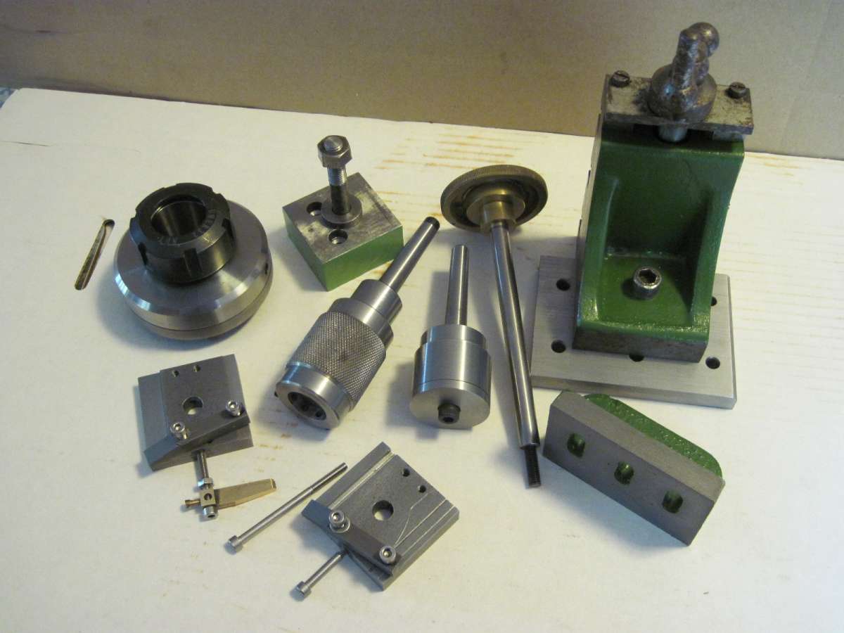

                                  Nigel Graham 2
                                    @nigelgraham2
                                    I gave my EW simple oil-cups that are really only little cylindrical funnels, and it has served for many years like that. I just give it a drink at the start of the session.
                                    Oil oozing down the front of the machine is only surplus and a bit messy but hardly serious when you consider the slides and lead-screw are all open, and all machine-tools are rather grubby things to use anyway.
                                    My lathe’s spindle and the headstocks are now worn though, and I am investigating how to bring them back to decent condition.
                                    Following another contributor’s suggestion I have sent off an enquiry about having the spindle hard-chrome plated and ground back to its original 0.750″ diameter.
                                    Failing that is the feasibility of making a spindle but I am not sure I could to proper standard with my workshop… and its staff. At least I’d still have the original one. The answer may be to use ground stock and make the flange as a separate collar pinned or grub-screwed on.
                                    The spindle flange had worn a sort of counterbore in the casting. I solved this by making a very thin bronze thrust-washer – I’ve just measured it as 0.048″ thick so its effect on the spindle’s axial position is insignificant. It is prevented from rotating by a peg made by screwing in a brass 6BA or 8BA stud, and filing it to a blade that locates in the casting’s adjustment slot, but is thin enough still to allow that closing on the spindle.
                                    Merlot –
                                    There is a goodly section on the EW Lathe on Tony Griffith’s lathes.co web-site – and I hope your system manages to avoid the appalling external rubbish that irrelevant advertising agencies have plastered all over it!
                                    Note that the lathe as designed does not have a fine self-acting feed. The standard change-wheels are for screw-cutting only, though investigating by spreadsheet revealed they can give a surprising range of pitches, even some of the common metric ones, to reasonable accuracy over short distances such as for studs.
                                    If you have the vertical-slide and boring-table for your lathe, I’d advise not trying to rely on holding the VS just by the single bolt it is drilled for. I made two L-shaped steel fences about 3/4″ thick, each with 2 tee-bolts of their own, to fit to the table as buttresses against the rear and two sides of the vertical slide’s base.
                                    I’ve also made some little tool-holders that take bits ground from 1/4″ diameter tool-steel (broken / worn out milling-cutters and the like!). They are just short lengths of m.s. rectangular bar with assorted holes for the bits, held in place by grub-screws. Drilling the holes inclined gives some height adjustment and though it’s hardly a full QCTP arrangement these holders do save a lot of faffing with shims!
                                    I’ve also a 4-way tool-holder with my EW, but I don’t know if original or made by a previous owner. (I think I might be only its second owner!)

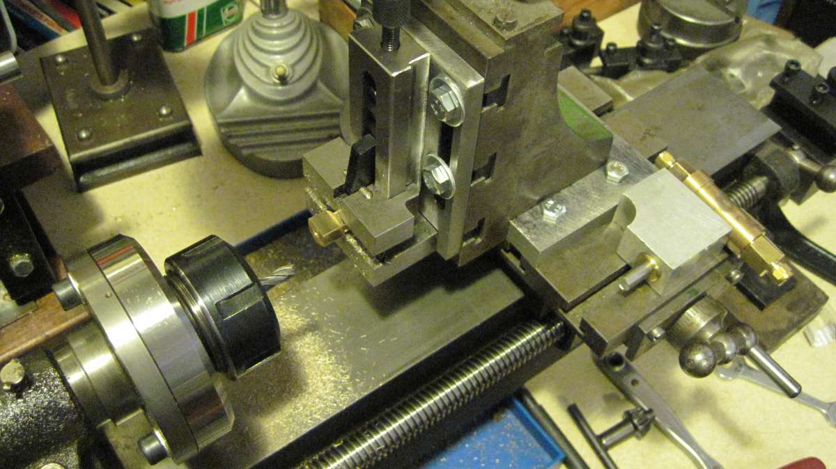

                                    #720500
                                    IanT
                                      @iant
                                      If you have the vertical slide and boring table Merlot – it is very simple to make a steel adaptor plate and securely mount it. This also gives a bit more useful travel with a small vice mounted.
                                      EW - Sept 2014 008
                                      #720506
                                      IanT
                                        @iant
                                        Apart from the Martin Cleeve articles in ME which have been mentioned here many times, you can also find some very useful ideas for the EW on Alan’s website:
                                        http://modelengineeringnorge.weebly.com/
                                        Regards,
                                        IanT
                                        PS Vertical Slide in use…
                                        EW Vertical - Jan13

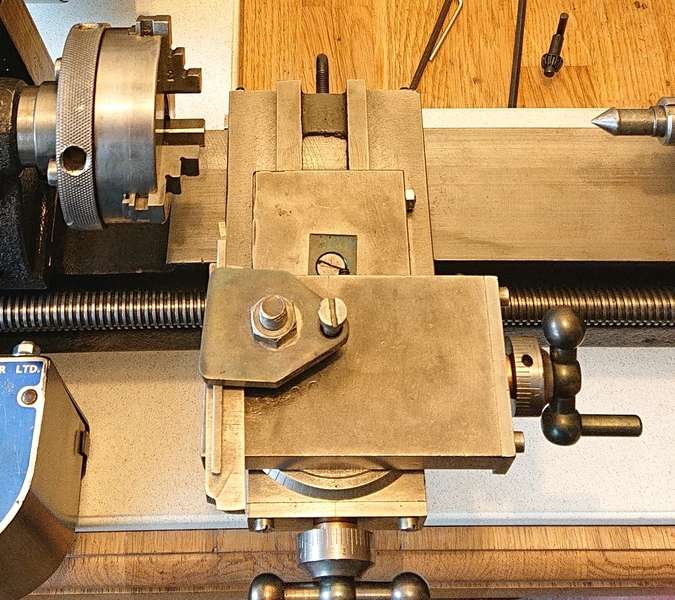

                                            #720526
                                            merlot
                                              @merlot
                                              @ IanT I would much appreciate any advise that would enable me to get the most out of this lathe. Here is a picture of my tool arrangement as purchased albeit rust removed and cleaned.2024-03-13-15-35-05
                                              Also the Chuck its a Pratt manufactured scroll but does not have much in the way of clamping force. I was thinking of upgrading to a modern key type chuck. It also came with a 4 jaw which seems to be a black art in setting up 🙂

                                                #720615
                                                Martin of Wick
                                                  @martinofwick
                                                  Nothing wrong with the clamp arrangement. Just don’t over spanner it or you might crack the top slide – ask me how I know!
                                                  When using the top slide there is very little room between that surface and centre line which means the commonly available QCTPs can rarely be made to fit. The clamp is a bit of a faff but to start with you can standardise on some  4/ 5/ 6mm HSS at modest cost from ARC and make up simple dedicated mini toolholders that will permit some height adjustment as Nigel suggested.
                                                  When you get the hang of it, make up some mini tangential toolholders, once made, these are very easy to set, to grind, and give really good results (left and right if you can). Then a 1/4 – 3/16 boring bar to run in an eccentric sleeve in a small block will be a useful addition (I think one of the G H Thomas books covers that)
                                                  For practice, you could make some spindle adapters for when you want get a new chuck or add a ER32 collet chuck.
                                                  By the time you have done all that, you will be in the ‘experten’ category!

                                                    #720625
                                                      I don’t think anyone has mentioned the horrid possibility that the high oil flow rate is due to the bearing being worn.  Wouldn’t be surprising because the EW lathe has a very basic plain bearing, the lathe is an old-girl and may have been abused in the past.
                                                      The bearing is just a steel spindle running in a cast-iron casting, with an oil hole.  The type works well enough lightly loaded at slow speeds, but they all wear out eventually.  Rapidly if a previous owner put grease in the oil holes, didn’t bother with maintenance, or was a gorilla who drove his light hobby lathe brutally.
                                                      With the lathe stopped, check the bearing by putting a DTI on the chuck body, front, top, and side in succession.   Make sure the DTI needle doesn’t move much when the chuck is pushed hard by hand sideways, upwards/downwards, and in-out.
                                                      A big lateral movement suggests the bearing is worn.  If so, may not be bad enough to matter yet.  The acid test is how well the lathe cuts metal.  Surprisingly good work can be done on worn lathes, provided the operator compensates, though that needs a certain amount of experience.   To find out,  I’d start by turning Brass with a sharp tool and then check the result; poor finish, dig-ins, tapers, etc are all suspicious.  (Most varieties of Brass machine well whereas other metals can confuse a beginner.   Part of the fun is discovering that not all metals machine well, and some are vile!)
