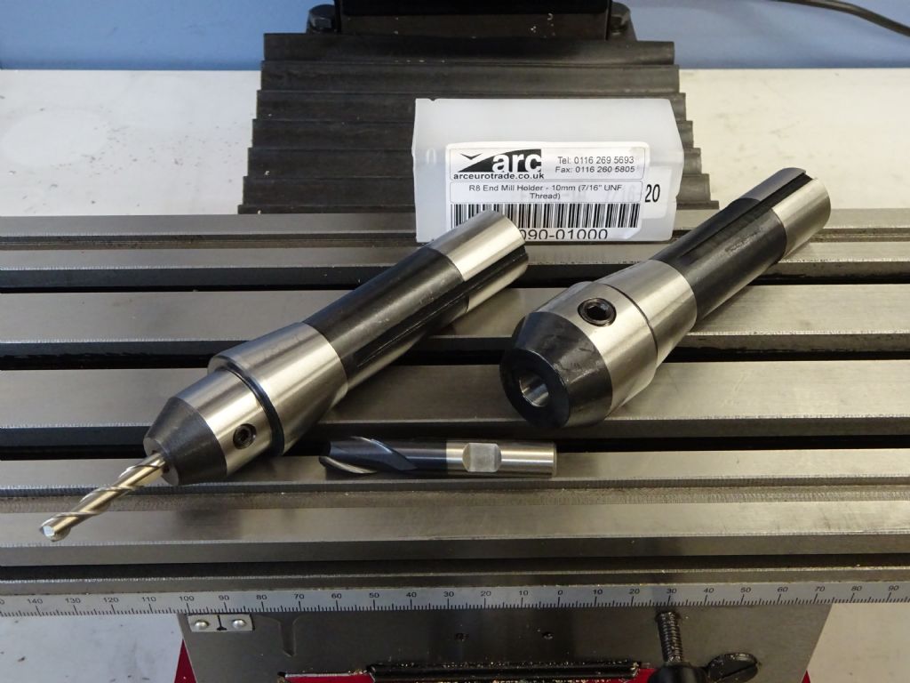

                            #400981
                              One downsid eto using MT or R8 collets is that it can make it hard to see what you are doing when using small cutters, take this example of teh SX2.7 when standing this is what you see
                              And not a lot better if you bend down and you ca't get near work if clamps are too close
                              One option for small cutters is an end mill holder which will still be better for seeing what you are doing even with ER25 or ER32 particularly if using a bearing nut which tends to be square edged.
                              But for versatility and if you can only budget for one then go for the ER25 with say 6 common metric collets and if you work in imperial get the imperial collets too. Others can be added later if needed.
