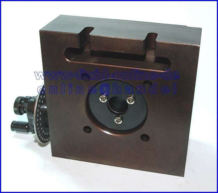

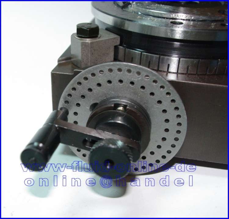

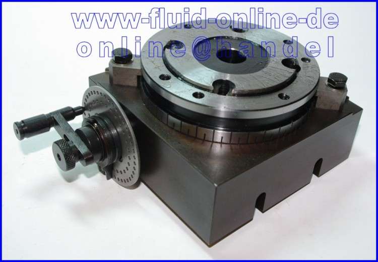

      Those of you that’ve been following Graham Meeks two threads on upgrades to both his Lathe & Mill will already be aware of him using an Emco Dividing Head to achieve some of those upgrades.
      Emco Compact 5 Modifications
      Adaptation of the Proxxon Milling machine
      Given that I’m in Australia & finding any Emco stuff is like the proverbial “hen’s teeth”, my alternative is looking to Proxxon for similar tooling & accessories.
      In my case I’ve already got their PD 250/E Lathe (close sizing to the Emco C5) & their FF 230 Mill, exactly the same as Graham’s one.
      Hopefully this also helps explain “why” I’m only after info relevant to accessories suited to these “small/micro” desktop style machines.
      So can anyone advise whether the Proxxon UT 400 Universal Dividing Head is the “equivalent” (or viable substitute) for the Emco Dividing Head version?
      I’ve never seen or used either the Emco or this Proxxon UT 400 “in person” & so given the costs involved, I’m slightly cautious of investing in something the “fits” but isn’t as “good” or of “poor accuracy”
      My hope is that someone on this Forum (being UK & Euro) will have knowledge or experience with either or both units & help provide some answers.
      My potential use of the UT 400 would be limited to a few “future” potential projects & so the investment now is being weighed up against the “unknown” & even less likelihood of finding a 2nd hand unit within Australia.
      Also viable alternatives are “thin on the ground” due to the scale & size limitations in Z on the Proxxon Mill
      Photos from a German Supplier website as they show more views & link to the Aussie Supplier for the limited info available about the unit itself. (I’ve since got the Manual with has more details)
      regards Colin

        There are loads of small rotary tables around at much lower prices.  Soba seem to make quite a range and may be available in Australia. Here’s a link to a UK supplier.  Comes without dividing plates but they are easy to make if not available.
        My experience with Proxxon isn’t very happy, I don’t think you get the quality you think you are paying for.
        #748241
          The Emco offerings where not really dividing heads, they were more what would be known as indexers where you had a range of plates and could index using those and a plunger. I have the smaller Unimat3 Version.
          The one you show from Proxxon is more of a rotary table complete with the dividing plate so will both allow the machining of curved surfaces and also a greater range of divisions so is superior in far as what it can do.
          As John says there are other rotary tables out there that may do the job at less cost though the 400 does look more compact than most.

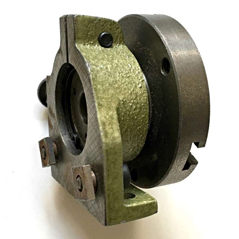

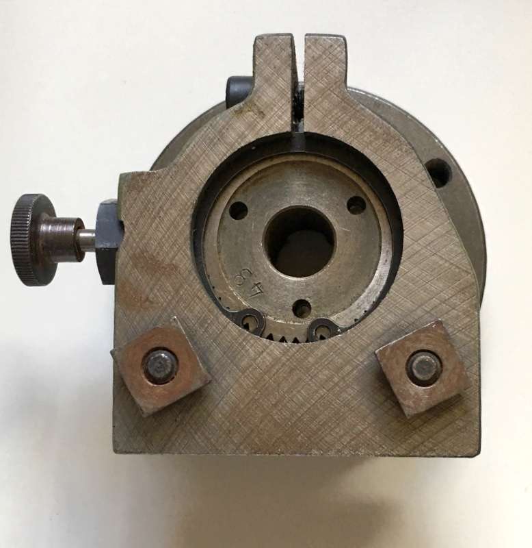

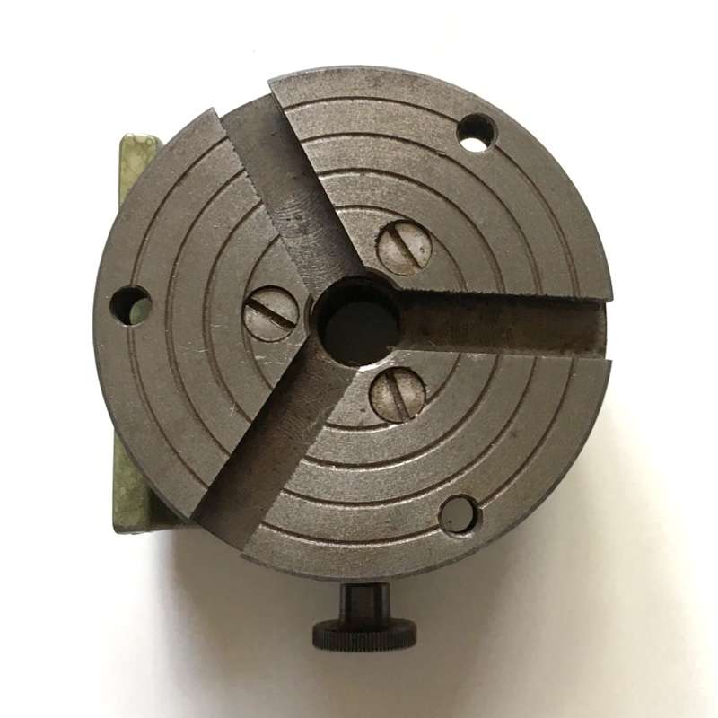

            Further to Jason’s advice … here are some photos:
            IMG_0200IMG_0203IMG_0202
            #748261

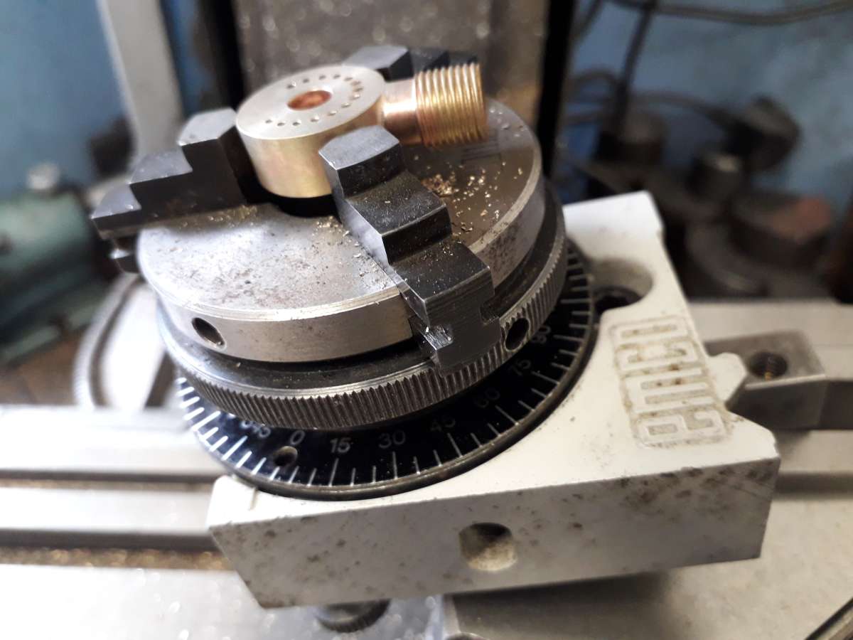

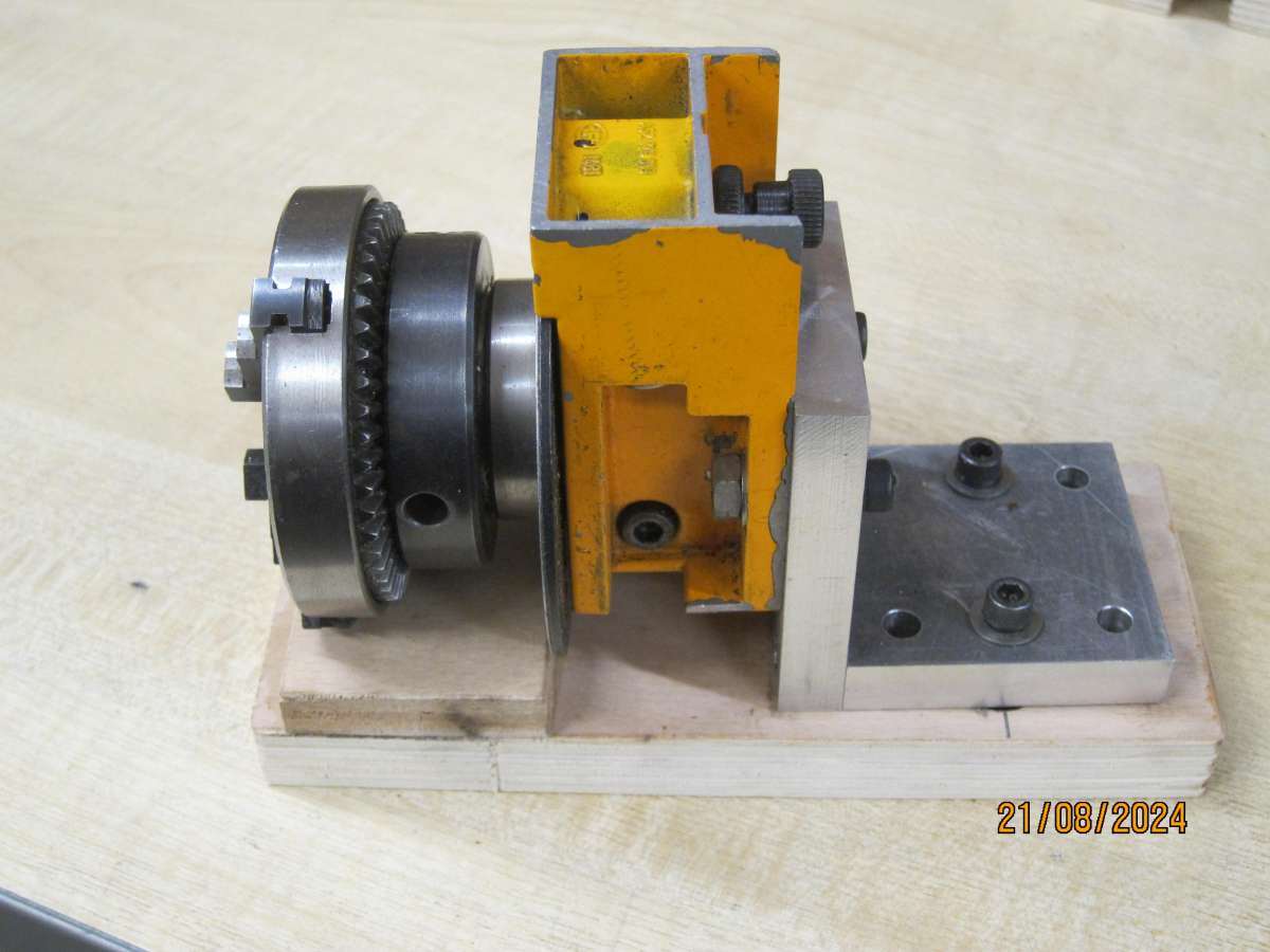

              That’s an old SL I think which is different to the U3 and C5. They are more of a block and have the pin parallel to the rotational axis which engages in the holed plates rather than the one in your picture which indexes into holes at the side.
              The C5 can be seen in Graham’s thread complete with his additional worm & Wheel attachment with the indexing plate still attached
              My U3 last time used in anger

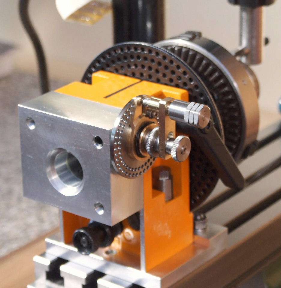

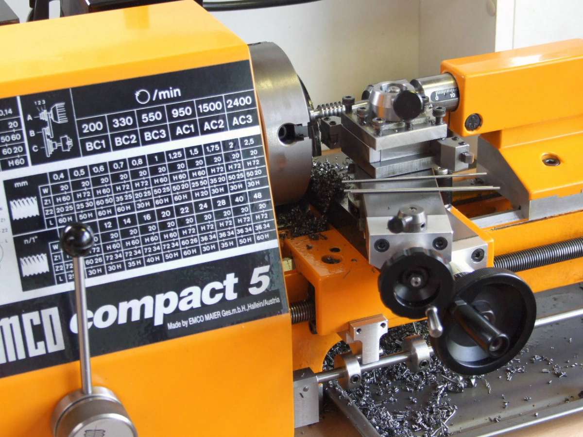

                  Hi Colin,
                  The original machines of Proxxon and Mannix were designed by the Sakai Special Camera Company in Japan. The Dividing head come Rotary table shown above was designed by them. It does however come with a hefty price tag.

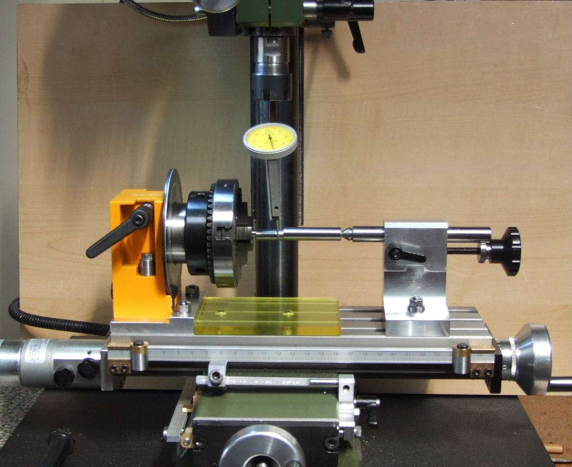

                  I made use of the Emco Indexing unit as it was compatible with my C5 and as such I could use the equipment from this lathe. Gear cutting was always something I am going to be doing so the “Dividing Attachment” was designed for this purpose. It follows the same principle design of the larger Emco FB2 Dividing attachment.
                  Attachment in situ
                  Using this on the Proxxon requires an adaptor plate and a special tailstock.
                  Proxxon Tailstock Support
                  Using this in Rotary table mode takes up too much of the available space, “daylight”, under the spindle nose.
                  A dedicated rotary table unit specifically for the Proxxon mill is on the drawing board and uses a larger wormwheel 60:1 of a similar tooth profile to my Dividing attachment. Cutting the worm for that unit was carried out on the C5.
                  Cutting 10 TPI Worm
                  The design follows the Sakai original, but with some additional clamping places. This design will fit within the table size, because as you know there is not a lot of space to the rear of the table when the cross-slide is fully wound in. In fact on my machine the table touches the column.
                  The table width of the Proxxon at 80mm matches the diameter of the Emco C5 chucks so I can utilise the full table movement in the Y-Axis.
                  This can be a problem with buying in non-dedicated equipment for use on these machines. The item will always be a compromise and that compromise will always lead to further compromises. Proxxon list a small Rotary Table which is I think 75m diameter. I have no experience of this unit but it is just a rotary table.
                  I will keep you posted on the progress of my design.

                              Here is some more detail of the SL device:
                              https://www.nielsmachines.com/en/emco-unimat-sl-dividing-head.html
                              No pins and holes involved in the indexing … and personally, I believe it is therefore potentially more accurate.
