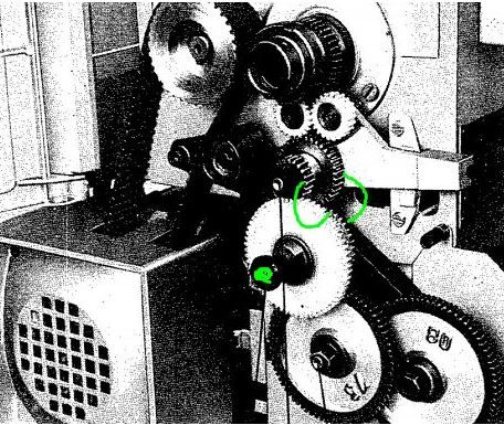

                              Avery, you must have a machine that is not like any of the others if you look at the end of the machine where the push/pull lever is you will see a coarse and fine zig zag which represents coarse or fine feeds. The tumbler only uses one or both of two gears that are the same tooth count so only changes direction not speed. Turn the chuck slowly by hand when pulling/pushing the lever as it may not drop straight into the different gear (no syncro) and will just spring back
                              Phpoto below shows the two light coloured gears with a green blob on teh push/pull knob, moving this will engage one of the pair of gears marked ( or ) in green so changing the feed rate. The two small white gears on the tumbler are the same size so don't affect speeds.
                              Images on page 32 of Michael's pdf link show the tumbler lever in the DOWN position which would be correct for the usual right hand threads.
                              The chart in the PDF is the same as the inside cover, top left of that chart has an image of a turning tool and the two arrows with 0.12 and 0.05 are under that so apply to FEED RATES. To the left of that there is a representation of a screw thread, the gear train below that is the THREAD CUTTING one.
                              Edited By JasonB on 04/09/2020 17:11:57

                                    Reading that stuss above from Avery, (hi A. use that translator!*), I'm beginning to loose my will to live…
                                    – the knob on the tumbler reverse lever is not the one which changes the feed speeds!!! This is on the side of the cover, see Jason's picture.
                                    – I am old and cannot always trust my memory, but I am quite sure that for screwcutting that double gear is always removed, or in other words: a screwcutting setup never transmits over that double gear. The picture on p. 28 of the manual above shows the setup for normal turning., and the feeds 0.12 and 0.05 mm work only in that setup!
                                    Jason displayed all very clearly in the piccies above, so I retreat now…

                                      Thanks to all here, this has just helped me realize that my EMCO 8.6 is missing the "push-pull" knob for changing the feed speeds.
                                      The photos provided are excellent.
                                      The explanations spectacular and so well written!
                                      I appreciate all this.
                                      I shall "experiment" with making a temporary knob, and get to know this part of "my baby" a little better.
