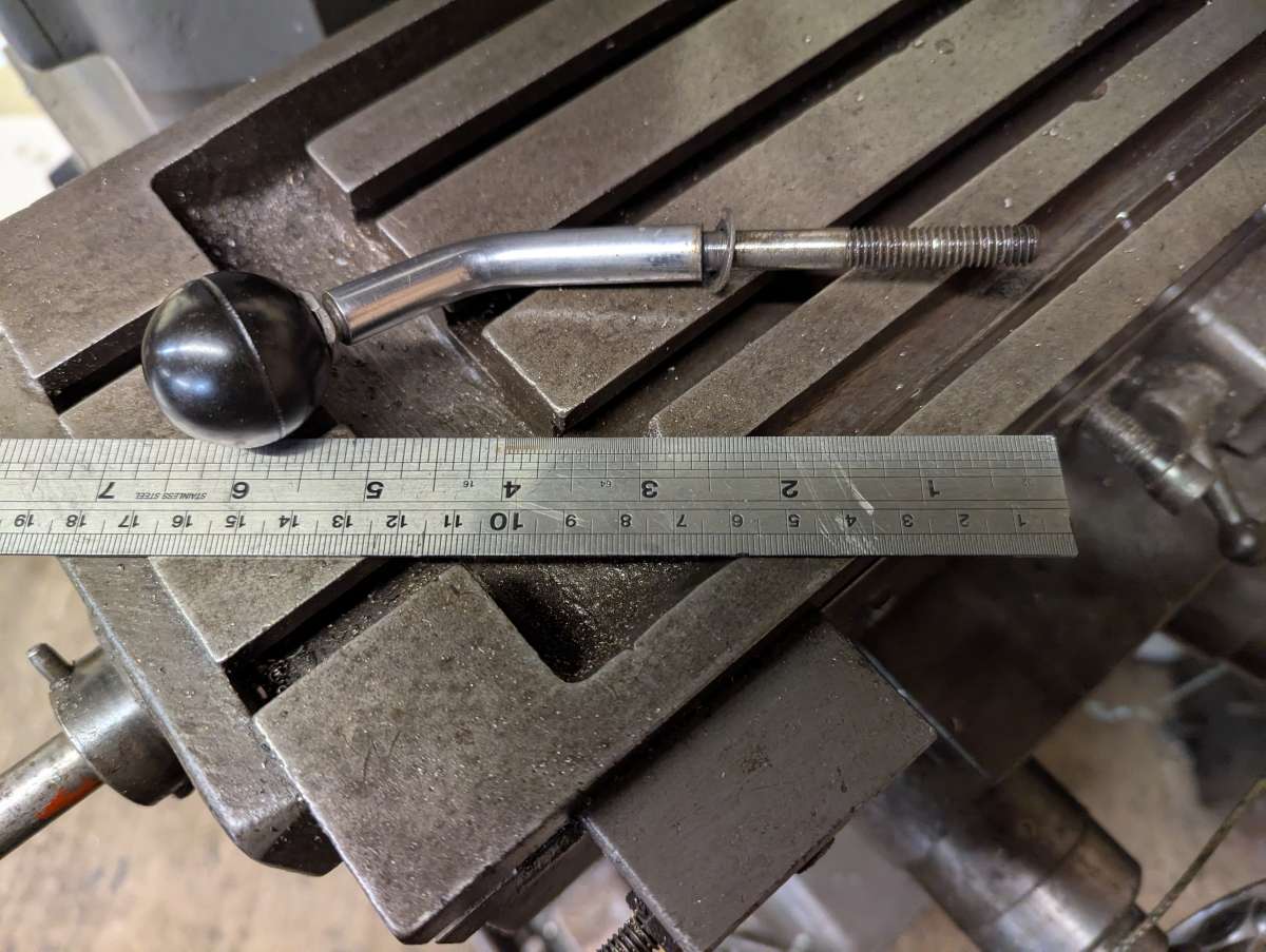

      Hi All,
      I’m new to the forum, please be gentle! I picked up an Elliott Omnimill 00 earlier this year, which I’m in the process of restoring.
      At some point in it’s history the original quill clamp bar/handle has been replaced with a bit of bent M8 threaded rod and a couple of nuts. I’d like to make a new handle as close as possible to the original. I guess the original would have been 5/16″ UNC or Whit (there appears to be an odd mix of both on this machine). Would an Omnimill owner be so kind as to pop the handle out and take a photo with a scale so I can knock one up?
      Cheers,
      Rich

        Either UNC or Whitworth would work equally well. I take it the lock is on the left side just below the round plate. Making a handle out of a suitable machinable stainless steel would be best, it can be threaded both ends and then bent to the right angle afterward, and the clamp nuts can be made from brass as one piece before producing the curved ends to match the diameter of the quill and then cut. Only the right hand nut has the thread, the left one has a clearance hole
        Lathes UK website have lots of info and pictures of Elliot mills and probably sell a manual which would be useful.

            Here you go;
            PXL_20250405_123452017
            #792113
            Paul Kemp
              @paulkemp46892
              This dumb forum won’t let me insert multiple pictures!  Knob is 1.25″ diameter, bar is 0.436″ diameter, distance from end of thread to shoulder is 2.445″. Hope that helps.

                Paul’s locking bar shows why I recommended making it out of stainless steel, that one has the shaft electroplated by the manufacturer.

                        Brilliant, thank you so much.
