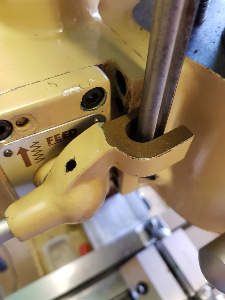

        I'm currently restoring an Elliott Jig Borer MK1 which is missing the automatic feed lever and stop mechanism. Would anyone know of one being broken down or a source of spares?
        #398170
        JohnF
          @johnf59703
          Hi Gwilym, Looking at the machine on http://www.lathes.co.uk and this photo of the Downham **LINK** it does not look too difficult to fabricate the lever from solid or welded parts. The Elliot looks slightly different but very similar and the photo is not as good.
          Anyway good luck with your search for one from a breaker but I don't think its a high chance.
          #398177
          JohnF
            @johnf59703
            A bit more possibly unless info ??
            **LINK**
            #398184
            Gwilym Box
              @gwilymbox37276
              Thanks, fabrication was going to be my fallback position. I was aiming for all original parts but having been through a lot of photos, a small block of cast iron and some rod should allow me to produce something very close to the original.
              I've stripped the rest of the machine for painting and have dismantled and cleaned head and gear box. Time to put it back together again.

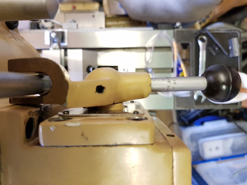

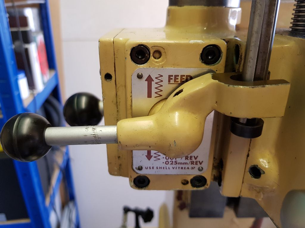

                Hi, I've recently bought a Downham Mini Borer which I believe is the same as the Elliott. It has the feed lever so if I can provide you with any photos and measurements let me know. It looks to be made of brass or bronze.
                Cheers
                Steve
                #414606
                Gwilym Box
                  @gwilymbox37276
                  Hi Steve, thanks for the offer. A picture would be very helpful especially to compare to the Lathes.com photos.
                  My assumption was that the main feed assembly was cast iron and the actual handle was satin chrome steel with a black plastic ball.
                  I've used the photos to determine approximate sizes and shapes and will make a wooden template. Once I'm happy with the shape and functionality I have a chuck of cast iron to machine.
                  Cheers
                  Gwilym

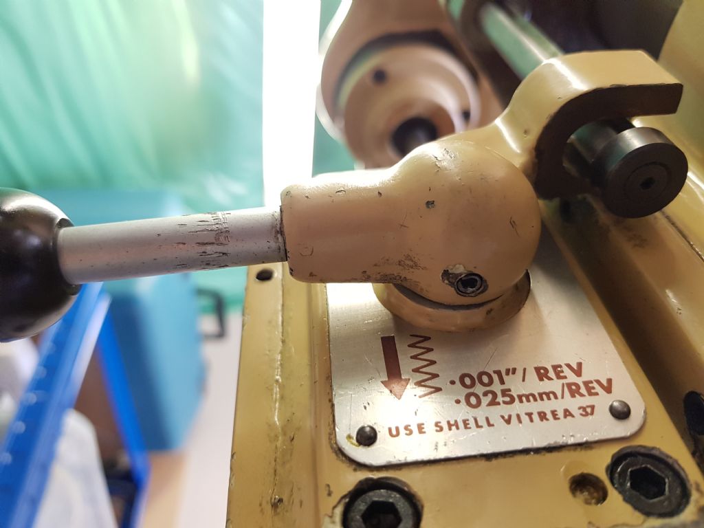

                  #414708
                  Steve Kingsley 1
                    @stevekingsley1
                    Hi Gwilym,
                    Hope this helps. Happy to take some measurements.
                    #414764
                    Gwilym Box
                      @gwilymbox37276
                      Hi Steve,
                      That's the handle assembly. I have some measurements taken from photos but it you can take them from the actual casting it would be great.
                      If you could provide some dimensions for the adjuster rod as well as mine is missing as well.
                      Thanks
                      Gwilym

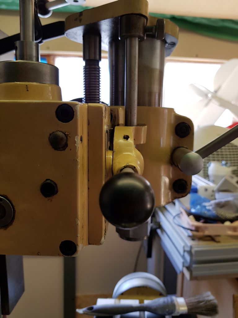

                      #415116
                      Steve Kingsley 1
                        @stevekingsley1
                        Hi Gwilym,
                        Here's a link to some more pictures. I'm on my phone at the mo so not sure how to upload to my album.
                        **LINK**
                        Cheers
                        Steve

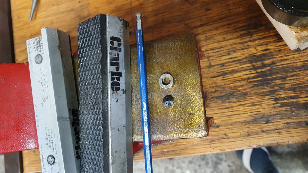

                        #415209
                        Gwilym Box
                          @gwilymbox37276
                          Steve,
                          Thanks for all the effort in documenting the handle. I'll study in detail this weekend.
                          My machine is in pieces and slowly coming back. Just bought a 10 ton press so I can change a bearing, so that will be a task for the weekend.
                          I'll mock up a part in wood to get a feel on how I'll be able to machine this.
                          Cheers
                          Gwilym

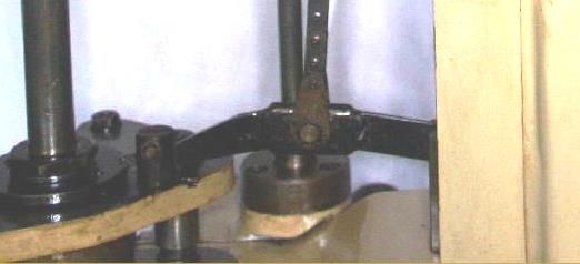

                            Hi Everyone,

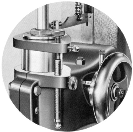

                            Not sure if this thread is still 'live' but I'm also rebuilding a Downham Mini-Jig Borer!
                            My problem is a missing support strap (not sure what it's called but I've marked it in photo 2 with a red blob).
                            What I could do with is a scale drawing (or tracing from the part) so that I could make up a new one from a bit of scrap plate.
                            Thanks
                            Zeek

                                Newbie error! 'Thought they were JPEGs – they were GIFs … Let's try again;
                                (my thanks to lathes.co.uk).
                                To reiterate, my problem is a missing support strap (not sure what it's called but I've marked it in photo 2 with a red blob).
                                What I could do with is a scale drawing (or tracing from the part) to get the dimensions, so that I could make up a new one from a bit of scrap plate.
                                Thanks again, Zeek.

                                    #545666
                                    Zeek
                                      @zeek
                                      *UPDATE*
                                      Hi Steve,
                                      Gwilym been brilliant! He's posted the necessary info. in response to another thread I also posted on.
                                      You guys are great, none of the 'we're the establishment – who are you talking to' you get on other forums.
                                      Thanks again, Zeek.

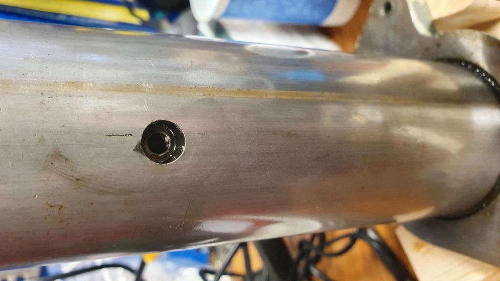

                                            Hi Guys,
                                            I'm still restoring my borer, but have one small issue.
                                            The oiling point on the quik has got some unusual (at least for me…) oiler – it is just a couple of slit rubber/plastic membranes held my some sort of washer push fitted into the hole on the quill – sory for amateurish termonilogy.
                                            Mine one is broke – do you know where I could get replacement parts?
                                            I have created an "Elliot jig borer" album if you want to have a look – I'm struggling to insert photos from there in here…
                                            Cheers,
                                            Martin
