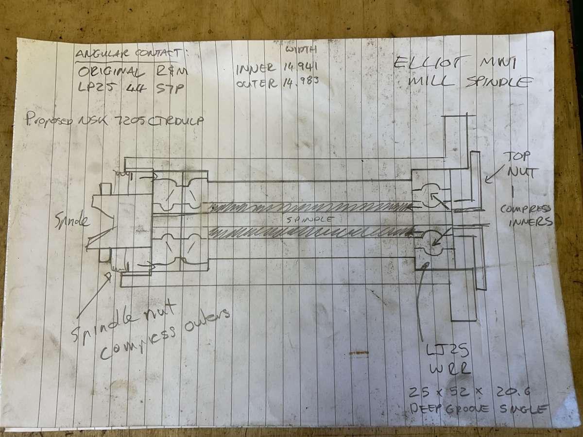

                Regarding preload:

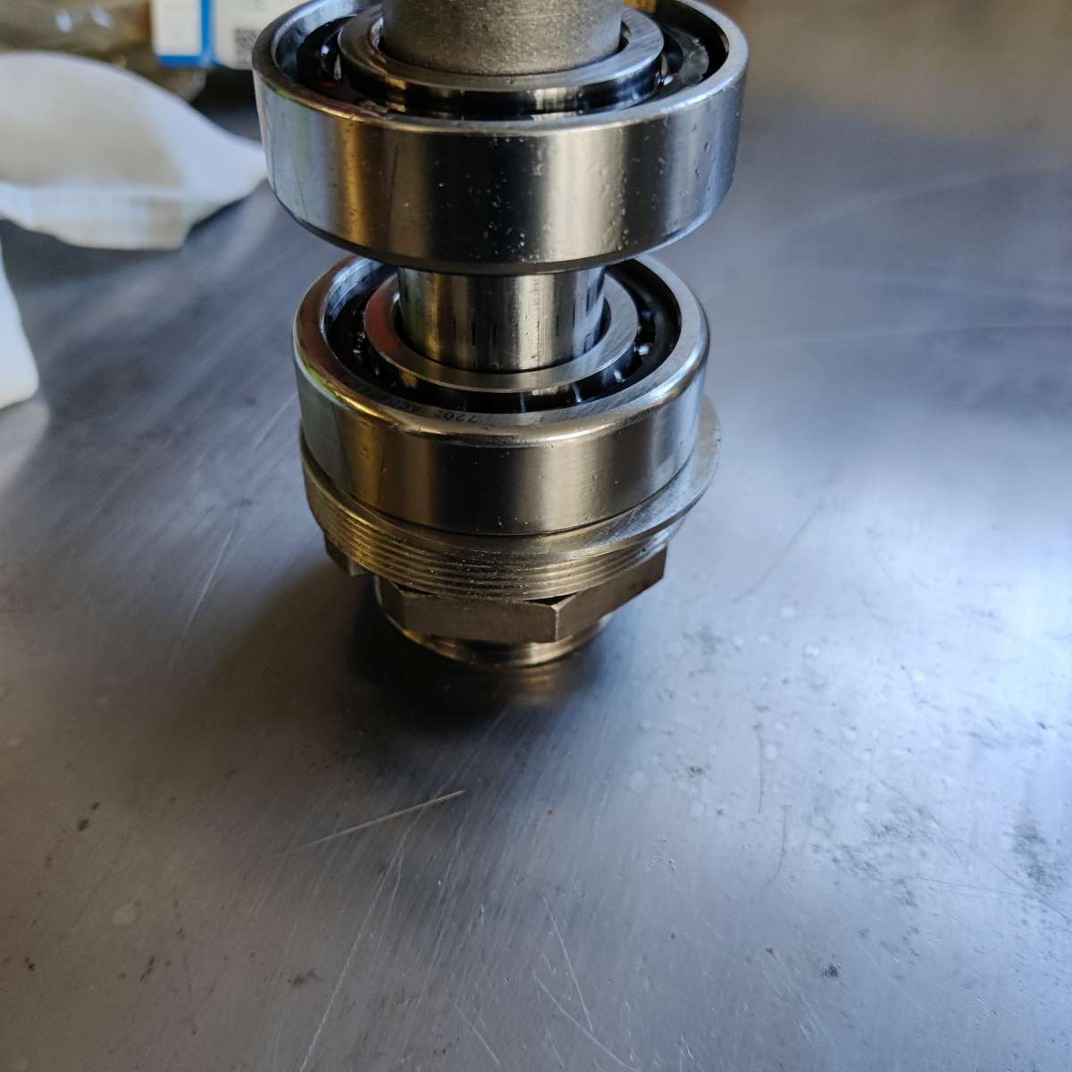

                – The preload is applied by the axial clearance between the bearing pair inner and outer races. pushing the inner races together axially clamps the outers together. There are no spring washers in the system.
                – To assess this I made a mandrel with a clearance to the inner races. Then compressed the inner races of old and new bearings (unmatched 7205). There is no discernable difference in resistance when rotating the outer races. I was also able to rotate the outer races independently with a strong hand grip.
                IMG_0755

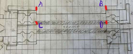

                – The lower bearing pair is pushed up into the quill with the lower spindle bearing nut. This is how the spindle is located in Z in the quill. Here is a very basic sketch of how it looks and how I think the force path runs through the system. The top bearing inner race is pulled down by the upper nut. This compresses all inner races. I suspect the top bearing outer race is floating in Z and not pushed fully into the quill rebate as my sketch suggests.
                IMG_0185
                – All the info I found on forums suggest that some preload is required and that unmatched pairs have to be shimmed if used in a back to back arrangement. I will follow this suggestion. I have found some 0.01mm 304 shim stock and will try to fabricate a shim for the outer races and try this on the mandrel first before I re assemble.

                  Ivan, thanks for making the sketch which helps a lot.
                  Regarding the pair on the left, if you can rotate the outers relative to each other after clamping the inners tightly, then there is no preload in the unit.  As you suggest shims between the outers will create this. You should aim to get the unit about 10microns tight, so depending on how much clearance you actually have, you may need need one or several shims. The normal way to decide the correct shim thickness would be to measure the end-float and add shims to that value, PLUS 10 microns.
                  The problem with putting shims between the outer is that they are not very flat and this will make the process of determining/adjusting the preload a little hit and miss. Another and hopefully more accurate way to adjust the unit would be to disassemble one or both ACs and rub the appropriate inner-ring faces on a surface plate with fine carbide paper on it. A micrometer will tell you how much material you have removed.
                  Regarding the single bearing at the other end, this looks a little odd, at least as its drawn. IDEALLY there should be a light wavy washer between the outer-ring face and the housing abutment to ensure that the radial play in this bearing is removed. This would improve the rigidity of the spindle a little, but you could get away without it. Without a wavy washer though, the abutment face should be clear of the outer ring face. If its not, the uncontrolled face-protrusions on this bearing could, if you are unlucky, interfere with the preloading of the pair at the other end.

                    Preload AC bearings in the spindle nose. (LH side of sketch)
                    – There is some preload when mounting the bearings on the test mandrel.
                    – You have to grip the outers very firmly to be able to rotate them independently. The amount of force required felt similar between the old and new pair. I was surprised by this as the width of the inner and outer race of one of the new bearings measured the same.
                    – Before attempting the shim between the outer races today I measured both new bearings and found that the inner race is 0.06mm narrower than the inner on the other bearing. The bearings doesn’t look like they are from the same supplier.
                    – I plan to mount them, without a shim, despite them being from different suppliers.

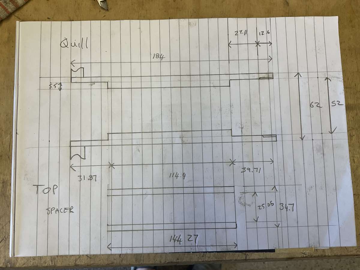

                    – I did not consider that this bearing should also have some axial pre load that could be provided with a wavy washer, thanks for explaining that. There was none present when stripping the spindle. I assumed the bearing was floating in Z and not making contact to the abutment in the quill.
                    – I measured the quill and the spacer that is fitted between the upper and lower bearings. The distance between the abutments in the quill is 0.2mm larger than the length of the spacer. here is a new sketch. The top bearing is on the LH side in this case. I should have drawn it in the same orientation as sketch 1. Hindsight is 20/20.
                    IMG_0208
                    – This means the both the outer races on both the bottom and top bearings are making contact with the abutments. This will place significant axial preload on the top bearing. Could it be that this is designed to stretch the spindle?
                    I could fit it back as is or introduce another spacer to enable a wavy washer to be fitted under the top bearing.

                      I’m not clear on your measurements here. You give 114.4 and 144.27 but say the difference is 0.2 Am I misunderstanding something? Should 114.4 be 144.4 ? If so this would be a difference of 0.13 rather than 0.2  If the diff. is 0.13, this is still very high and with the long spacer being shorter than the outer abutment span this would be bad. Can you clarify A-B and  C-D.
                      Screenshot 2024-08-16 001513

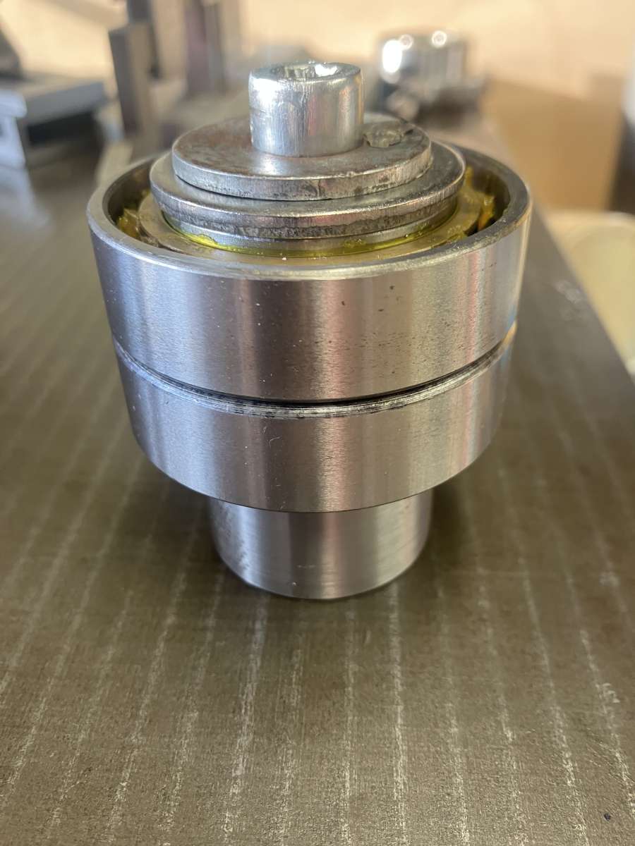

                        – I used a m8 cap screw and tightened it with a 150mm hex key as hard as I could. It was very tight. I used a 2mm mild steel washer to compress the inners and it dished. I will turn a thicker washer, get a high tensile bolt and test again on the old pair using a torque wrench to see at which torque  the outers stop rotating.
                        – When I extracted the original bearings the lower outer race disengaged from the inner and the balls spilled out. I have read that disengaging is not good for them so I will experiment on the original pair before doing a partial build with the new set.
                        – I’m waiting for the oil seal to be delivered before it try the build up. The final decision I have to make is whether to shim the outer races by 0.01 or to fit them as is.

                        I made a mistake on the sketch and measured again. Measurements were taken with a digital calliper.
                        – Abutment faces AB 114.42mm
                        – Spacer length CD 114.27mm
                        The spacer is 0.15mm shorter than the distance between the abutment faces. Thanks for your advice that this in not good. I  will address this by adding an additional spacer washer and then pre loading the bearing with a W61580 wave spring washer.
                        The spec for the wave spring washer is 0.56mm thick and loaded height 1.75mm. The additional spacer should therefore be at lest 1.6mm thick to prevent load onto the lower pair. Is this correct?

                          Single bearing.
                          This bearing should ideally be given an axial load from the wavey washer of around 5~10% of its Cor catalogue rating. (This is not super critical though if you are a little higher or lower.) So the dimensioning of the abutments will depend on the stiffness characteristics of your selected wavey washer. If this guideline axial load is achieved when the wavey spring is compressed to 1.75mm, then your shaft-spacer washer should be: 1.5mm + 1.75mm=3.25mm thick. (The 1.5 brings the inner and outer abutments into line. The 1.75 creates the gap between the outer ring face of the bearing and its adjacent abutment, to achieve the correct squash of the spring. Does this make sense ?).
                          Regarding this shaft spacing washer, it must be flat and even. Give it a good rub on carbide paper on a surface plate to get it flat and check the thickness variation with your micrometer. Aim for about 5 microns or less variation, if you can.

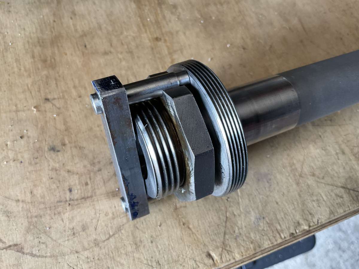

                                  The top nut compresses the inner bearings and spacer together to provide the preload. It was not very tight when I stripped the spindle. My home made pin wrench has a 300mm long handle. I plan to apply about 10kg at 300mm and check runout. This is the final step of assembling the spindle so I can then increase torque if i see runout or reduce it if the spindle is running hot.
                                  IMG_0261
                                  The bottom nut compresses the outer races of the AC bearings into the quill. You will know when it’s tight as there is nothing to stretch. I made a pin adapter that passes through the half moons in the spindle nut. I can then use the spindle spanner to rotate the spindle which will screw the nut into the quill. This sets the bearings.
                                  IMG_0260

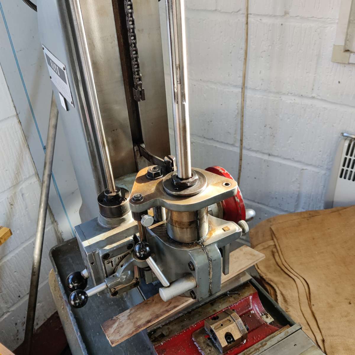

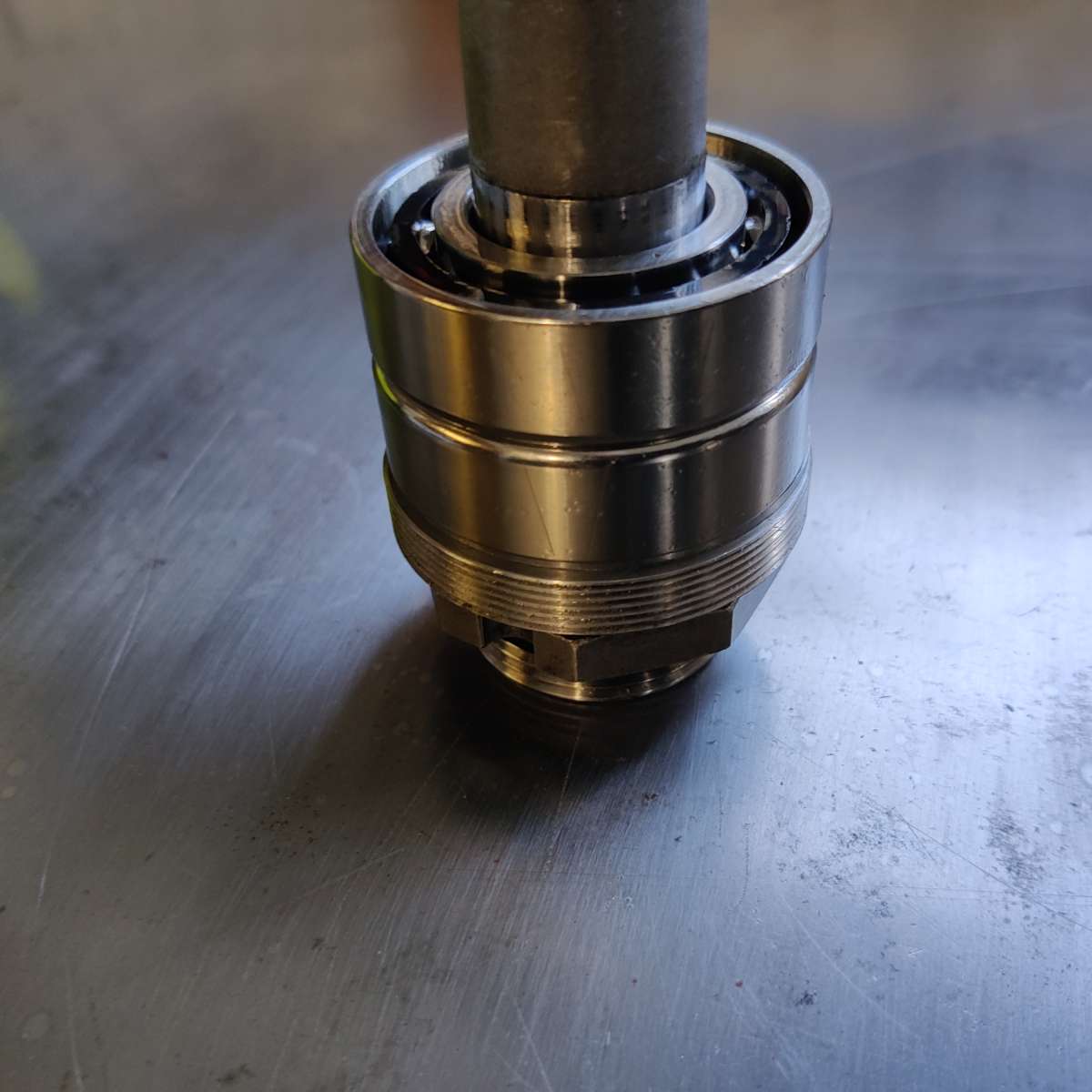

                                      I’ve had my Gate mini jig borer for almost 30 years and it has worked perfectly until January this year. I was countersinking a hole in mild steel without downfeed engaged, when the machine ground to a screeching stop.
                                      The bottom nut had wound down and jammed against the chuck nut.
                                      I ended up removing the spindle, to find that the lower bearings appeared to be in perfectly good order. At least one did. The other separated and scattered its contents.

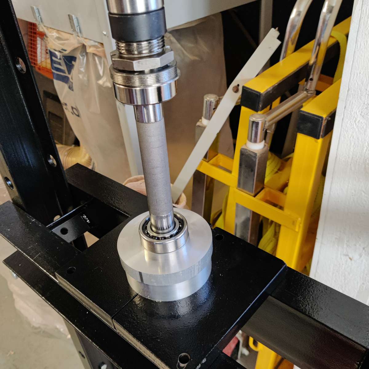

                                      I bought a pair of SKF 7205 ACD/P4ADBB bearings and have just put the spindle back together. Ivan asked if I would share my method of assembling the spindle, so here it is.
                                      Trying to be as “clinically clean” as possible.
                                      After pressing the bearings onto the shaft, i fitted the top nut back on the quill as a guide, and the bearings went into the housing as a push fit. I screwed in the bottom nut using a tool similar to Ivan’s to tighten up.
                                      The spacer tube went in next, followed by the top sealed bearing and top nut.

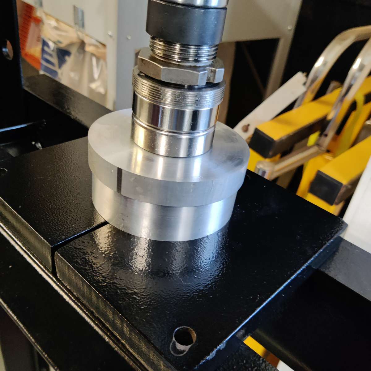

                                      I’ve started to reassemble the machine, but at the moment am stuck trying to get the T-nut slot into its groove on the vertical slide. IMG_20241027_113749

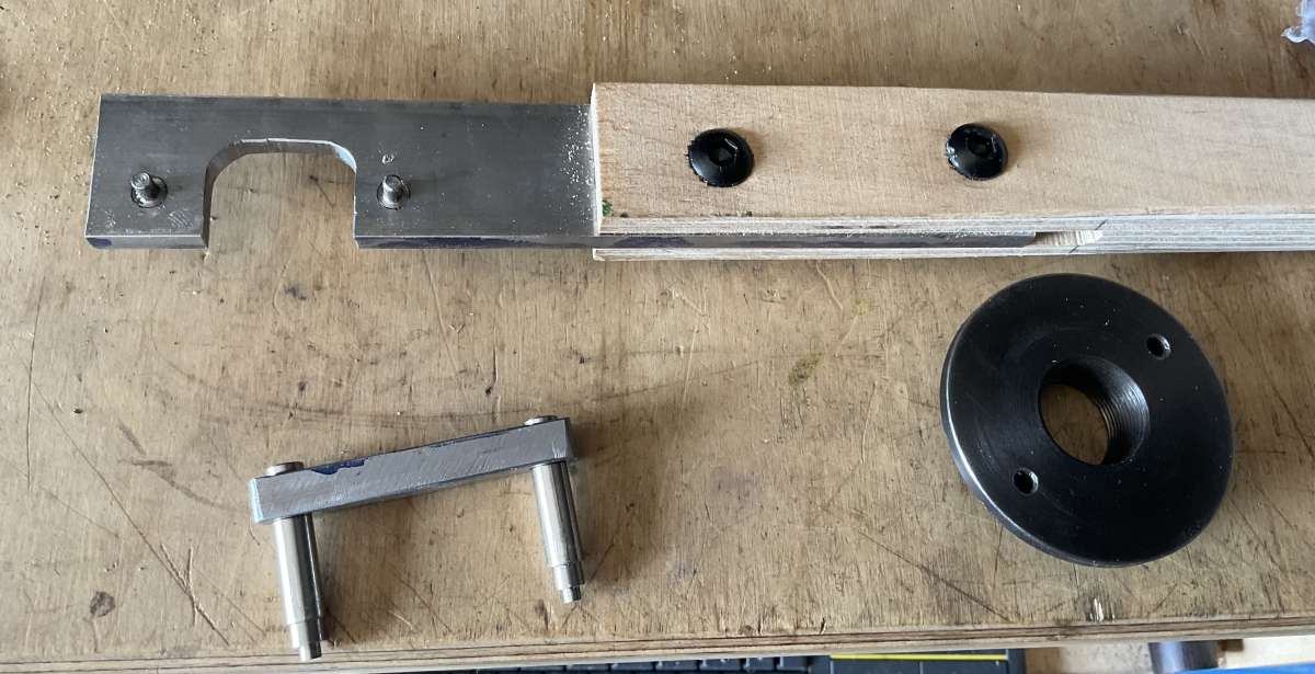

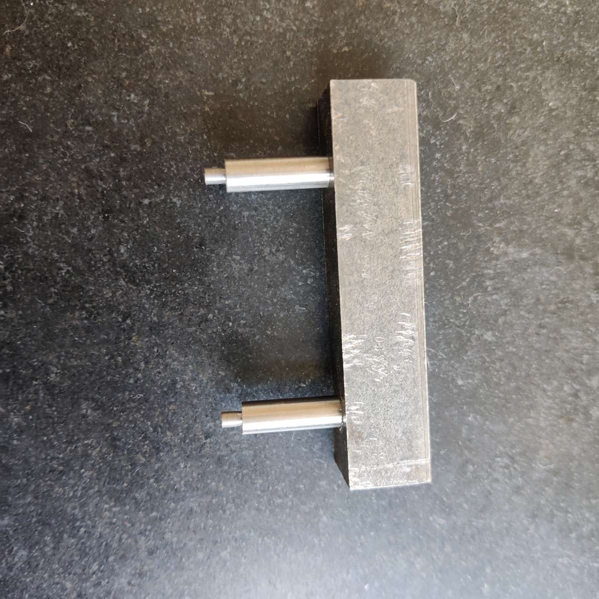

                                      I had problems initially with pressing the oil seal into the bottom nut. i made a couple of different guides, neither of which worked, and ended up putting the nut flat on the press on a piece of gauge plate, and pressing it in with the ram. That worked.
                                      I turned up a lump of aluminium I had, through which I could poke the spindle, and placed it on a small press
                                      IMG_20241025_143310IMG_20241025_143728IMG_20241025_144036IMG_20241025_144151IMG_20241026_130906
