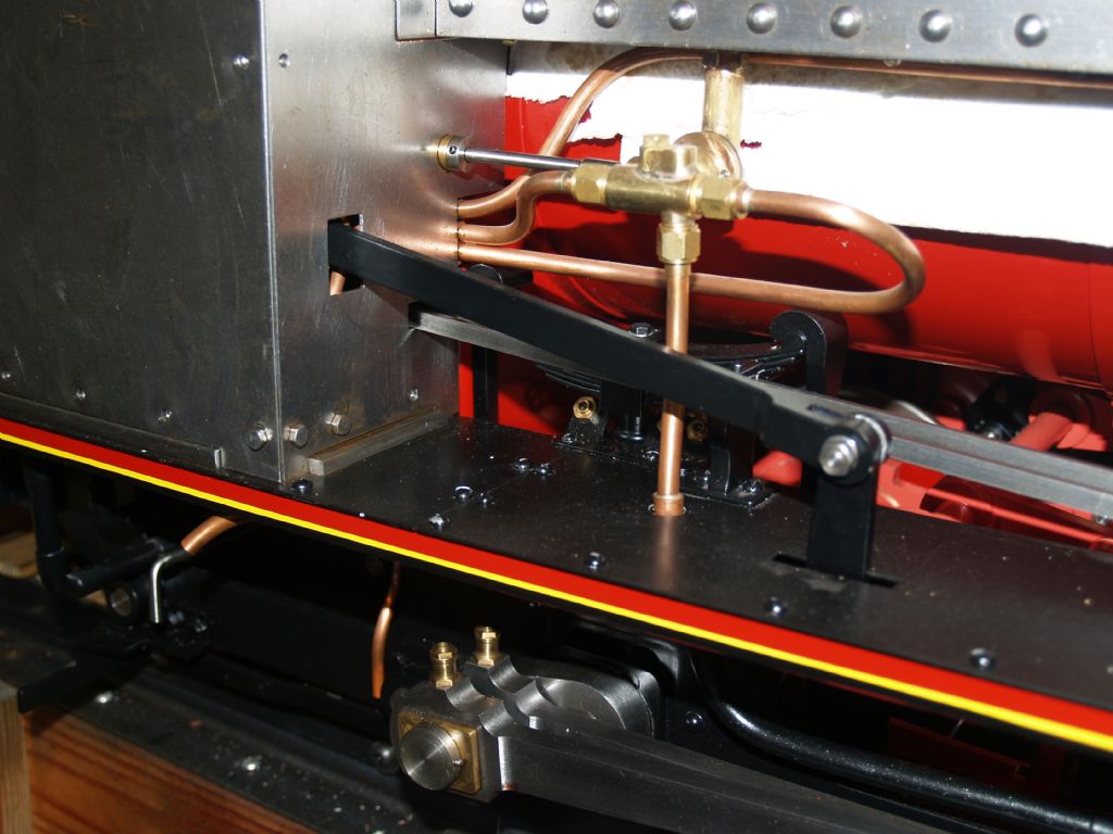

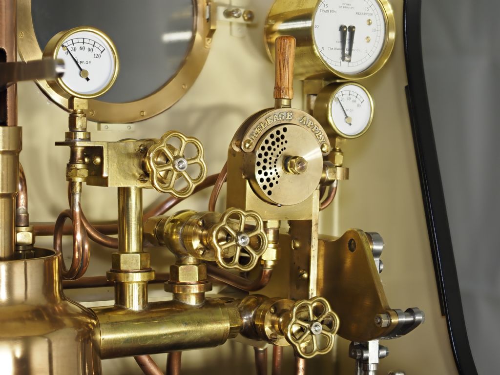

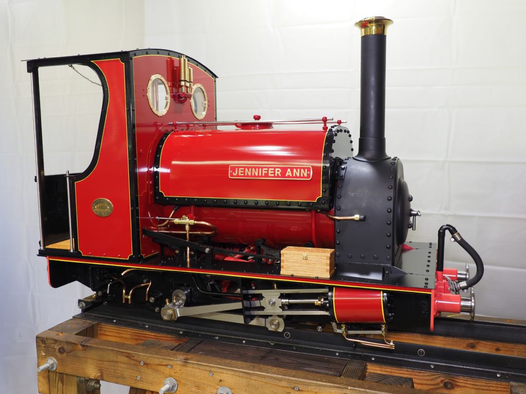

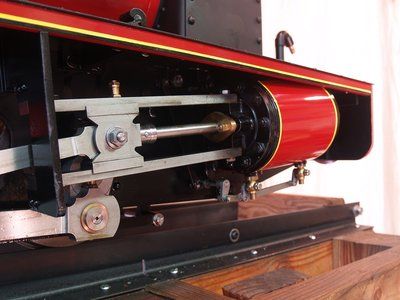

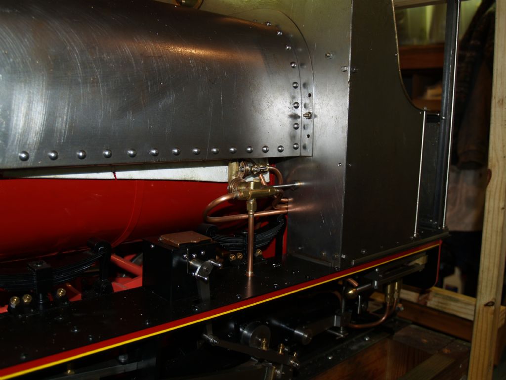

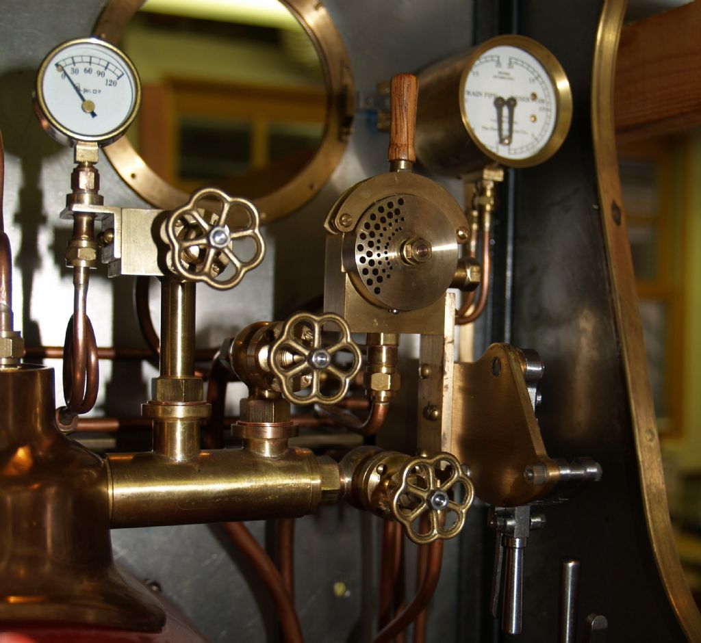

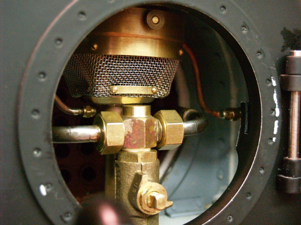

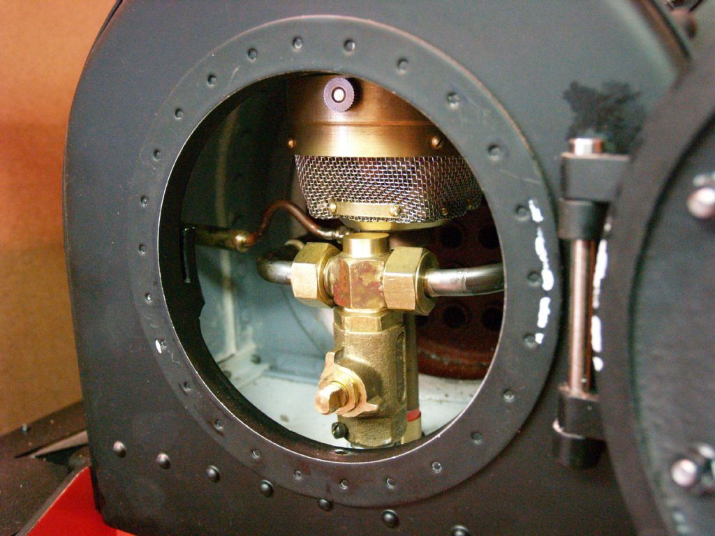

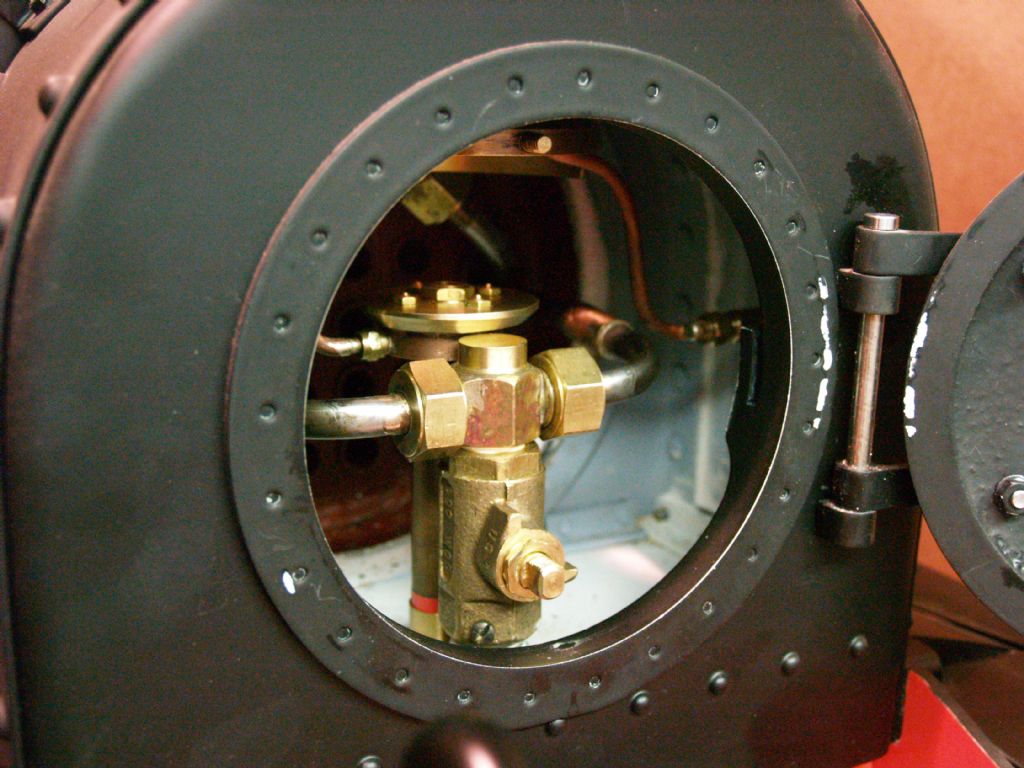

      Hi all,

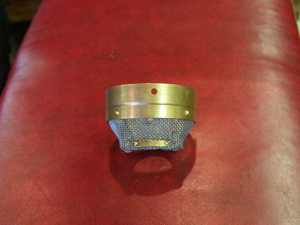

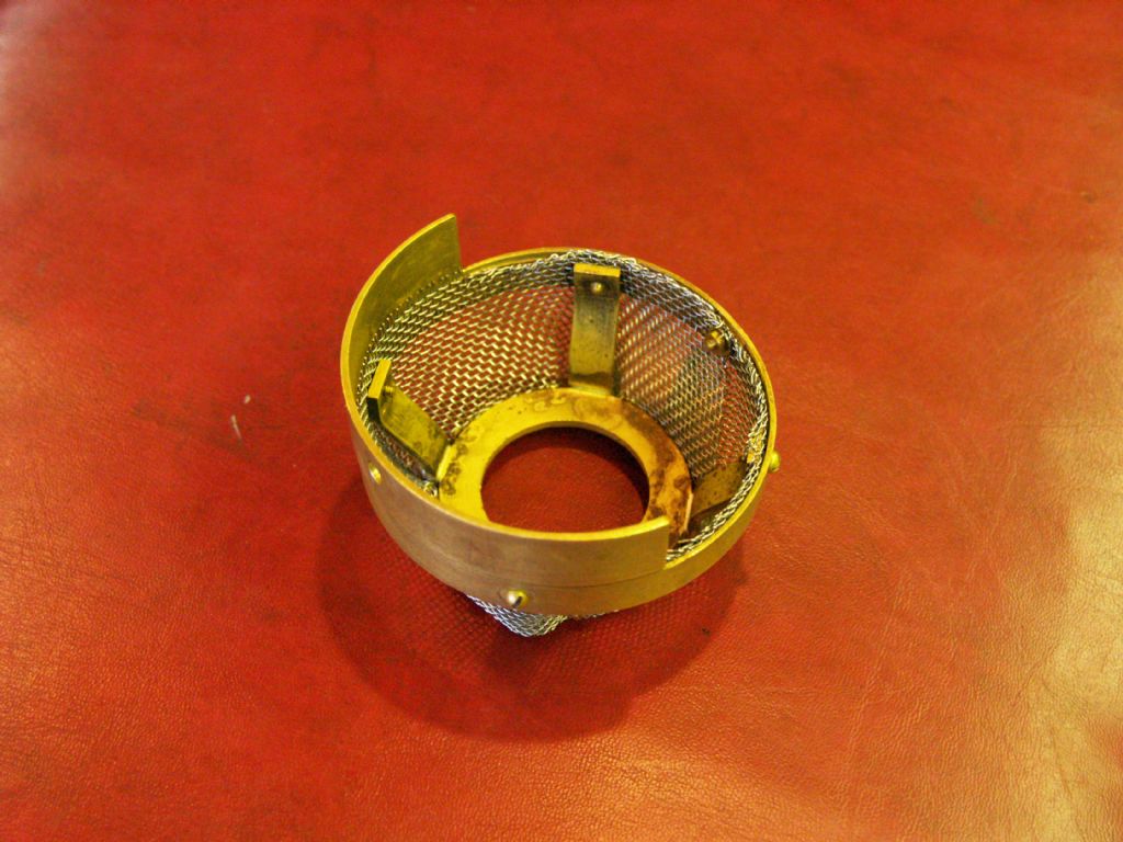

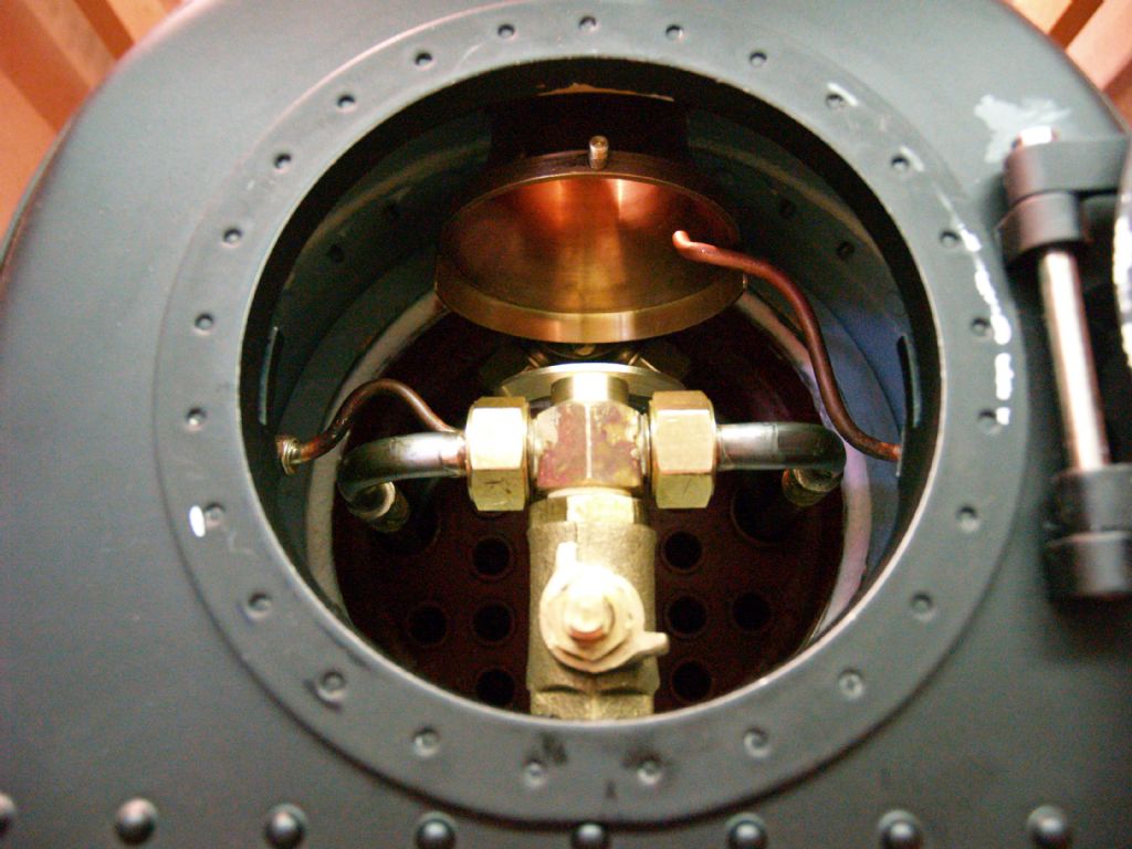

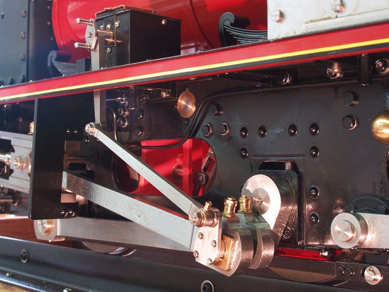

      Thought I'd add some pictures of my 3 inch scale Hunslet (Reeves "Elidir" ), under construction now for over 30 years and finally nearing completion. The loco has been built using a George Adams round-bed lathe circa 1905 vintage, a pillar drill, and hand tools – no milling machine.

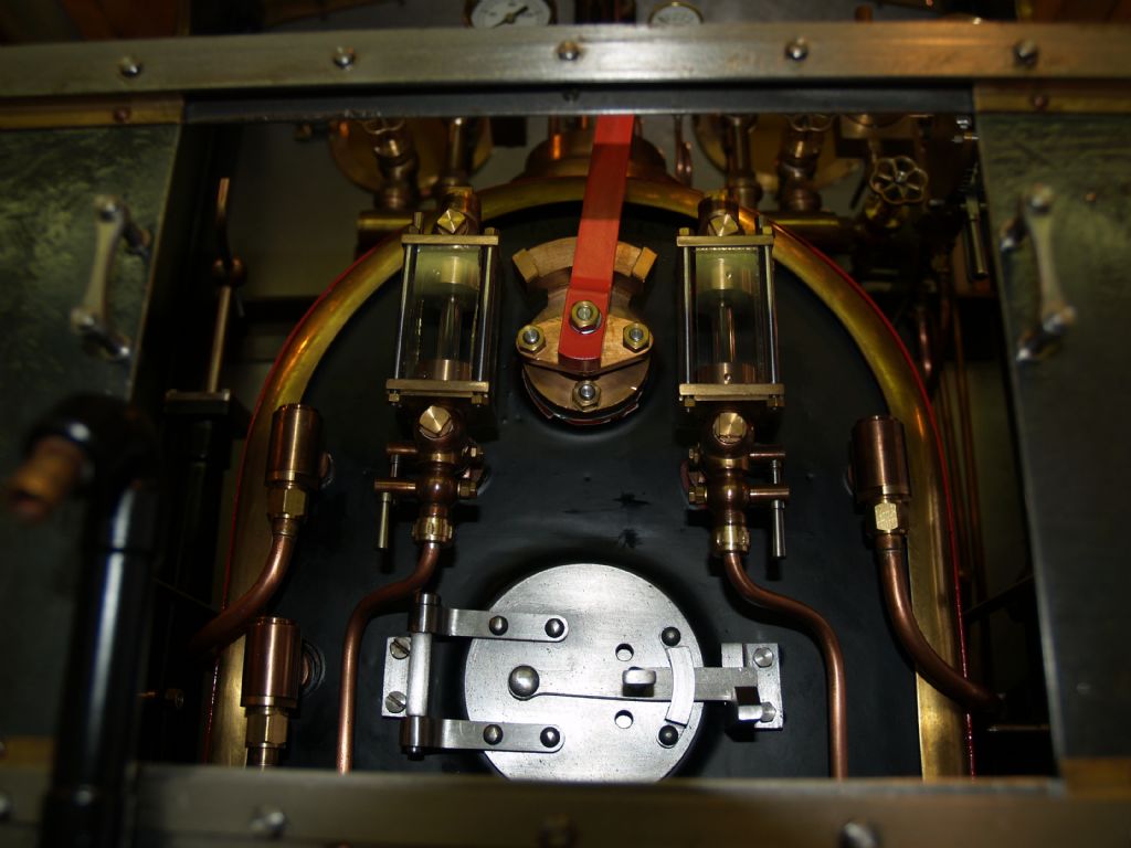

      The pictures of the spark arrestor may be of interest to some – it's held in place with a single knurled nut at the base of the petticoat pipe and can be quickly removed for cleaning.
      The injectors are essentially to the DAG Brown design but mounted in a modified body.
      Best regards to all,
      Steve

        #335900
        Another JohnS
          @anotherjohns
          Very impressive!
          Question: What else is happening in the smokebox, with the cast valve, and the superheaters?

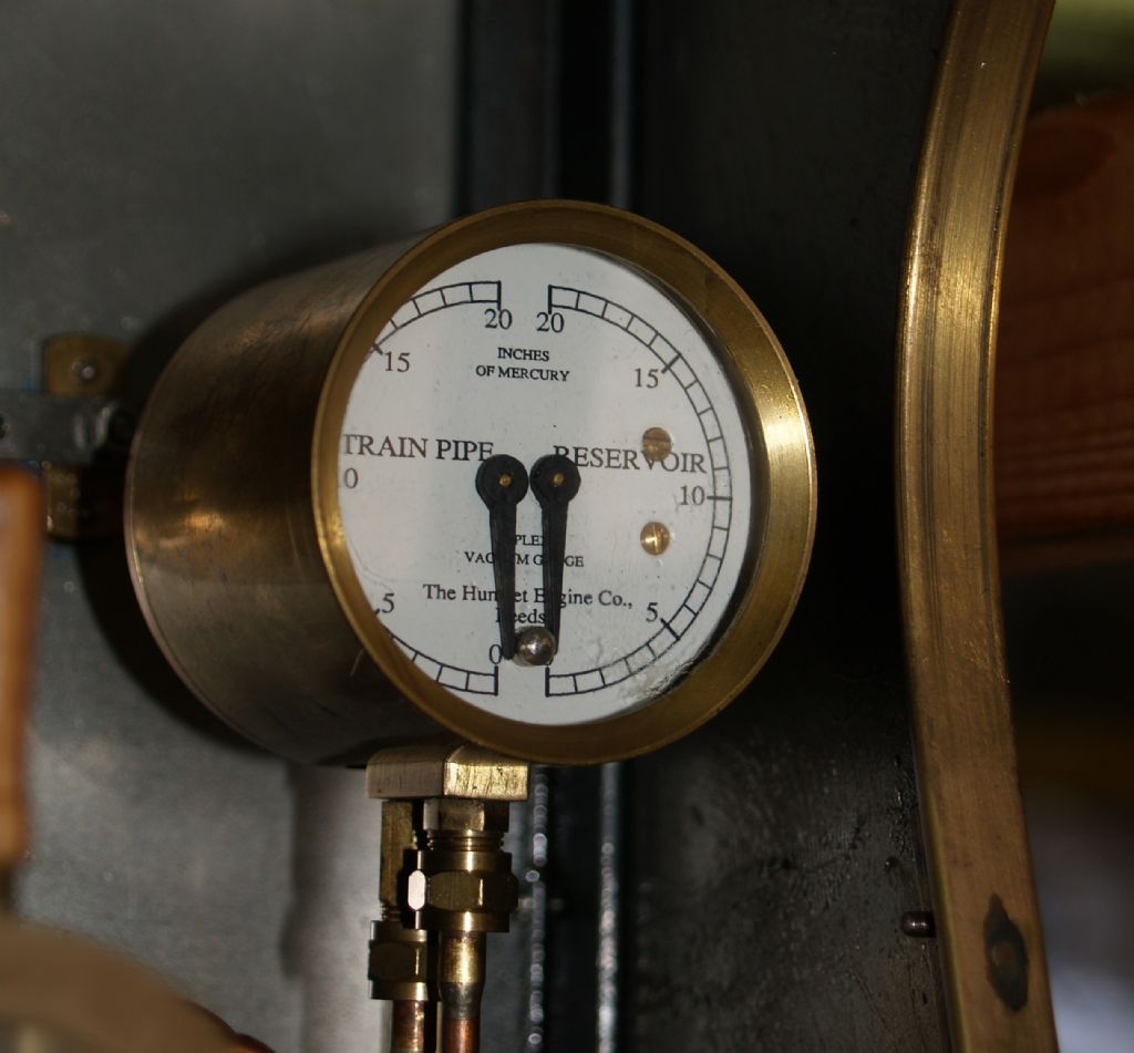

          #335908
          Clive Brown 1
            @clivebrown1
            Yes, really good. Proves that a workshop full of the latest technology isn't essential.
            If I can be allowed just one question, among many that spring to mind; how did you get the bespoke vacuum gauge?

                  stephen goodbody
                    @stephengoodbody77352
                    John and Clive – in quick answer to your questions:
                    John, I configured the smokebox piping to bring the main steampipe in front of the blast pipe (the original design has it the other way around). This allowed me to install this hidden (but easily accessible) commercial ball valve for the purposes of pressure testing, avoiding the need to rely on the regulator as the primary shutoff during testing.
                    Clive, the duplex vacuum gauge is home-made. I used the two smallest commercial vacuum gauges I could find, stripped them down and mounted them back-to-back and offset to left and right, extended a spindle forwards from the rear gauge, and mounted the assembly in a case. The gauge face is a transparent water-slide transfer on a white-painted bronze disc.
                    EGA – that's correct, Tony asked me to provide pictures of the lathe a few years ago, the pictures and info are at http://lathes.co.uk/georgeadamsroundbed/
                    Best regards
                    Steve

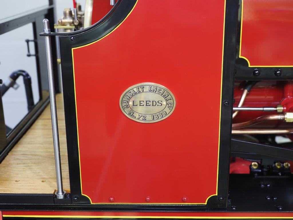

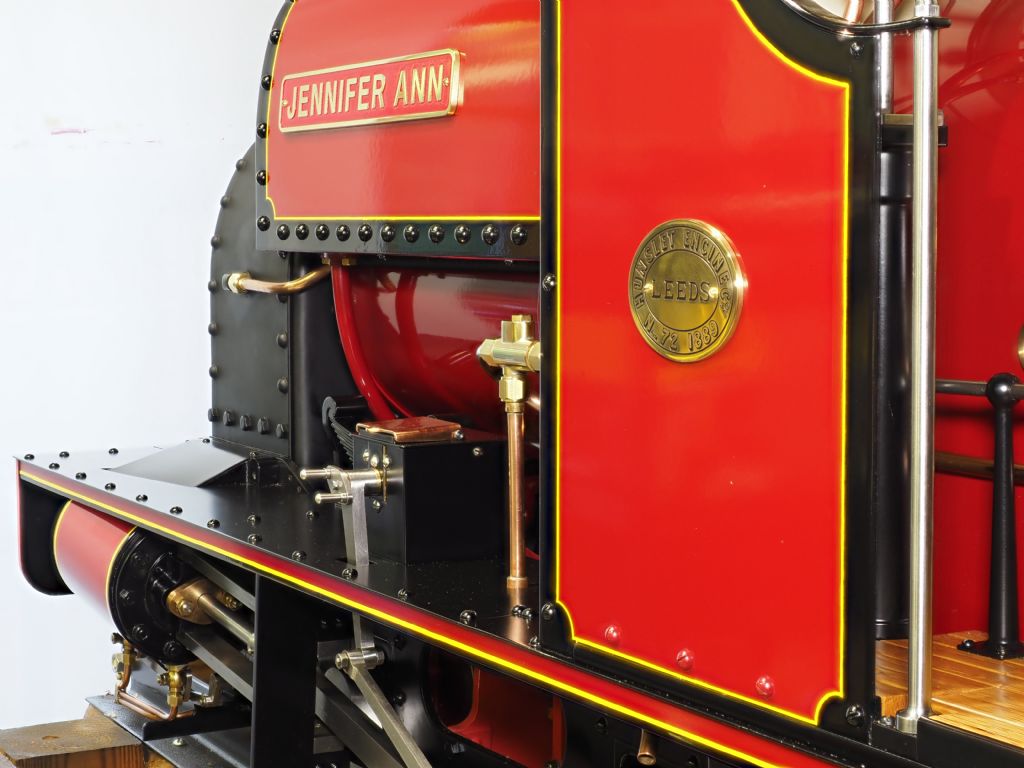

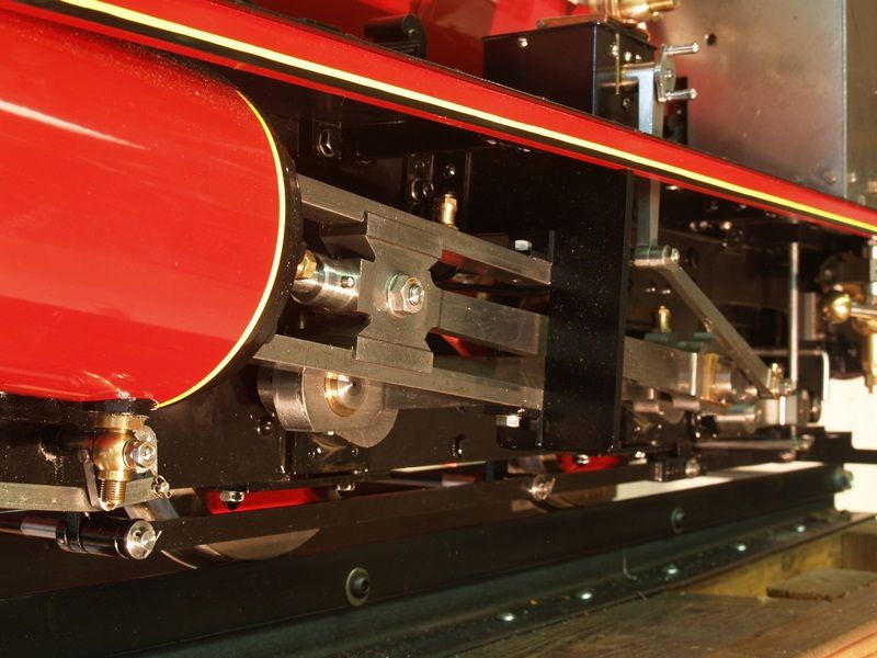

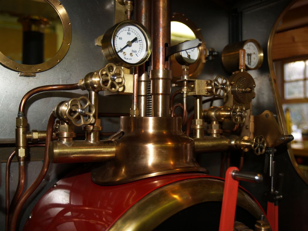

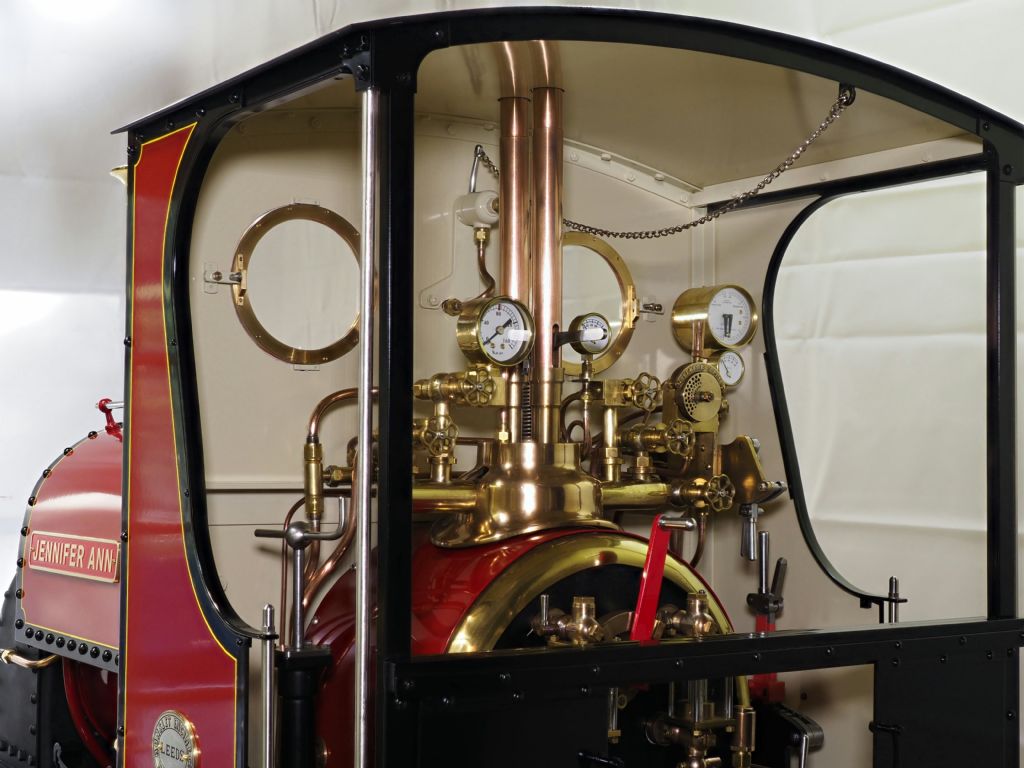

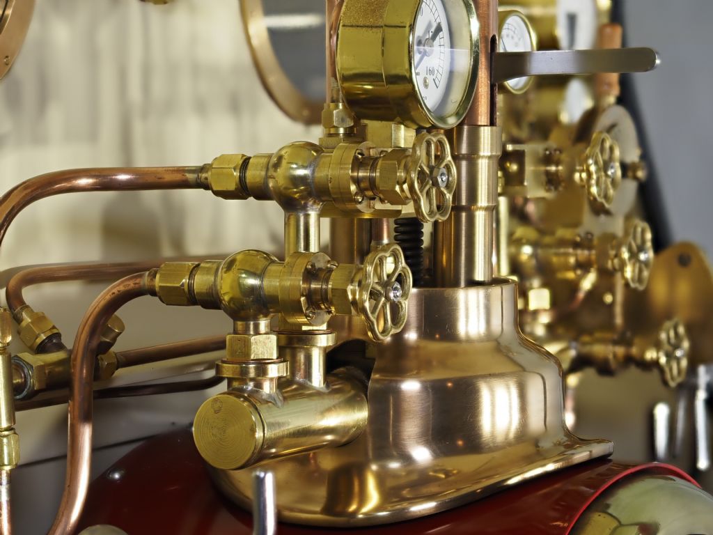

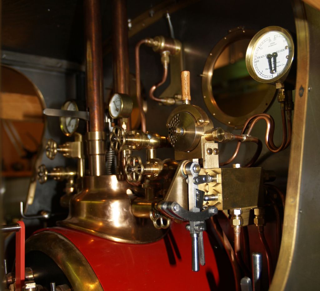

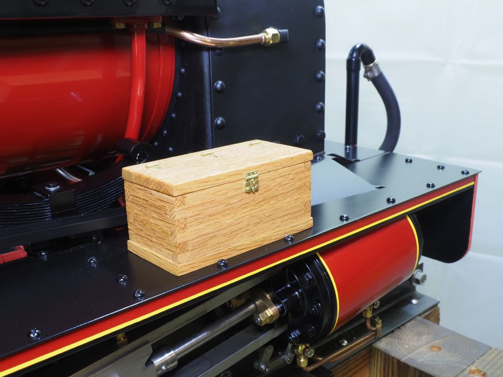

                      Hi all,
                      This weekend saw the engine fully back together having spent the past ten months in painting and reassembly. Here are a few pictures before the paintwork gets dirty!
                      Best regards,
                      Steve

                          Paul Kemp
                            @paulkemp46892
                            Steve,
                            Lovely work, you should be rightly proud of that. Is that a combination brake set up you have there (steam on the loco and vacuum for the train)? I started a 5" gauge version a few years back but got distracted by a 4" and now a 6" scale TE! As soon as the big one is done I want to get back to the Hunslet! I love the look of these loco's ever since seeing one in Wales as a child!
                            well done, cracking job.
                            Paul.
                            #499893
                            stephen goodbody
                              Many thanks all.
                              Paul – the loco has both steam and vacuum brake cylinders on-board, with the vacuum brake system also extending to the train. I look forward to seeing pictures of your engines also!
                              Best regards
                              Steve
                              #499971
                              Paul Kemp
                                @paulkemp46892
                                Steve,
                                Thanks for that, neat idea to have a vacuum cylinder on the loco too, saves a combination valve! Not seen anyone make one of those in small scale successfully – hence the question.
                                Many pictures of my engines on the other site you frequent .
                                Paul.

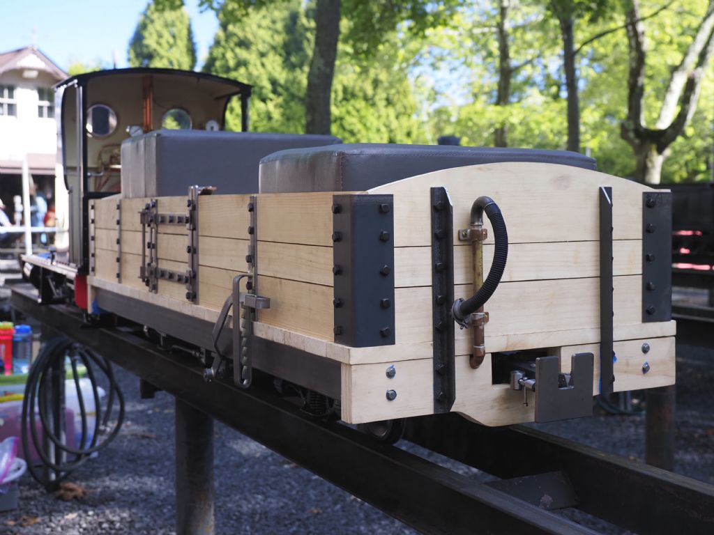

                                          stephen goodbody

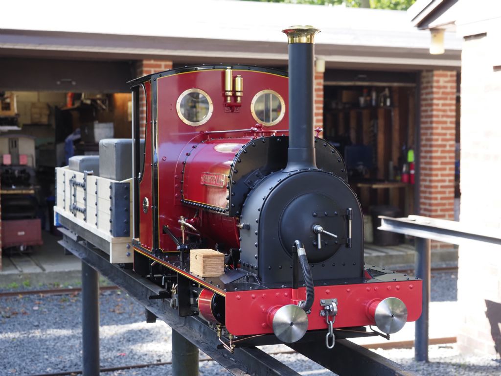

                                            After a year in the making, the first of the three Lynton and Barnstaple-based bogie wagons is finally complete to the point where I could take the loco to the track last Saturday to try everything out.
                                            This was not an unqualified success, the loco foamed and primed badly when under load, so the boiler needs a few more steamings and blowdowns before I will take it to the track again.
                                            In retrospect however the day had more successes than failures and so I'm looking forward to next spring to have another go.
                                            The rolling chassis' for the remaining two wagons are also complete, so I'm aiming to build their bodies this winter and then get everything painted and ready for next year's season.
                                            Wish me luck!
                                            Steve
                                            Edited By stephen goodbody on 01/10/2021 23:02:12
                                            #565174
                                            Brian H
                                              @brianh50089
                                              That looks really good. Well done on the detailing, and that's from someone who normally does traction engines!
                                              Brian
                                              #565183
                                              Jeff Dayman
                                                @jeffdayman43397
                                                Looking great! Good luck on the next steamings.
